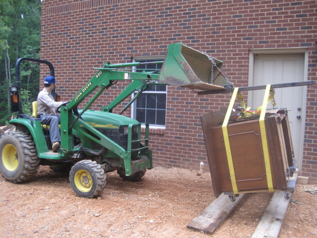

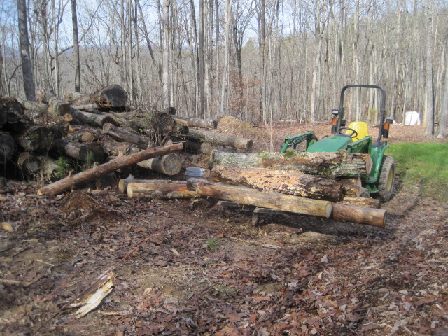

I went with the chain on type for about the same price with binders. Those in the link below look like the same ones but the price has gone up a bit. They are fantastic for moving logs and brush and I can see the tips well enough to pick up pallets.
Ebay link here: Loader Forks Bucket Forks Skid Tractor Pallet Fork | eBay
You will find them very useful.
   / Just bought these clamp on pallet forks #13

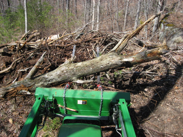

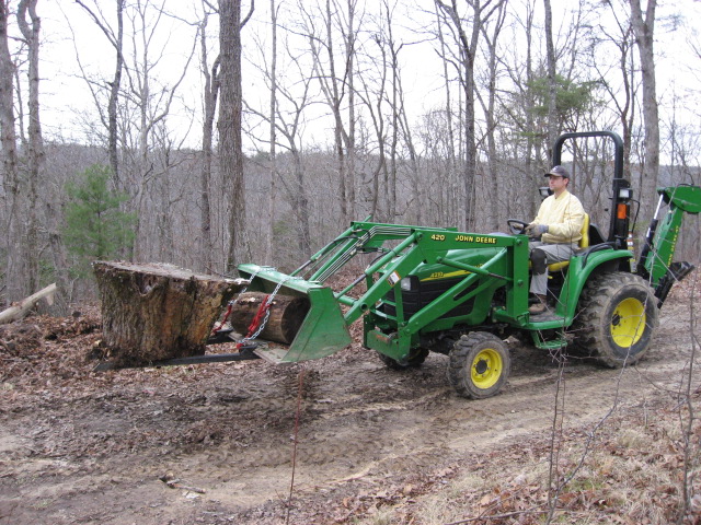

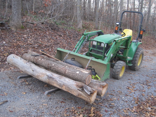

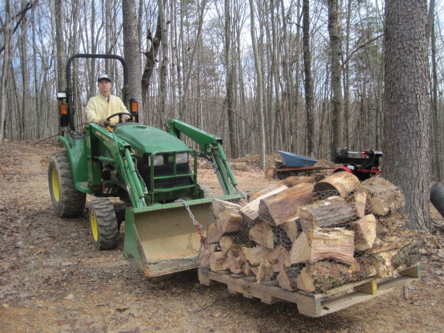

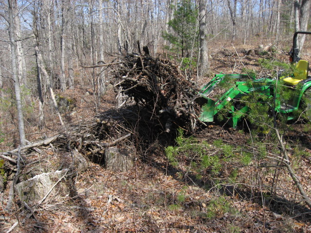

I also have the the forks that attach to the FEL by wrapping a chain around the FEL. I love them. I can carry pallets, logs, brush, trash, and other miscellaneous stuff with them. After using my pair of forks with brush, I bought a third fork to make picking up small brush easier. If you are going to move brush, I highly recommend getting 3 forks instead of two.
My chain forks can easily handle as much weight as my FEL can lift. The chain distributes the load around the bucket so I don't have to worry about bending my bucket.
