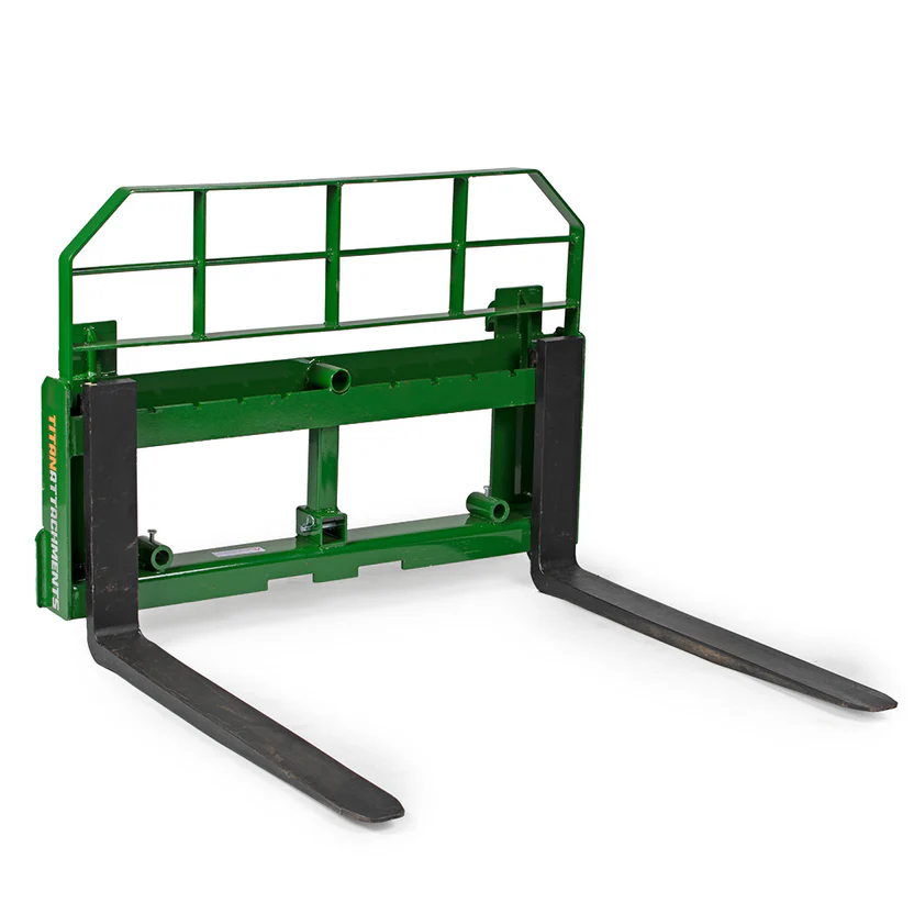

I have these from Titan, they work fine, a little heavy for the SCUT, but they have lifted everything I've put on them.
   / Clamp-on vs QA pallet forks #27
Look at Good Works Tractor versaframe. I don't have one, but considering as it has 3 point rear and ssqa fel connections to use forks on front or rear.
They are only rated for 2000 Lbs (My tractor can lift almost double that!) , by the time you take there weight of 275 Lbs, and the 134 Lb empty tote, not much room left for water ... And the tines are "imported" ...
