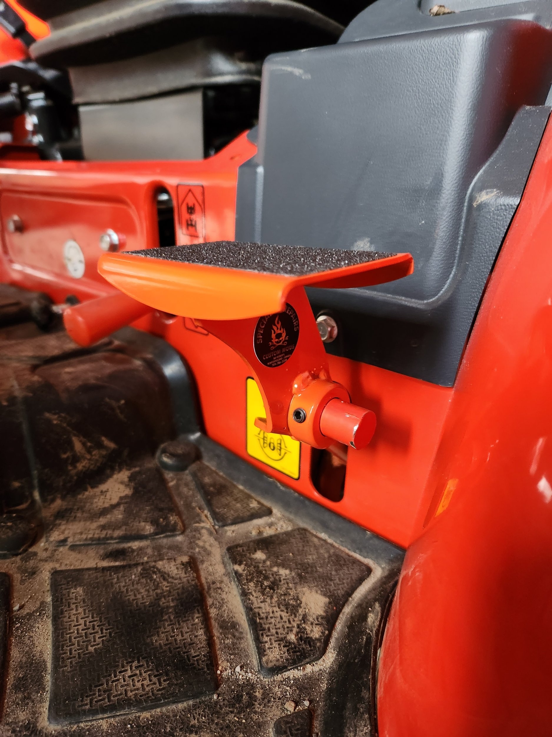

I've got to chime in here and recommend Specialty Repairs Custom Mods; they worked with me to fit some of their products for my Kioti and I've been nothing but impressed. Paul and Kathy were wonderful to work with, and I like to give them props any time I get the opportunity.
Kubota, like Deere, has a massive aftermarket with a whole lot of fun or useful items to be had.

Ill 2nd that. Have the skid plate to protect my low hanging 3rd function plumbing & the panel to cover the loader QD fittings.
