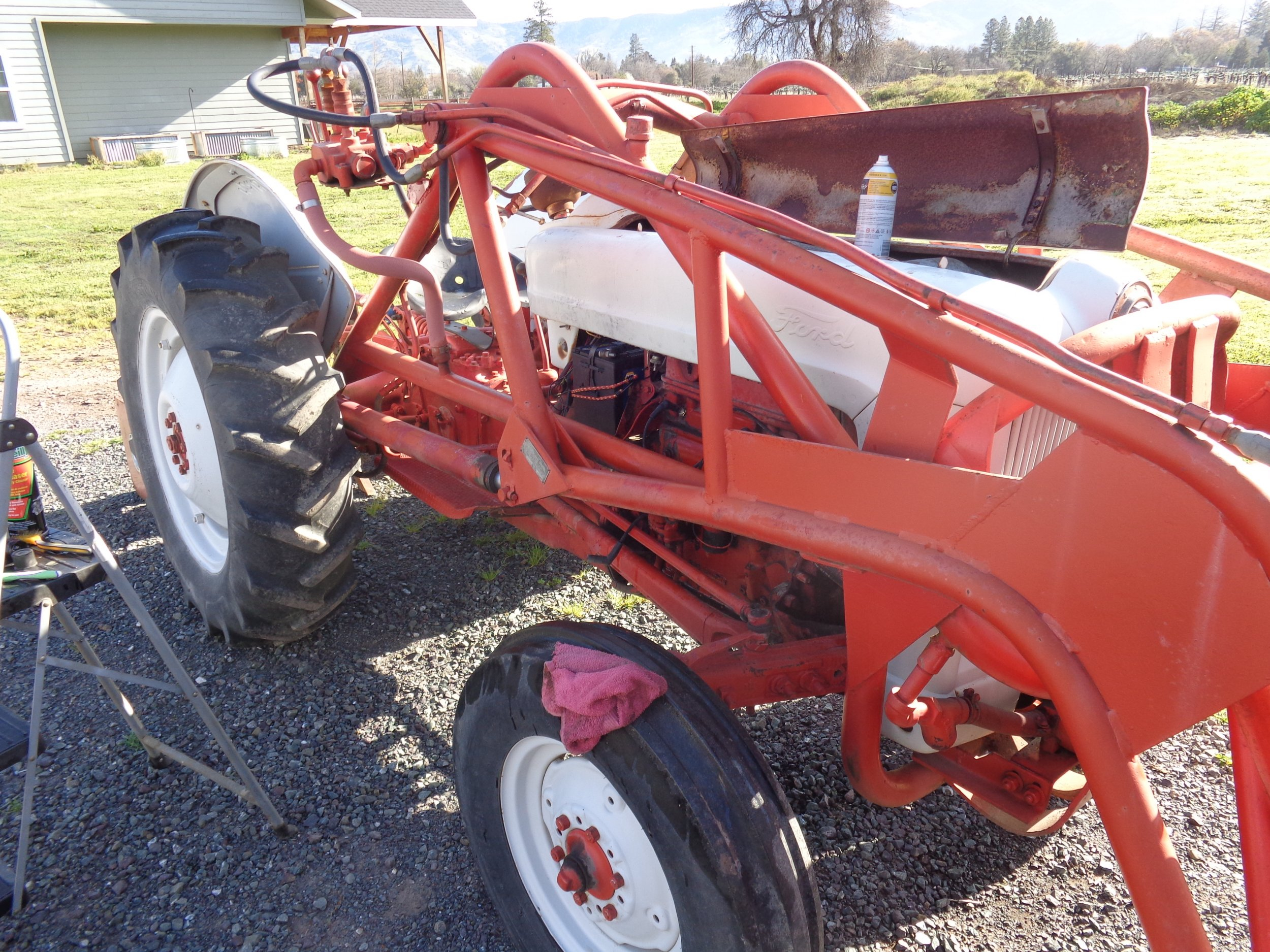

I checked tire pressures on my, new to me, Jubilee. I found the front tires have over 60 lbs pressure in them. The tires are labeled as 6.50-16 6 ply. The manual I have does not show that size tire in the recommended pressures chart. The closest the chart comes to my tires is 6.00-16 6ply. The chart recommends pressures from 20lbs to 44lbs depending on the load per wheel. My thought was to lower the pressure to 40lbs to be under the max recommendation. Does this sound right? Thanks for any input.

If you do not have a loader on this tractor, 35psi will be plenty. 45psi would be my max if you have a loader.

Chances are that your NAA had a loader on it in the past. Without power steering, you put a wider tire and pump it up to make it a little easier to steer with a full bucket. I would not run more than 28psi in them and 14psi in the rears if you don't intend to put a loader on it.

The sidewall of the tire usually gives the maximum load the tire can support and the maximum pressure which would be used to carry that load. It is not recommended that you exceed the maximum pressure. You may wish to run at or near the maximum to make steering a bit easier.

Thank all of you for the input. I should have mentioned there is a loader.

Whatever the sidewall states as max PSI is what you should use since it has a loader. No matter what since it is a NAA with a loader steering by armstrong is going to be fully present and felt.

If you're putting 60psi in those tires don't be surprised to hear an earth shattering Kaboom some day.
30-35 should be more than sufficient.
At 60 you're not only over manufacturers recommended inflation but also more likely to get a puncture.
