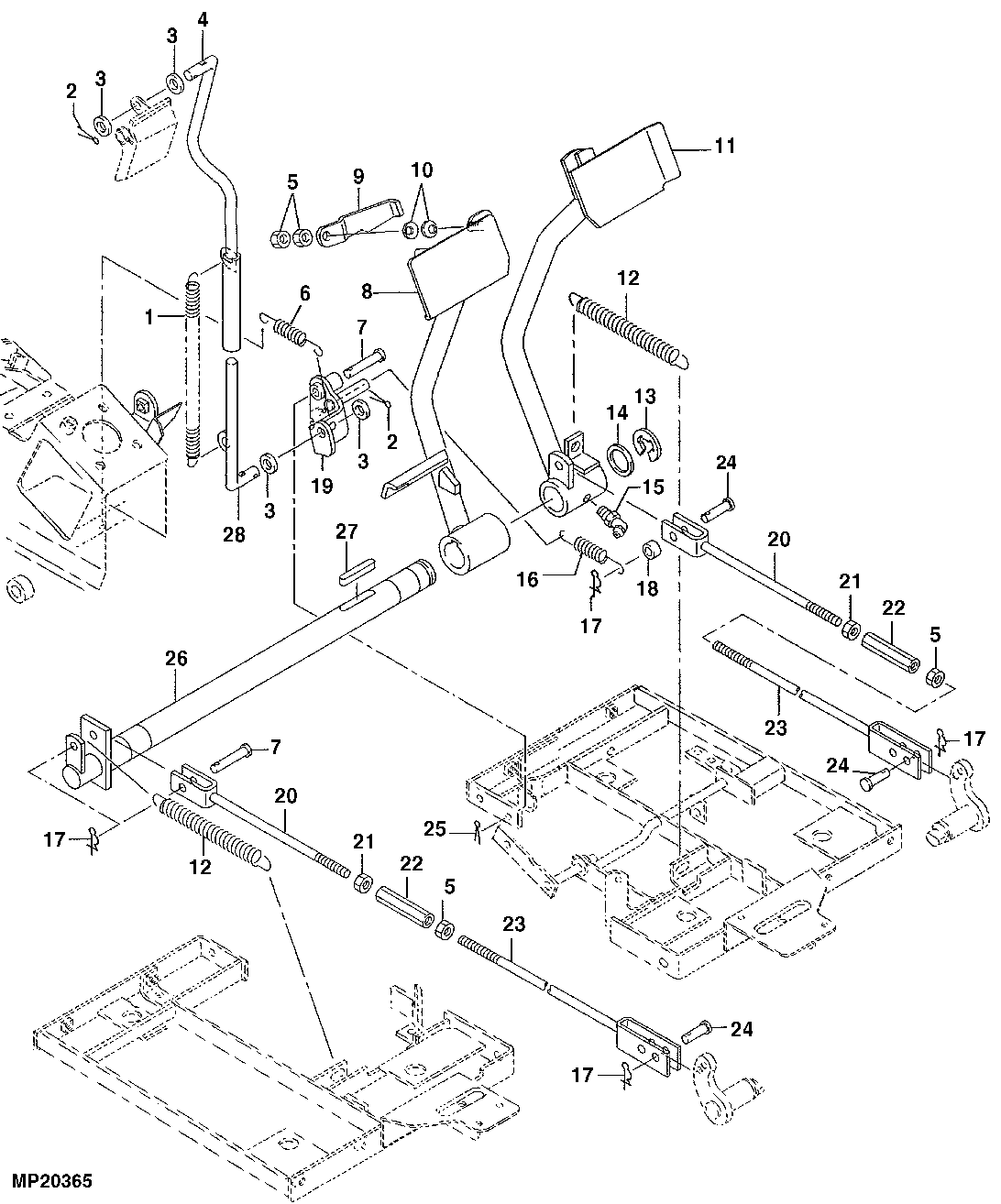

I have just purchased a 4100 from a estate sale and know nothing about it. The engine starts quickly and runs smoothly while the hydraulic lift works well but doesn't hold in the up position long. The problem is that the brakes seem to be sticking. When put in gear you can feel the strain when taking off and if you push in the clutch the tractor stops immediately as if you pushed the brake. The pedal seems to be all the way up and the parking brake seems fully disengaged. any help would be great?
/ John Deere 4100 Brakes Locked? #2
check where the brake rod arms enter the cast housing, they may be corroded/rusted and stuck in the depressed position

From viewing parts catalog brakes on 4100 appear to be mechanical operated. My vote is sticking operating linkage. Have you lubricated grease fitting(parts key 15)?

The operating shafts (one on each side) are steel going thru an aluminium housing. The aluminium builds up a bit of corrosion and the external spring will not rotate the shaft back to the off position.
Once a year I put a helper in the seat, crawl under with a hammer and spray lube. The helper pushes the pedal, I spray and tap the spring holder so it rotates back off. Push the pedal again and rotate the shaft while spraying. When one side is free, switch to the other side.
Poor design but like emergency brakes on a pickup, you either use them all the time of they will seize up.... My tractor is hydrostat so I seldom use the brakes. Then I need them to park on an incline and they don't release, or lock the brakes while its on a flatbed and have to free them up before I unload...

This parts diagram shows the internal brake view and the linkage shaft
and with the first diagram supplied by Tx Jim you can see the entire setup from pedal to friction disc
