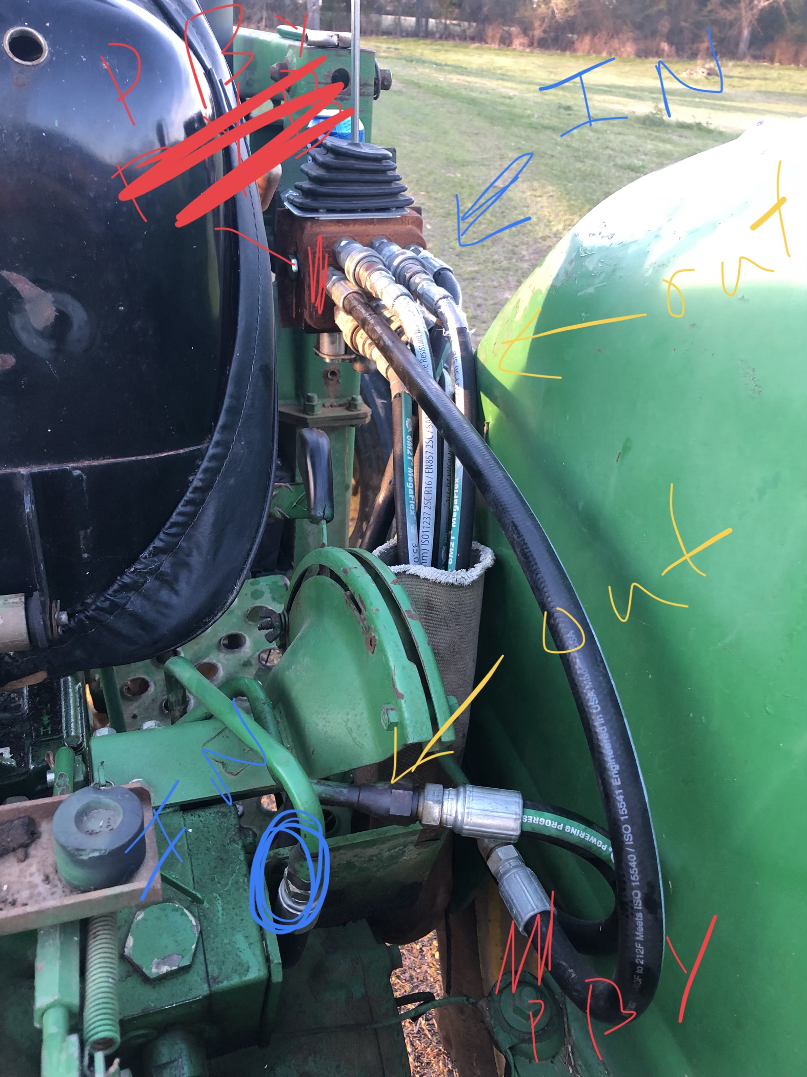

Ok so I hooked the two lines together and the 3 pt hitch works greats so what I’m thinking and tell me if I’m wrong is put a “t” in those two lines and hook it up to the in port on the joystick control valve and leave the out like it is. And plug the power beyond port. They had one line going to the in the other the out and one to the power beyond.

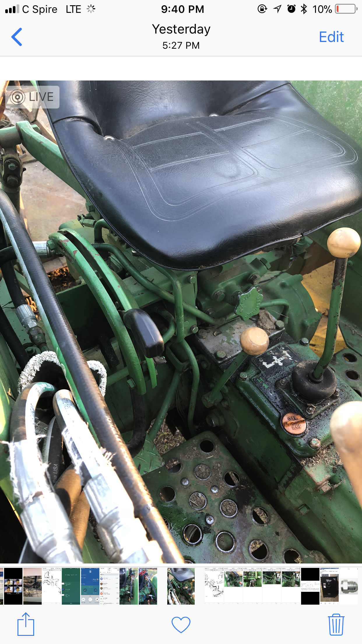

Are you controlling the lift arms and bucket using the two green arms with black knobs located beside the seat?
Seems like an unusual loader control arrangement, do you know the history of the loader install on the tractor?
This would be a more typical John Deere rear remote setup
One in and out for a snow blower chute rotator and the second to control a deflector on the end of the blower spout.
A FEL control valve would be plumbed into the hydraulics separate from the rear remotes.
Any comments on the gold colored valve?

Yes the loader is controlled from the green levers. The has long lines that hook to the rear remotes. It's a factory install. The tractor is a late 90's 950. I don't know if any of this is relevant to the OP's issue. I thought it might be helpful for him and you to see the original install. A 950 and 1050 are pretty much the same machine.

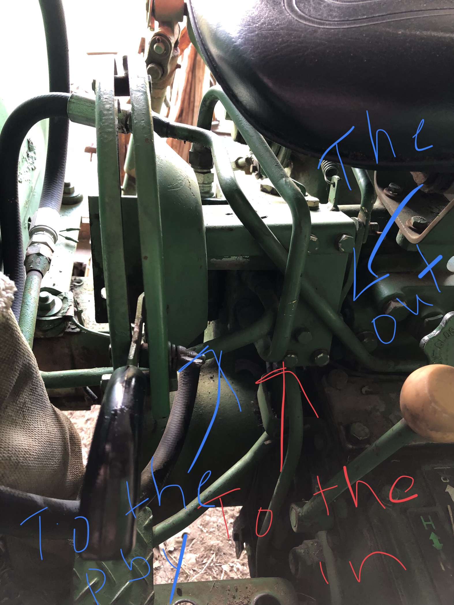

I have marked up one of your photos.
The steel lines I see are marked #1, #2 #3
The ports on the FEL valve are labeled
A, B, C
Which of 1, 2 or 3 did you connect together to prove the 3 pt works properly?
Which of 1, 2 or 3 is the line from the main pump supplying high pressure oil?
I can see that #1 is connect to A on the FEL valve
Where does steel line #2 connect?
Where does steel line #3 connect on the FEL valve B or C?
Where do you see steel lines #2 and #3 coming from on the tractor and does one of them seem to be a return line to the oil reservoir?

Thanks for all the help so far. My loader does not have that set up you posted it’s actual a joystick control valve I labeled how the go in the loader now F43D65EE-67FA-4944-9388-06FDC2274666.jpeg

I connected the in and power beyond together. (That’s how it was labeled). Lol

Thanks for all the help so far. My loader does not have that set up you posted it’s actual a joystick control valve I labeled how the go in the loader now View attachment 543419
Sorry
I did not post the picture I intended
Can you try and tell me where each steel line comes from.
To me the line you labelled in RED and pyb is smaller than the other steel lines.
If this is correct, could it be the main supply line from the hydraulic pump output.
I am starting to wonder if it is just that the IN is reversed with the POWER BEYOND.
Dave M7040

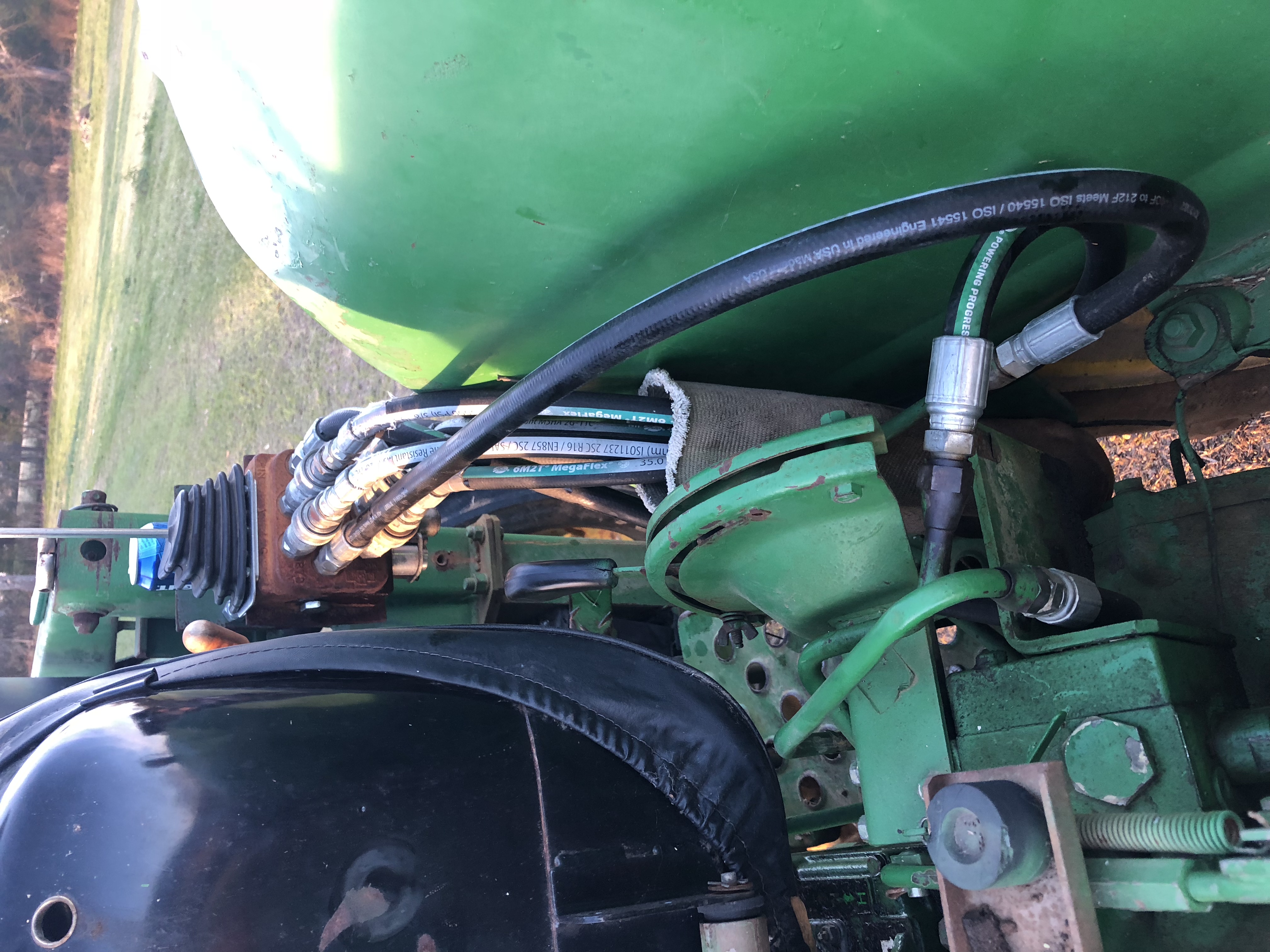

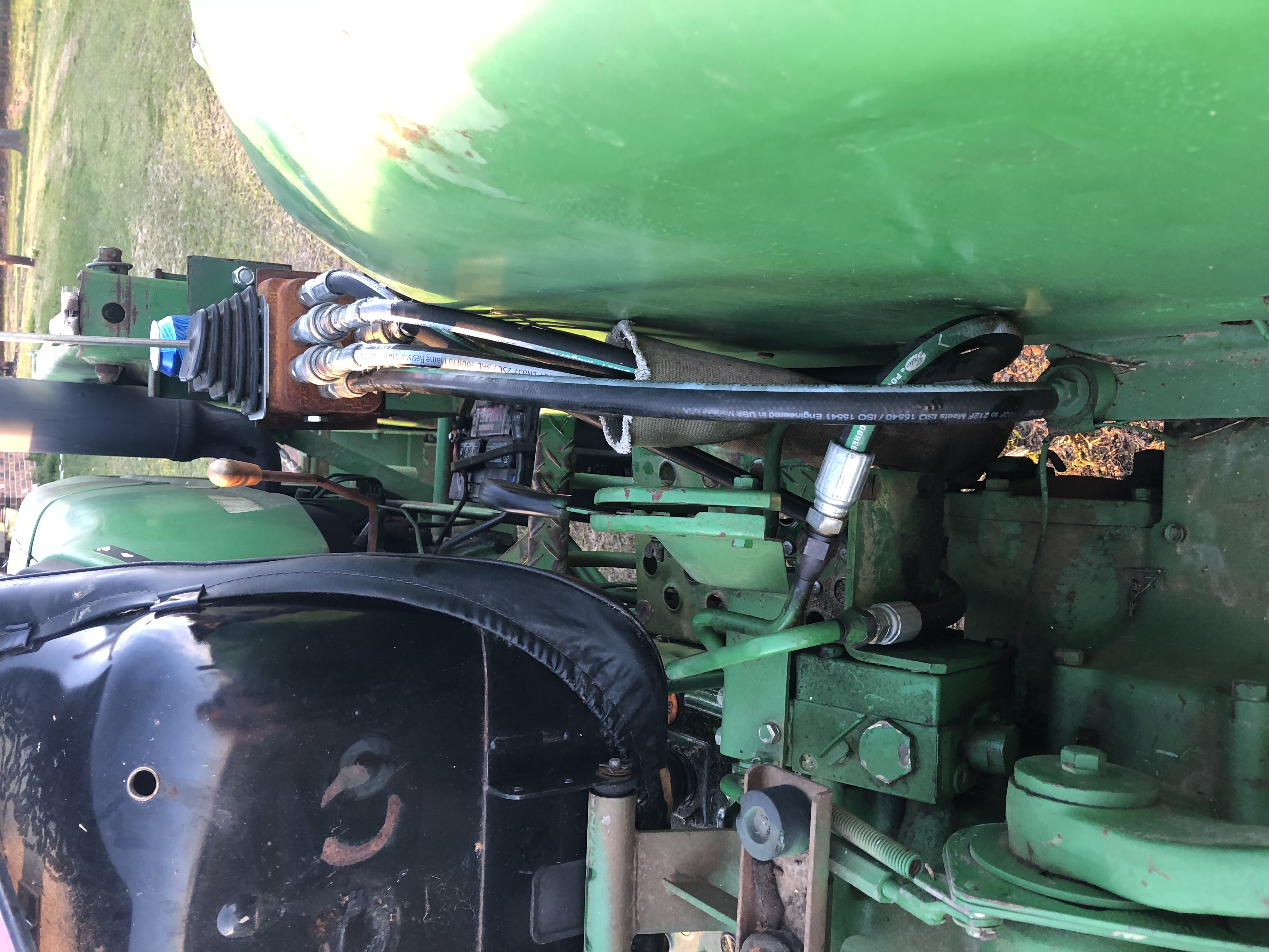

Here is another picture different view
