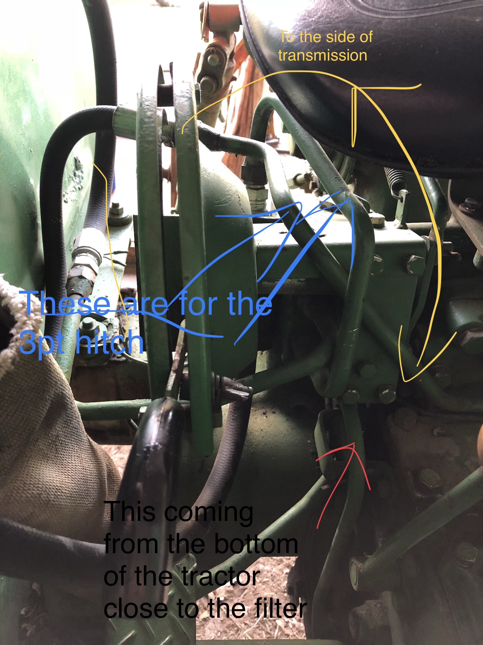

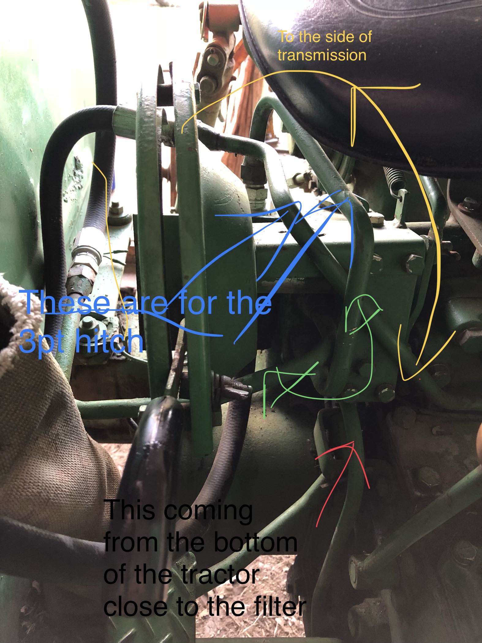

Ok here is how it hooked up now the out on the joystick control valve from the fel is going to the side of the transmission the in is coming from the bottom of he block under the seat the pby one is coming from the top of the same block that the in is coming from but from the top of it. 8514EE9F-B9AD-4D1F-BAA7-2152A0486406.jpeg

Ok here is how it hooked up now the out on the joystick control valve from the fel is going to the side of the transmission the in is coming from the bottom of he block under the seat the pby one is coming from the top of the same block that the in is coming from but from the top of it. View attachment 543766
Kris
You are, I am afraid, answering my questions backwards.
I need to know where each green line come from not where it goes to..
For example, The green metal line from the pump would have oil coming out the end of it as soon as you started to crank the engine.
You need to do that test of removing the line and directing it into a clean pail as you crank the engine for a few seconds. If a stream of oil comes out you have found the pump output which needs to go to the FEL valve block IN.
For the identification of the return to transmission line, use a funnel and pour the oil from the clean pan that came from the pump discharge line line back into the transmission.
When you had only the 3 pt hitch in the circuit, mark up your photo with just a single line to show me the two lines you connected together.
Am I correct in remembering, the problems with the hydraulics only began when the two single control levers were replaced with the joystick?

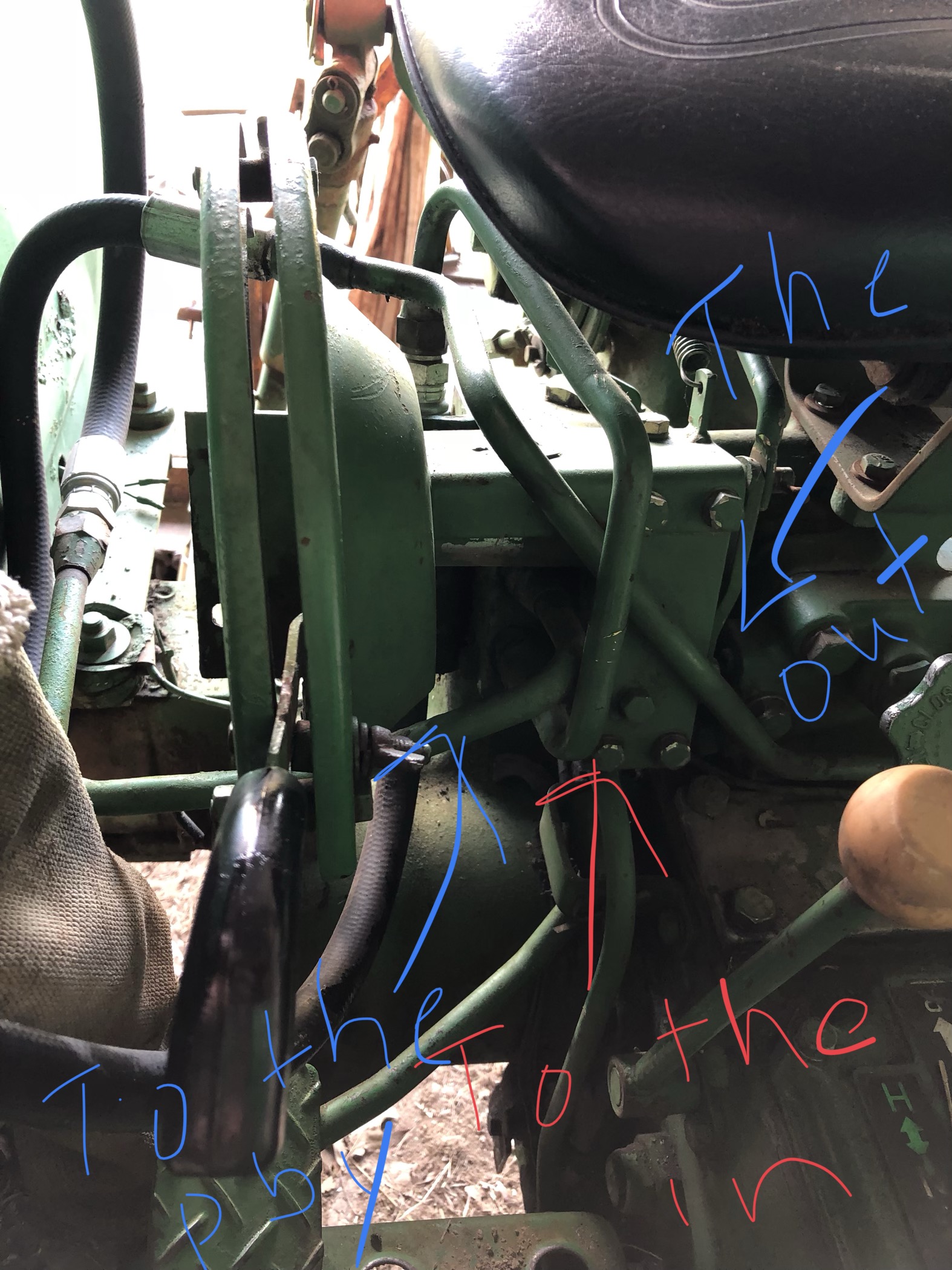

That’s what my loader valve looks like. That is the only valve on the tractor nothing else. I don’t have rear remotes or the old two stick fel controller valve. The only thing under the seat is the block where the 2 lines come out for the 3 point hitch the other line goes to the side of the transmission. 10645DA0-17EA-41B6-9150-7FFFBA9C05B3.jpeg

I don't understand "He never hooked up the 3 pt hitch." What exactly do you mean by this.
Was there a hydraulic line left off which you have now added?
I just got off the phone with CROSS Mfg's tech guy Greg.
As I described your problem he suddenly felt like he had talked to you earlier today.
We need to be certain your DV valve actually has the power beyond sleeve installed.
Without it there cannot be any pressure going to the 3 pt.
Can you remove the cap I circled in yellow in an earlier photo and see if there is another part inside.
The correct power beyond sleeve is part # 1V2853.
