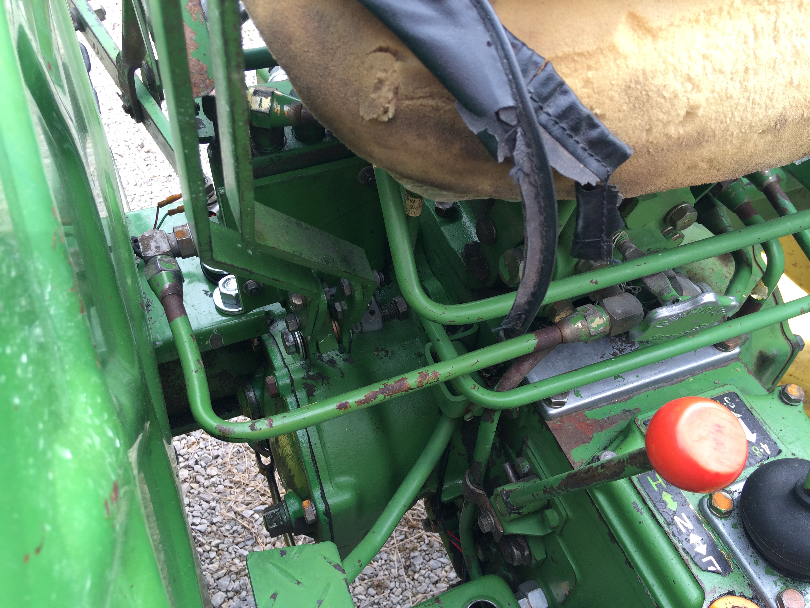

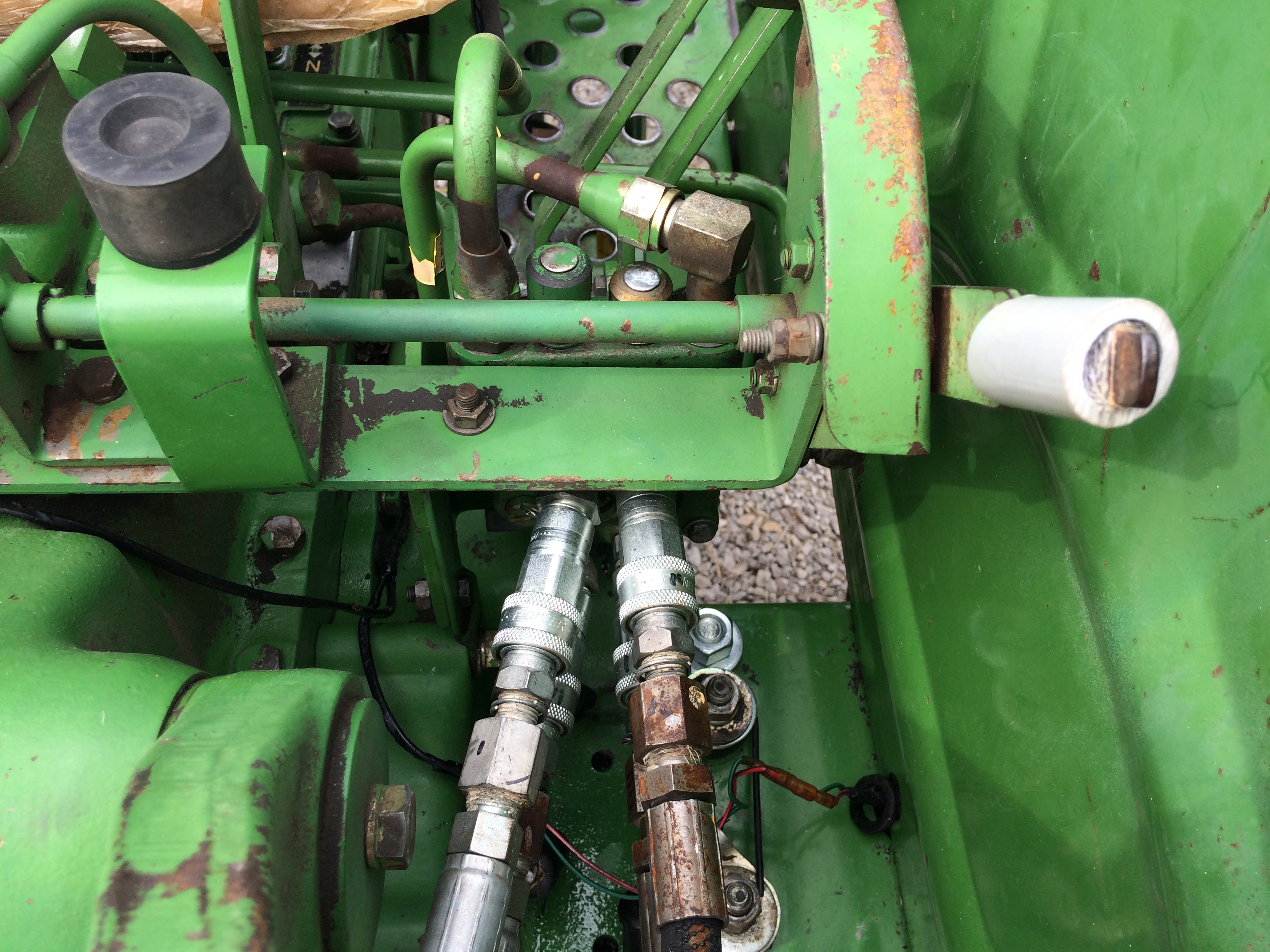

/ john deere 1050 joystick installation help!!!! #16
Kris....
After looking at your photos, my first though is for you to do an experiment.
It looks like a main steel hydraulic line was cut in two and two hoses connected from the two metal cut ends to the FEL valve block by hoses.
See if this looks like what happened.
The experiment is to re connect the two metal ends together to see if the 3 pt hitch works properly.
You could have a short piece of hose made up to connect the two metal ends or, unscrew the two hoses from the FEL valve block and connect their end together using a simple hydraulic pipe thread fitting.
Don't use a plumbing pipe fitting, galvanized or black iron, as those items are not designed for the internal pressure of a hydraulic system.
I think by returning your tractor to the way it was before the FEL install will narrow down your problem.
Dave M7040

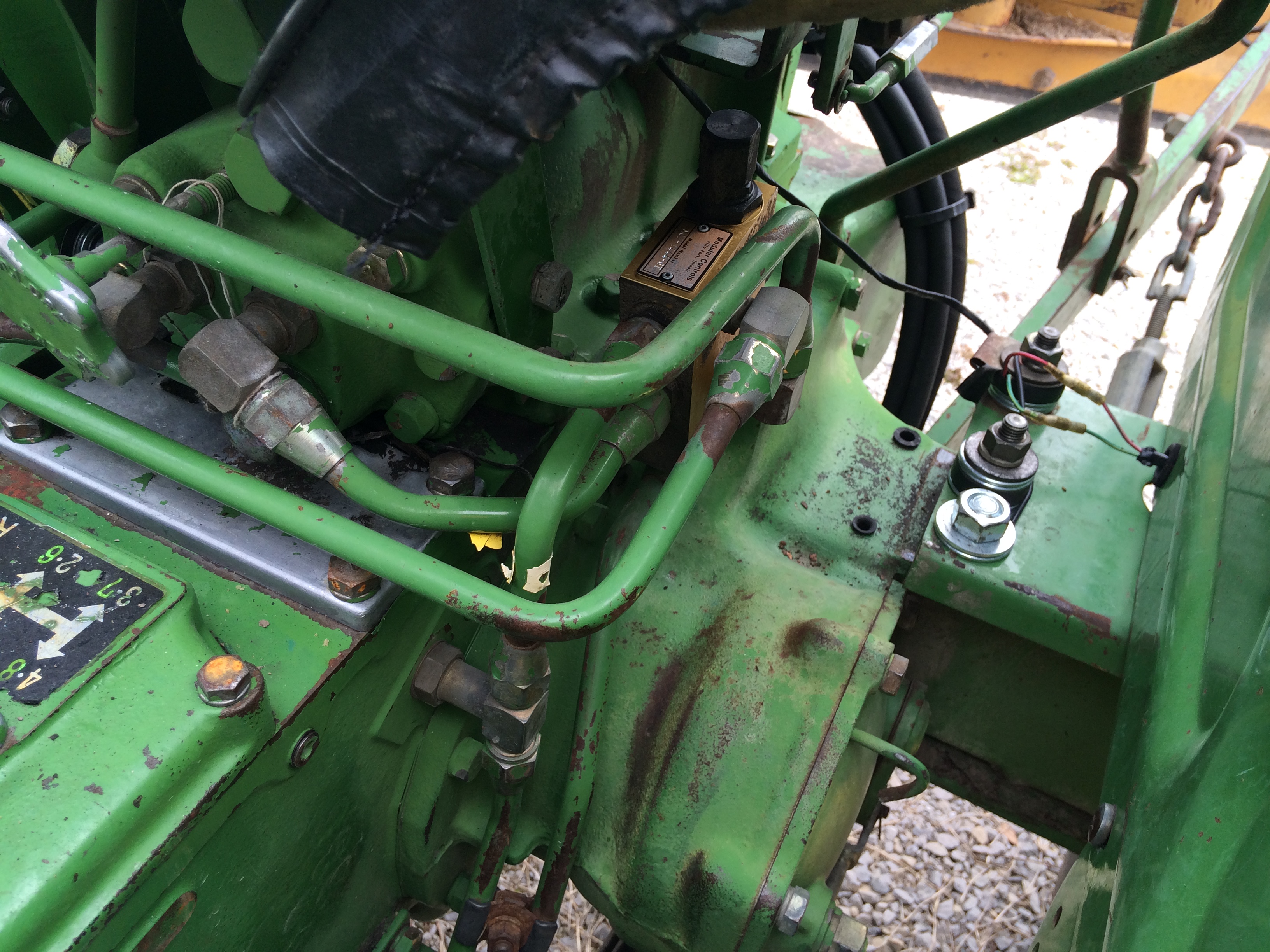

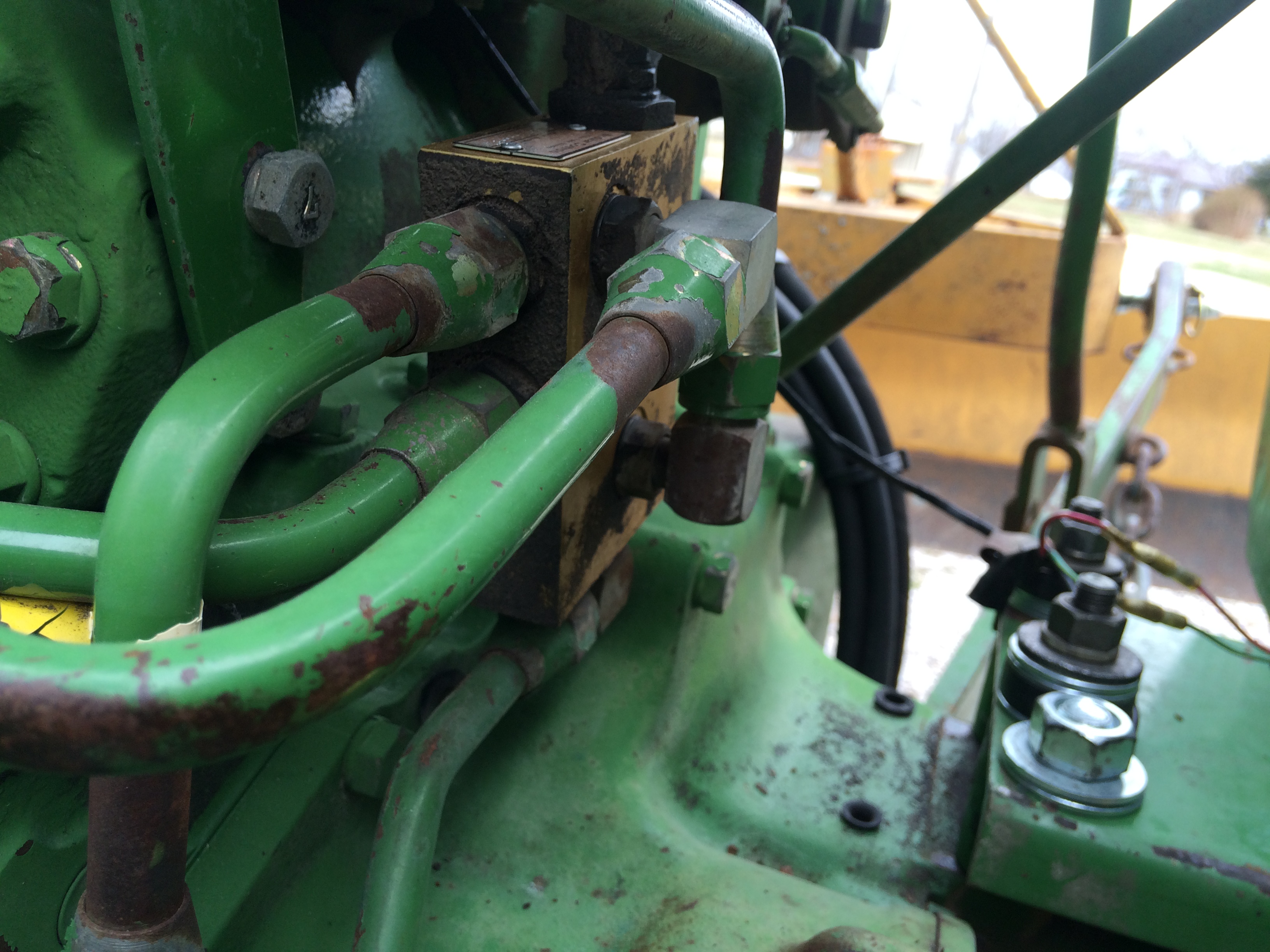

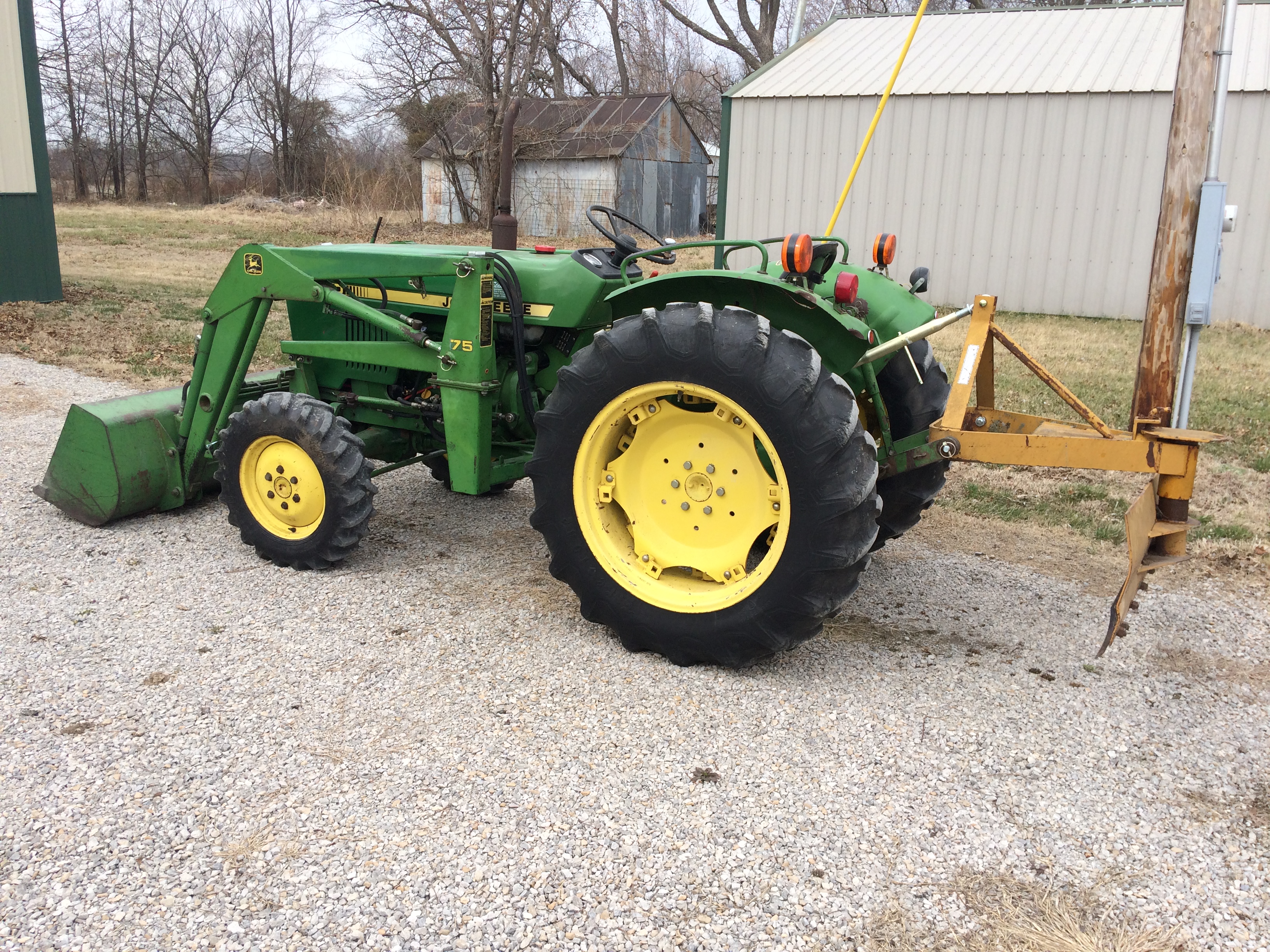

/ john deere 1050 joystick installation help!!!! #17

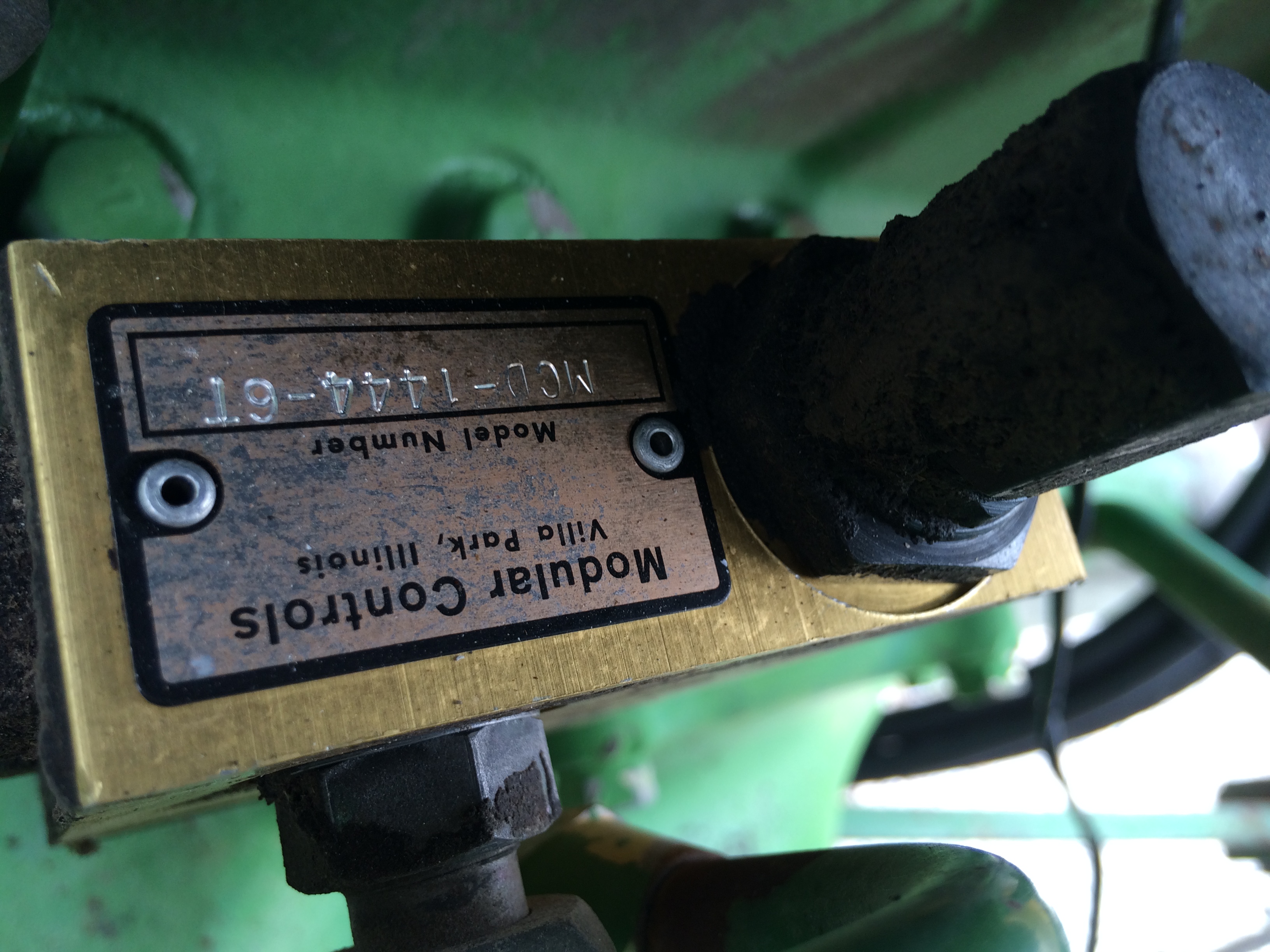

Photos of the rear remotes on a factory JD950 if that's of any help
/ john deere 1050 joystick installation help!!!! #18
View attachment 543357View attachment 543358View attachment 543359
In the third photo, there is a gold colored valve marked: MODULAR CONTROLS MC-1444-GT
What is it for?
Is it like a hydraulic block on other makes of tractors to allow you to add hydraulic circuits. It does not look like a JD part.
Does the rear remote (one circuit of pressure and return ports) have its own control lever?
Thanks for any info
Dave M7040

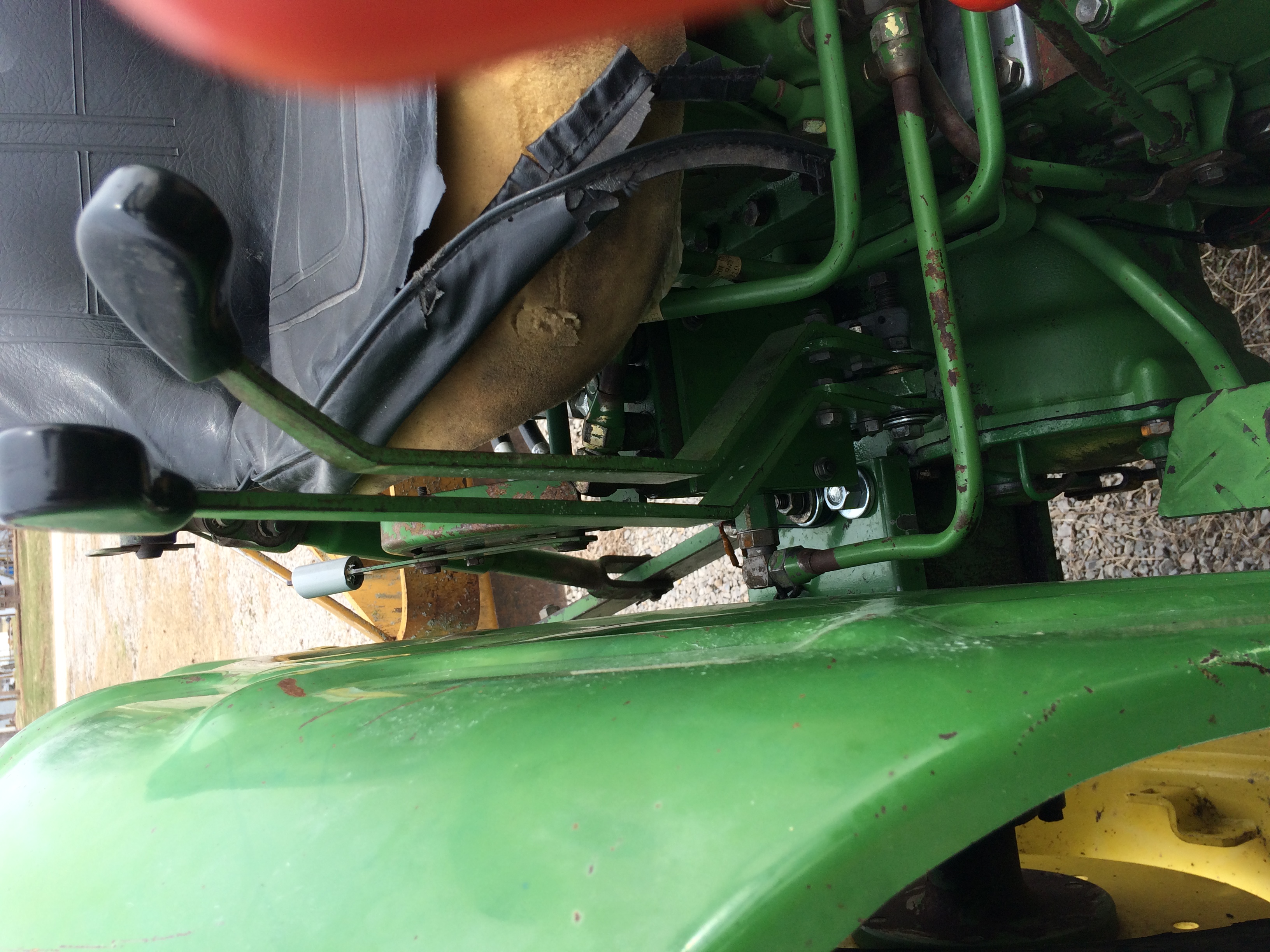

/ john deere 1050 joystick installation help!!!! #19
i would call the rear 2 circuits. One for loader and one for bucket.
/ john deere 1050 joystick installation help!!!! #20
Few more pics that might help.
