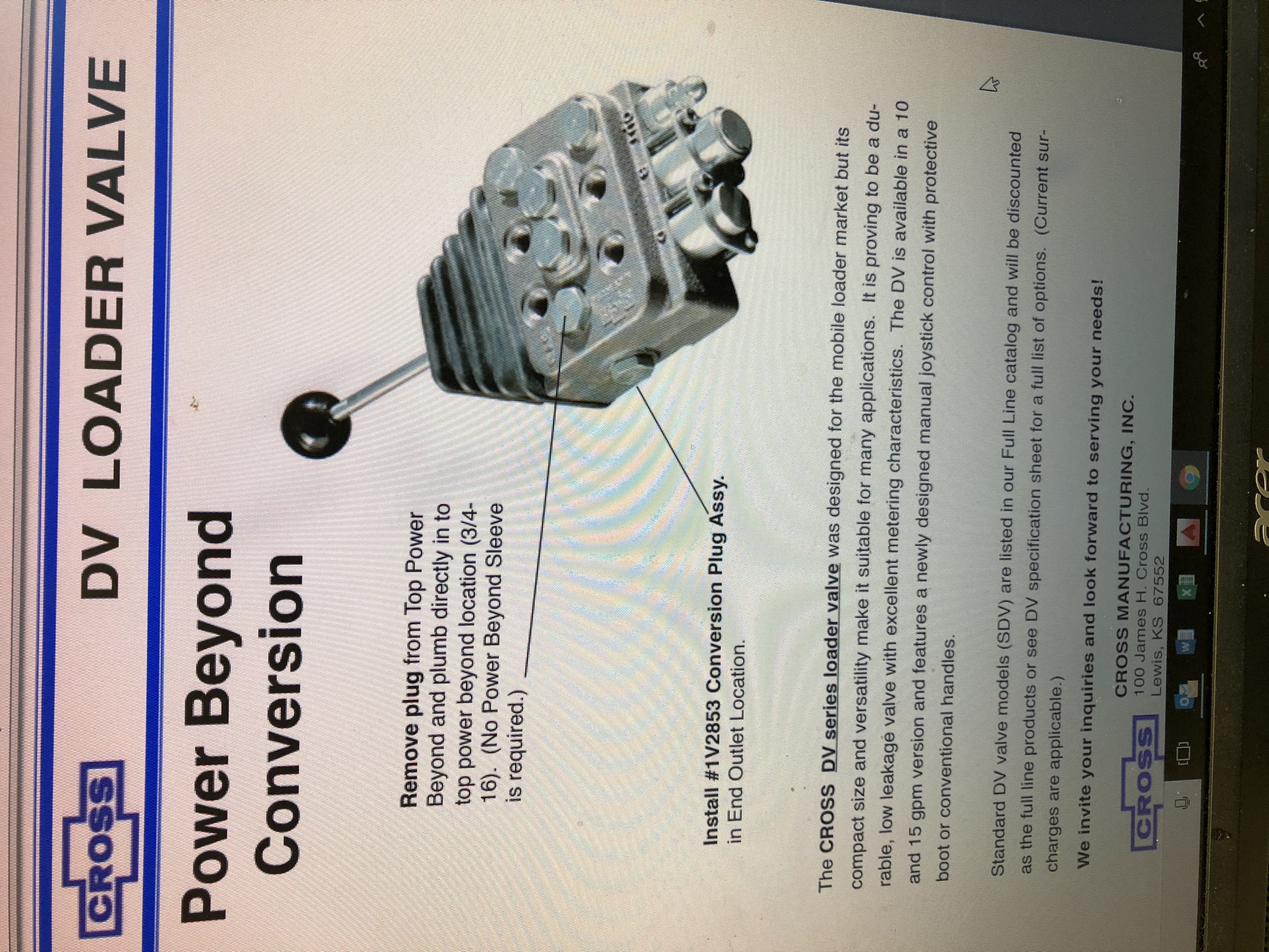

That’s what my loader valve looks like. That is the only valve on the tractor nothing else. I don’t have rear remotes or the old two stick fel controller valve. The only thing under the seat is the block where the 2 lines come out for the 3 point hitch the other line goes to the side of the transmission. 10645DA0-17EA-41B6-9150-7FFFBA9C05B3.jpeg

I don't understand "He never hooked up the 3 pt hitch." What exactly do you mean by this.
Was there a hydraulic line left off which you have now added?
I just got off the phone with CROSS Mfg's tech guy Greg.
As I described your problem he suddenly felt like he had talked to you earlier today.
We need to be certain your DV valve actually has the power beyond sleeve installed.
Without it there cannot be any pressure going to the 3 pt.
Can you remove the cap I circled in yellow in an earlier photo and see if there is another part inside.
The correct power beyond sleeve is part # 1V2853.

when i say he never hooked it up i mean he never added an implement to the tractor after he got it back. when i got it the 3 pt will move up and down but i never had an implement on it till now that i added an implement it will not pick it up.i don't have a picture of the plug with me but ill see if i can find one online that looks like what is in there now

The CROSS spec sheet according to Greg has mistakes.
In the following illustration I have blacked out the mistakes in labeling ports
