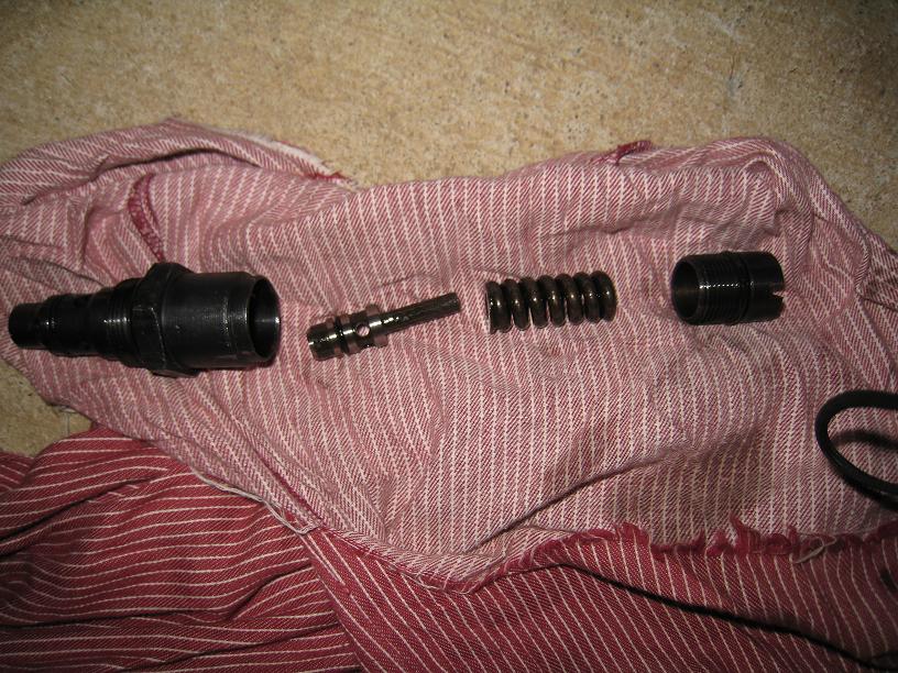

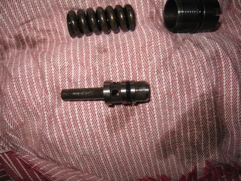

Just got a few photos here, it's been raining so I had tarps over them. There are a few items on that I cannot identify or recognise.Any help is greatly appreciated. The manual does not identify these.
thanks
ok,
the BH Valve is similar or maybe the same as mine and if i am not wrong the two extra RVs are for the Swing Cylinders but maybe the plumbing is not correct.
I have these 2 extra RVs also but not at the same place.
This is the Spool for the Dipper and i have caused by the RVs a minimal Breakforce when i pull the Dipper in.
The Plumbing is incorrect and different then showed in the Manual and the BH self.

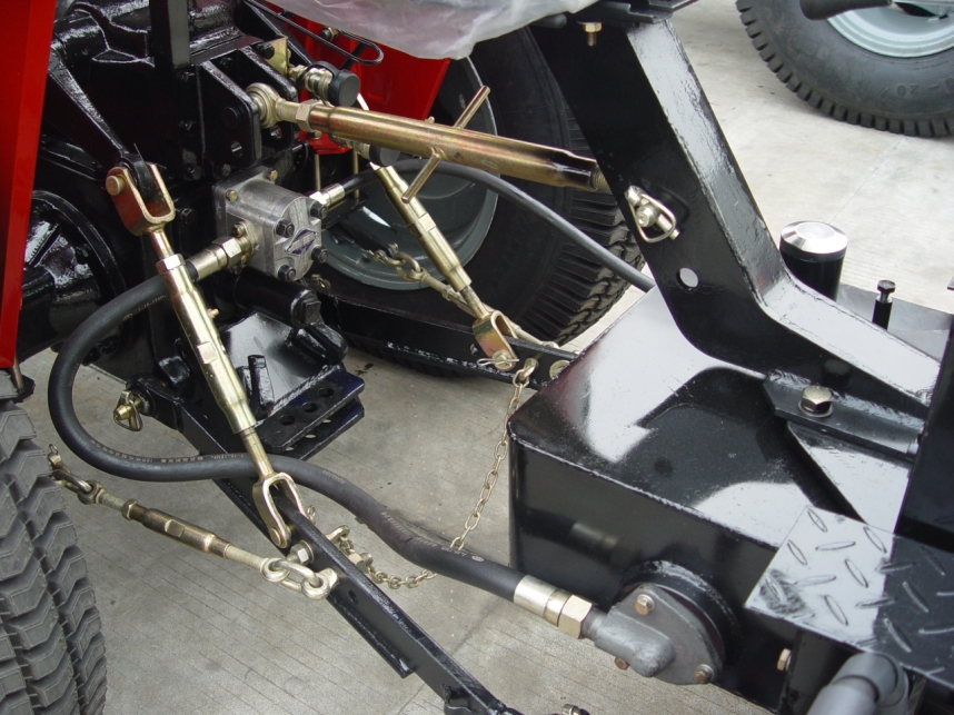

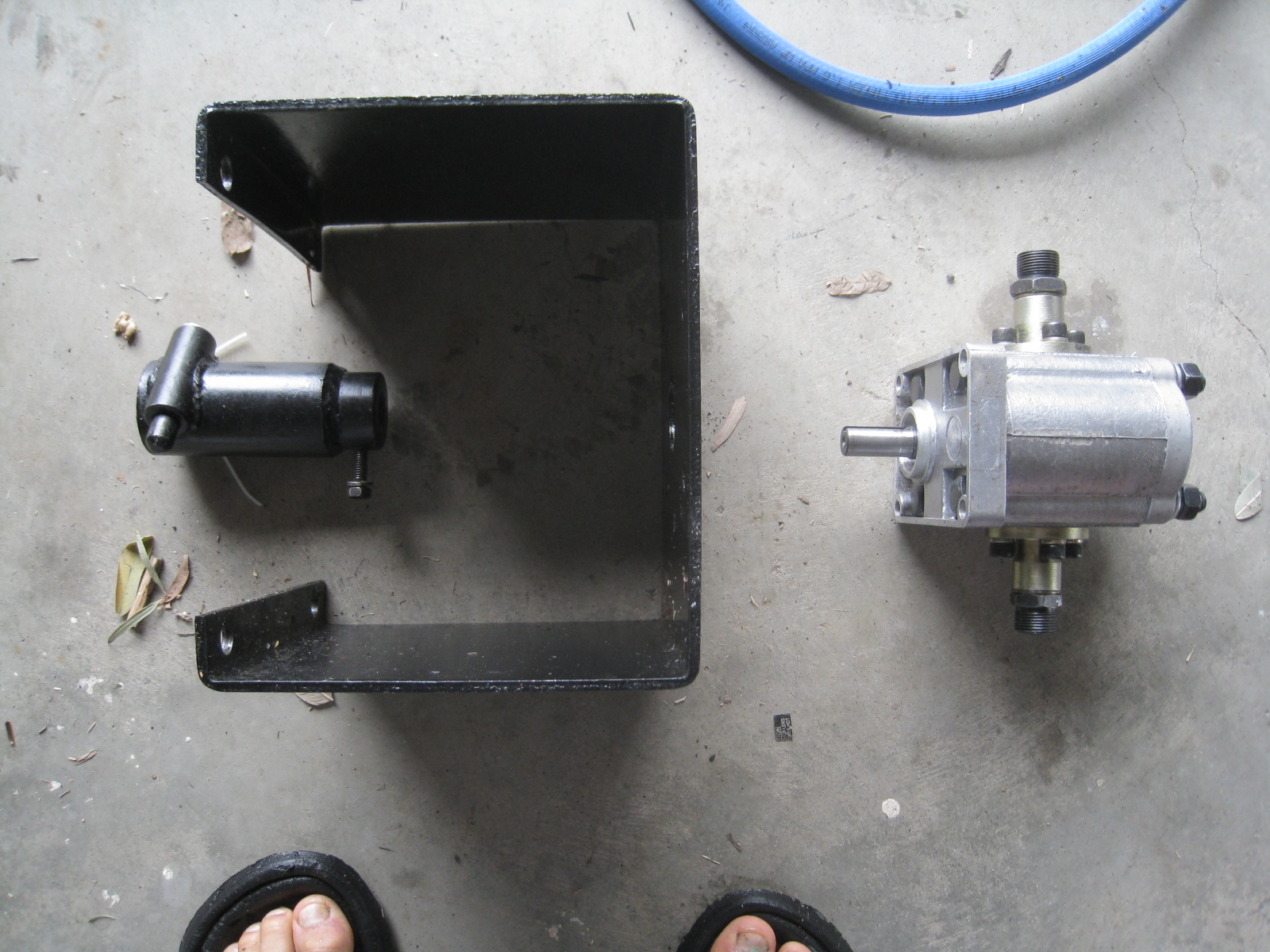

here are some pics of the pump. It's definitely the wrong thype of pump to fit on the 6 splined PTO shaft.

in the first of your pictures, for what is this balck piece for?
it looks like an adapter for the PTO 6Spline PTO shaft.
if you can slip the Pump Shaft into this piece and on the other side you have the the Female for the PTO Shaft?
if it is so, i am sure that this Metal Brace is for the Pump and you must run the Pump with the higher 1000rpm PTO Gear because there is no Gearbox to increase the 540 rpm.

Doing that is still going to result in low flow and pressure as that pump is designed to operate at about twice that RPM to develop full pressure and volume. You'd need either a gearbox to up the PTO rpm to around 2000 for the pump or you need to get the proper pump, I'm afraid. I don't see any other alternatives.

Ok I'll try to explain. Basically the setup you see has come from the factory that makes the loaders and backhoe. It's all set up to go on to the 6 splined pto shaft. However, becasue of the type of the pump, it's more suited to the faster spinning shaft above the 6 splined PT) shaft, This other shaft is the
3rd picture in my last post.
Spinning this pump on the 6 splined pto shaft can only get me 750rpm at 2200engine rpms, this is not enough to get the pressure. My options are 540/750 for my pto.
SO, what I'm going to do is to modify the pump shaft to fit over the tang on that upper pto shaft which seems to be spinning at engine RPMS, thus I can run the engine at 1500rpm + and get a decent pressure out of the pump, given that it has a nominal 2000rpm, I think 1500 engine rpms should be ok.
so In essence, the factory should have put a gearbox on that black brackt to step up the speed, or givien me somer kinf of adapter to hook up to the shaft above the 6 splined PTO. Or a pump that could generate such pressures with 540/750 PTO rpms.

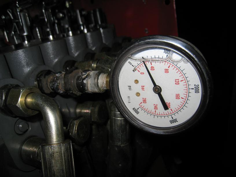

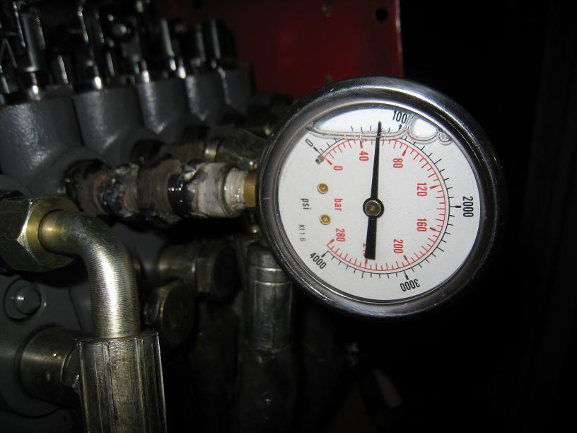

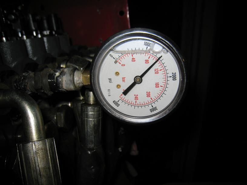

Thanks Nuno but I don't quite understand how you got those calculations. It seems to me that that innershaft above the 6 splined PTO is meant for hydraulic pumps as shown in Tommy's picture with that coupling. That's what I am going to try to make.
If you read the earlier posts, you'll see that I dead headed the pump running it off the 6 splined PTO and the most pressure I could get out of it was 1500psi. The pump didn't break the engine did not struggle and when I lowered revs the pressure dropped accordingly, there's enough space in the pump gears to relieve pressure once it stops turning, and even when it is turning there is some loss of pressure within the tolerances of the bore and gears. Dead heading it at 750 PTO rpm could only get 1500psi, but i'm sure that If I could increase the rpm the pressure would reach in the vicinity of 2200psi which is what I need. This is why i 'll be attempting to fabricate that coupling to atach to the pump.
