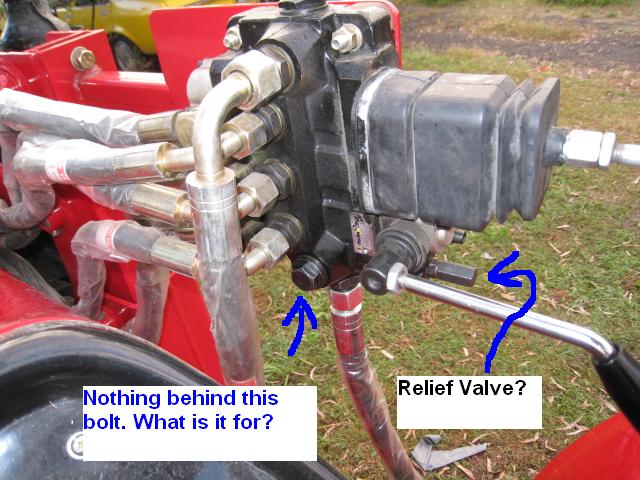

Just another question. how do you know id the relief valve is working for the BH or the loader? When the BH moves to its maximum position there is a bit of noise coming from the PTO pump. Does that noise indicate that the relief valve is working?
However, when I use the loader, in maximum positions whether it be the bucket closing/ opening/ lifting etc the engine bogs down and shudders, like its really straining. That does not sound like a relief valve working??? When I feel the shuddering I release the lever immediately.

A relief valve should give a squeal. If is bogging the motor down its not set properly. On my 254 I set the loader relief at 2400 psi.

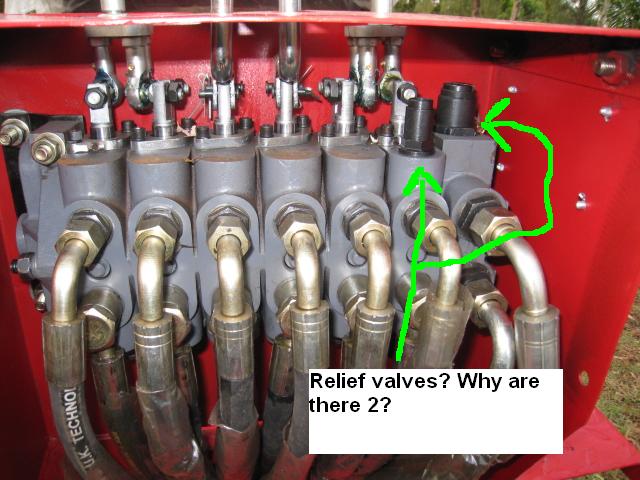

I followed the teachings of another member, 3RRL, whose great technical postings you can find. I installed remotes, another relief valve, etc.
The take away is this: I installed a relief valve right next to the pump output and routed the relief port to sump. I also installed a pressure gage and set it to relieve around 2300 or 2400 as per the manual that came with the tractor. After that, I adjusted the relief valves, one at a time, on the loader and logsplitter to relieve at a lower pressure, maybe 100 psi less than the primary relief valve.
By doing this, the system was working to capacity but still protected while each accessory was also working with suitable pressure.

I'll get some photos up after work. I've just ordered a pressure gauge to see what's going on with the whole system. Regarding the loader, I had a little look today and I think What I was look at was the relief valve, I took a long end nut off and there was an allen key bolt inside, I didn't change any settings as I'm unable to read the pressures just yet, but judging from the bogging engine when hydraulics are at its max, it'd probably not set properly as suggested by a member.

One of my problems on mine was the seal that was on the relief valve up inside. I missed it the 1st time I took it apart. The BH acted odd, power everywhere except to lift the main arm. Once I fixed the relief valve seal everything worked great.

Just got a few photos here, it's been raining so I had tarps over them. There are a few items on that I cannot identify or recognise.Any help is greatly appreciated. The manual does not identify these.
thanks
