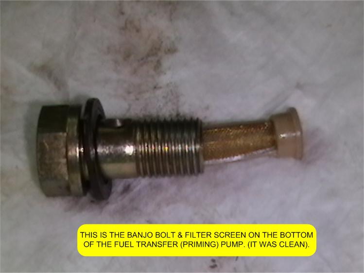

Next) The banjo bolt at the IP has a screen filter I found it was plugged sold with "crud" and slimy snot substance after reading many post here I believe to be "bugs". I cleaned away as much of the physical material as I could and gently tried to blow it clean not terribly effective. I let the screen sit in mineral spirits over and and used a nylon brush and some gentle air and got it to a state seems clean enough to flow fuel but will be replacing with new (if available).

After your verbose explanation I conclude you have fuel starvation issues. Given the age of the fuel in the tank I'd start there. I'd drain the tank but before refilling it with fresh diesel check the fuel output location. You may have a screen in there. You could have algae clogging the screen allowing only a minimal fuel flow. After filling the tank you should add an algicide of some sort. Ensure you have free flowing fuel throughout your system. It may not solve your problem but it will eliminate the fuel system.
   / 2003 Jinma 354 Starts runs 1 minute dies and will not restart without fuel prime #3
It sure sounds like you have a case of "bugs". The slim you found was the dead bodies of billions of bacteria the sink to the bottom of the tank and plug filters.
Most sediment bowls have a fine mesh screen at the top of the bowl. You didn't mention that so be sure to look for it as it is most likely plugged as well.
With the sediment bowl removed, open the shut off valve and check for flow rate. As Roadworthy mentioned some tanks have a finger filter in the tank. I am not sure if that will come out if you remove the sediment bowl or not. I would recommend replacing the factory bowl with an after market one that uses a glass bowl, much easier to see the fuel and to maintain. I got mine from Ranch Hand Supply.
If you don't get all the bugs killed, they will continue to have a happy life in your fuel system, and eventually ruin everything in it. Personally I would remove the tank and scrub it out really well, then replace all the filters and screens and start fresh with new fuel and use a biocide treatment. It seems expensive but a little goes a long way.
Also, don't forget any tanks or fuel cans you use to fill up the tractor. If they are contaminated and you put that fuel into the tractor, you get to start all over again.
Good luck!
   / 2003 Jinma 354 Starts runs 1 minute dies and will not restart without fuel prime #4

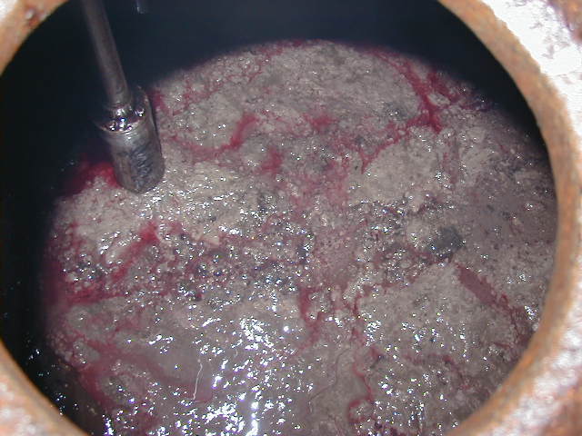

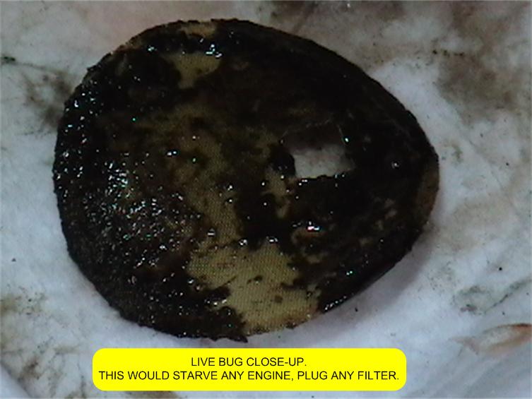

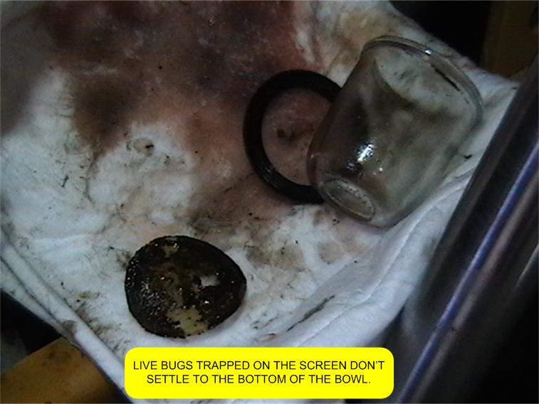

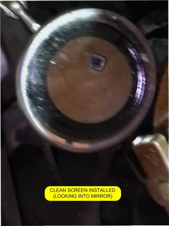

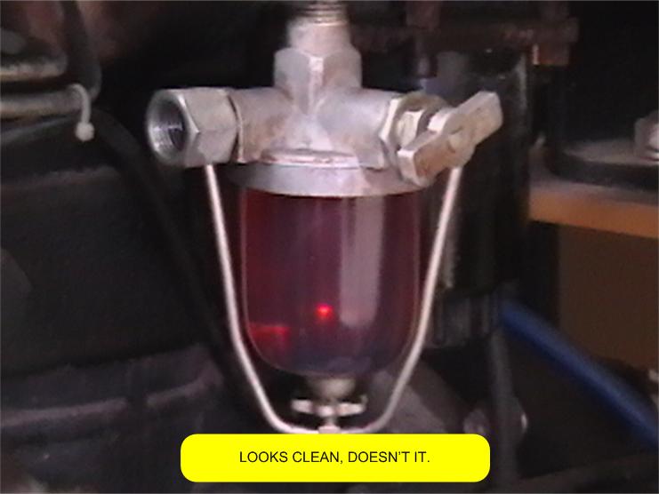

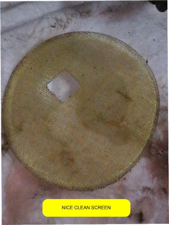

As Piper mentioned, diesel bugs are very real and they can do a lot of damage to the injection pump and injectors. They are highly corrosive. I have a lot of first hand experience on the subject.
These are of my dozer.
Here is a pic of one of the fuel purifier sludge tanks on one of the ships I worked on. Full of dead and live bugs.
