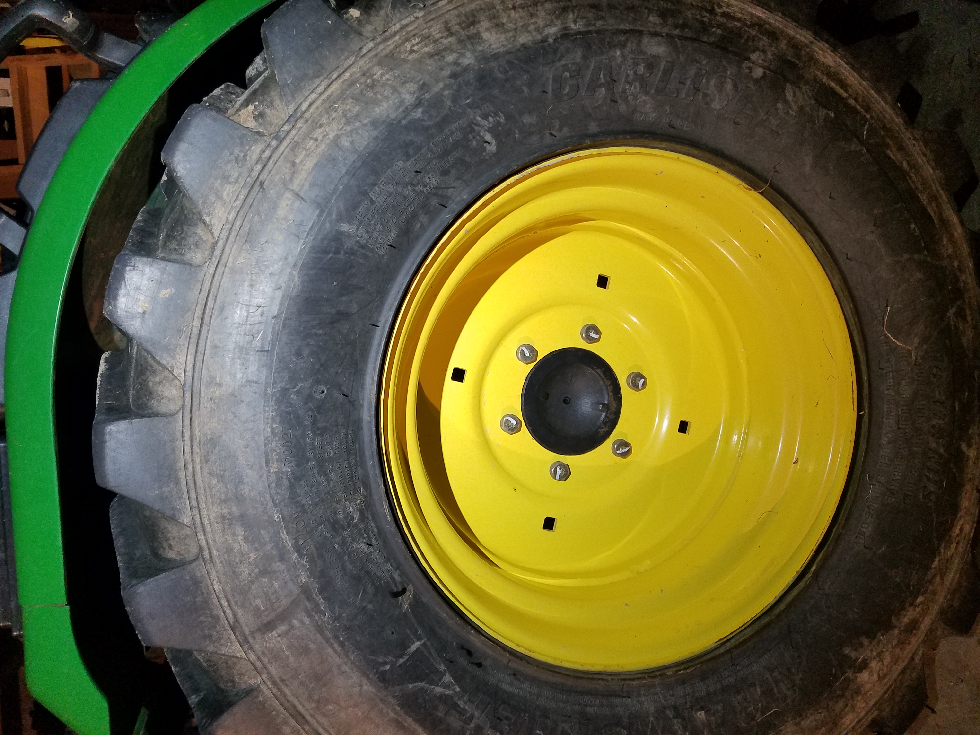

Hi All,
Still going the through the paces with my JD2720 and was able to get a good price to get the rear wheel filled with rimgard.
The challenge is that the valve stems are in the inside.
If i take the tires off, then I cant put them back on with the additional weight.
Can i reverse the tires to have the valve stem on the outside. Will that make the stance narrower?

That depends on the offset and wheel design. Just measure the offset on both sides and you will have your answer.
The stock wheels on my 4310 places the valve stem in with them on the wide setting. I bought a set off eBay that have a greater offset that places the stems out in the wide setting. Sorry not to answer with any more specifics. Without pics I don't know the design of the wheels you have.

Thanks, just measured and the difference in offset is only 0.5 inch. Seems it wont matter too much if i swap sides. Maybe spacers are next on the list

I just linked it to show that the rims have valve stems on the outside.
You can tell by the centers that they are reversed from yours. The question is what that does to tread width?

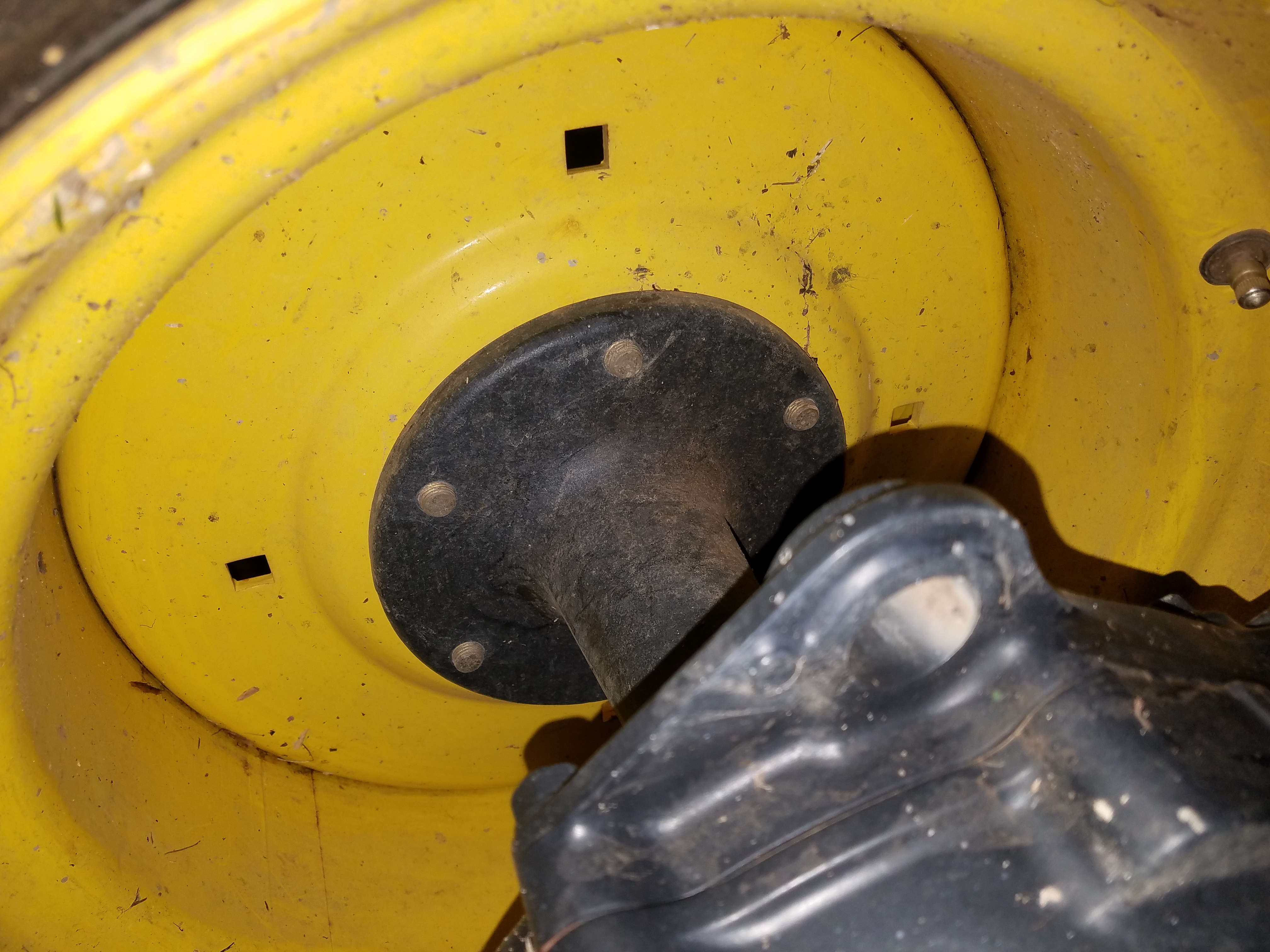

They came over today and they have an adapter that connects to the valve stem and it extends out over 6inches and needs to be hooked up with the fluid pump. So they cant do it in the current config as it hits the main hub assembly.

When trying to switch loaded wheels from side to side to gain width, my 3720 wheels could not be turned around because there were dimples that would not allow be to seat the wheels fully, I found out later. It did work for a while.
The valve stems were on the inside and I thought that didn't matter much anyway. That was until I was pulling dirt and brush with my box blade. Some sticks got jammed between the wheels and then tractor frame and as the wheels rotated it sheared a valve stem off, then the fun began.
To make the wheel stance wider I needed to put on spacers and leave the wheels on the same side of the tractor to keep stems on the outside. I still need to take care in heavy brush, but not as much.

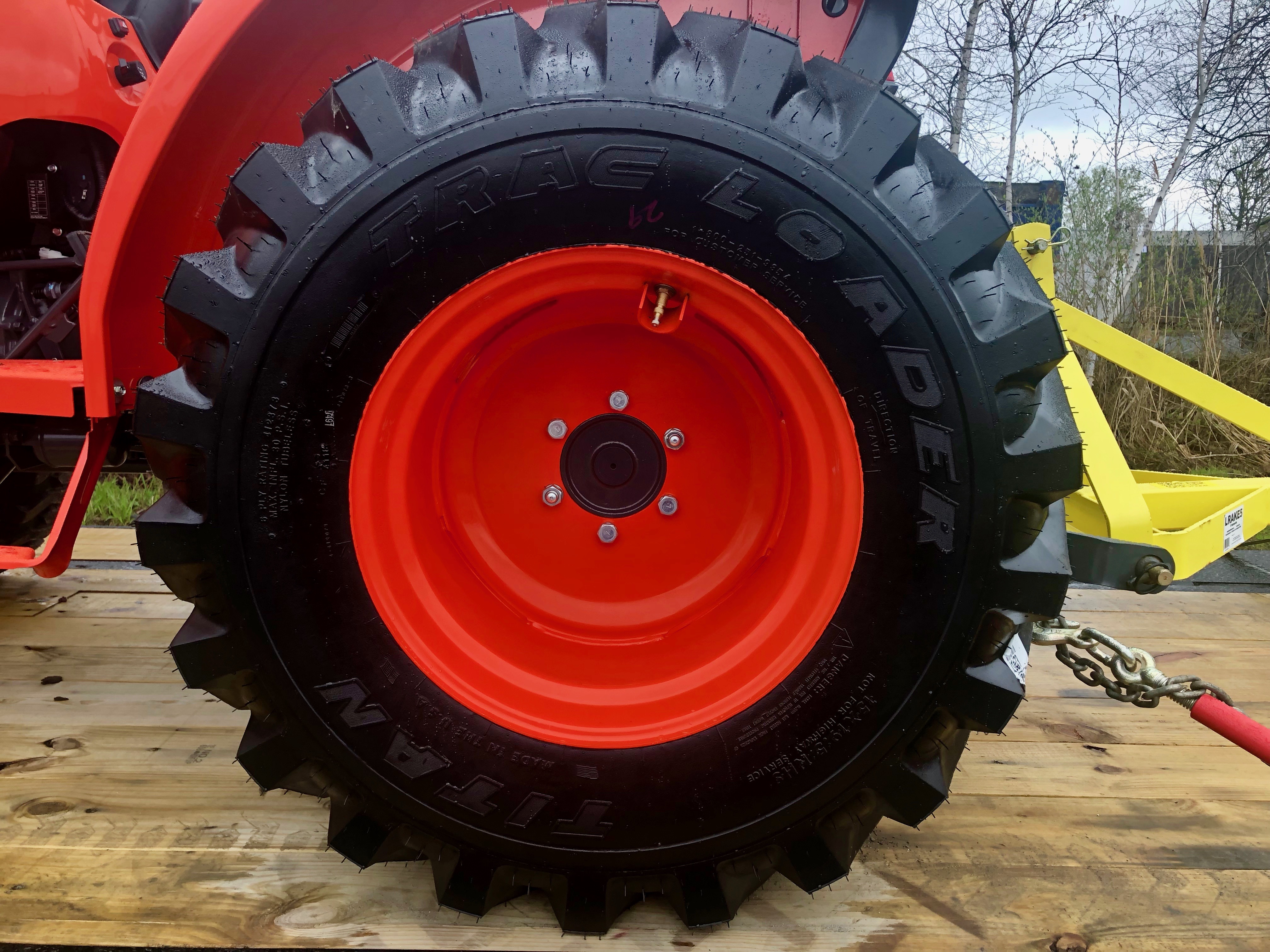

Kubota has a little half metal circle guard for the valve stems; does Deere do something similar? See pic. By the way, I love your signature. IMG_5216.jpeg
