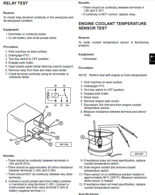

Does the tech manual have physical descriptions of the various relay and switches? And does it describe how to pull the instrument panel to get at them? At this point, I'm limited to physically tracing the wiring to find and test the various relay and switches.

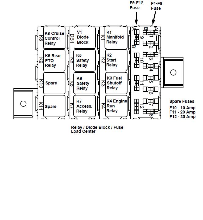

doc
There is a relay test procedure, and I suspect it applies to the relays in the fuse and relay load center. The relay is K2 that is the starter relay.

I don't have any manual. I'm just going by what was posted earlier. Rather than test the relay, just swap it out with another one or use the spares in K10 & K11 if you have them. I think they will all be the same.
You might want to try and place a jumper from F5 straight to the solenoid. If things work then, you've narrowed the problem area down to the switches and connections in that part of the circuit. You can also pull K2 and place a jumper between pins 30 & 87. That will take K2 and the rest of the circuit out of the picture.

Thanks again for the input. Not having a lot of luck due to inability to find the physical location of the F5 fuse and the PTO and transmission neutral switches on the wiring schematics. Tested the K2 relay which tested fine.

Anyone have any information on where to physically locate the F5 fuse, the rear PTO switch, and the neutral transmission switch?
