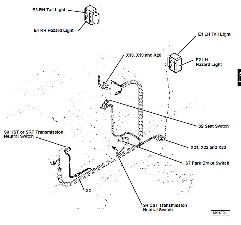

Here is the wiring bundle for location of neutral tran switch.
The F5 fuse is with the other fuses on the fuse and relay board (previous pic posted). When I find the PTO sw, I'll post

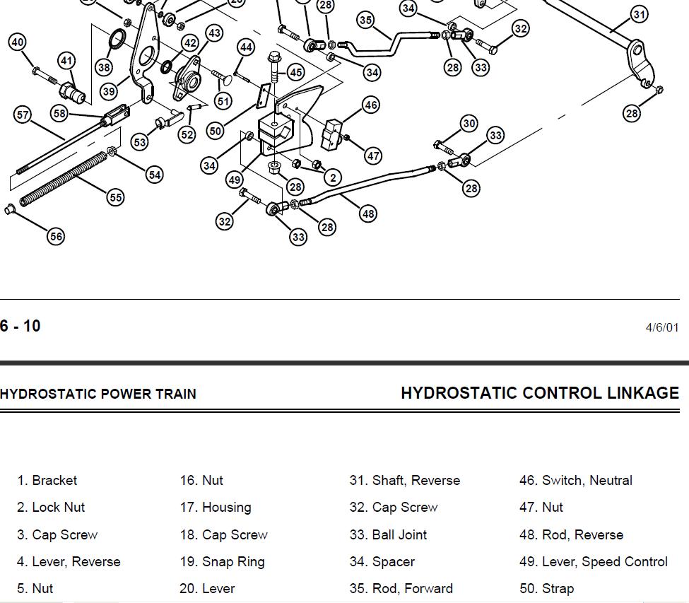

Here is an image showing the neutral switch (46) bolted to the speed control lever (why?, I don't know).

   / JD 4400 Tractor won't start #36
I have a PTO lever on the right side of the seat. I've pulled, pushed, jiggled, cussed and it still won't start.
The PTO mechanism is a huge problem with these tractors. The switch is
on the central gearcase on the upper left side. You need to get in there
and put a jumper on the connector, after pulling it off.
As for the neutral switch, if that is causing a problem, then you need to
put a jumper on the "X2" connector under the left side of the floor board,
as shown in BEENTHERE's diagram.
I have permanently jumpered both of mine.

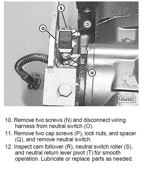

And...another pic showing the actual neutral control switch. Seems getting at it might mean splitting the tractor.... :( But maybe not.
Still looking for the PTO rear switch, and am thinking it is on the right side of the tranny, just under the forward/reverse pedals. But no pic to confirm that yet.
