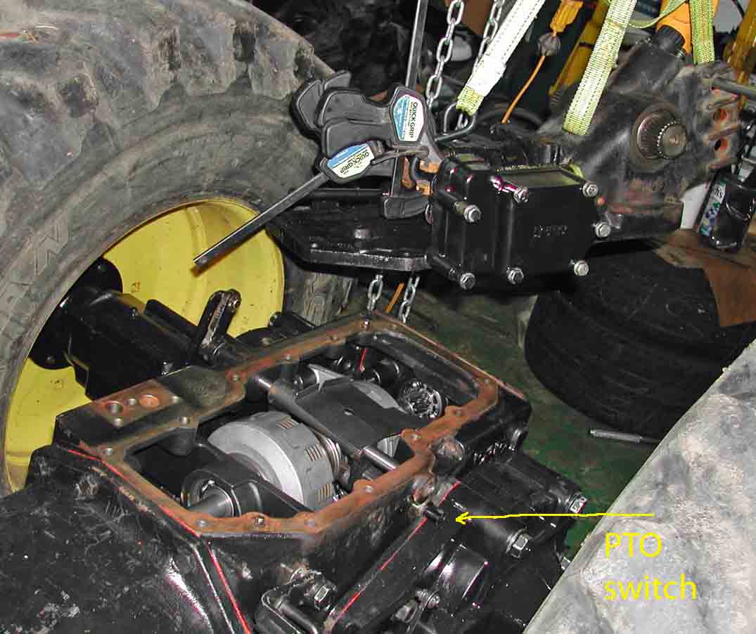

Turned out to be the rear PTO switch. Mechanic said it was a bear to get to...had to pull one of the rear tires and the fender to get to it.
Yeah, it's kind of tight in there.
Did he actually replace the switch? I would have expected a bad wire
or dirty connector, or the failure of the PTO to fully disengage.
