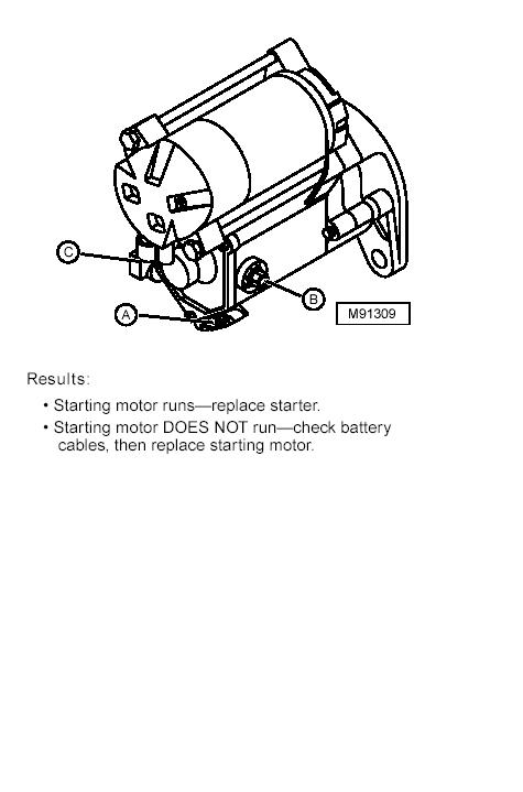

/ JD 4400 Tractor won't start #8
To determine if the starter motor is defective for the 4400

OK...tried the test Beenthere suggested.
Without disconnect the fuel shutoff solenoid wire connector, I disconnected the 309 Wht wire from the starting motor selenoid terminal and jumped from the positive battery terminal to the starter solenoid terminal. Got the starter motor to crank over but did not fire. That's better than it had been previously. I assume the lack of firing was due to the fuel shutoff solenoid wire connector being connected
So, how does one go about checking the cranking circuit wiring?
/ JD 4400 Tractor won't start #11
See second image attached, and letter A at bottom of starter. Should be the white wire referred to for removal. If not, I'll search the tech manual some more.

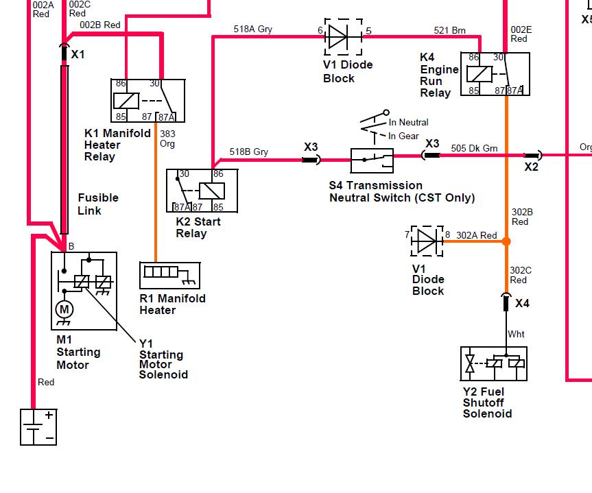

/ JD 4400 Tractor won't start #13
And portion of the wiring schematic, showing starter motor and fuel shutoff solenoid.
If the fuel shutoff solenoid is bad, wondering if that keeps starter from engaging? Anyone know?
#14
OK...check the voltage of the 309 Wht wire to the starter motor solenoid and it has no voltage with the ignition switch turned to start or run. Checked the white wire at the back of the ignition switch (same wire?) and got 12V with the key at the run position and 0V when turned to the crank position.

/ JD 4400 Tractor won't start #16
Just as well throw in the cranking circuit schematic. Might help trace the ends of the white wire. I see it passes through the start relay.
