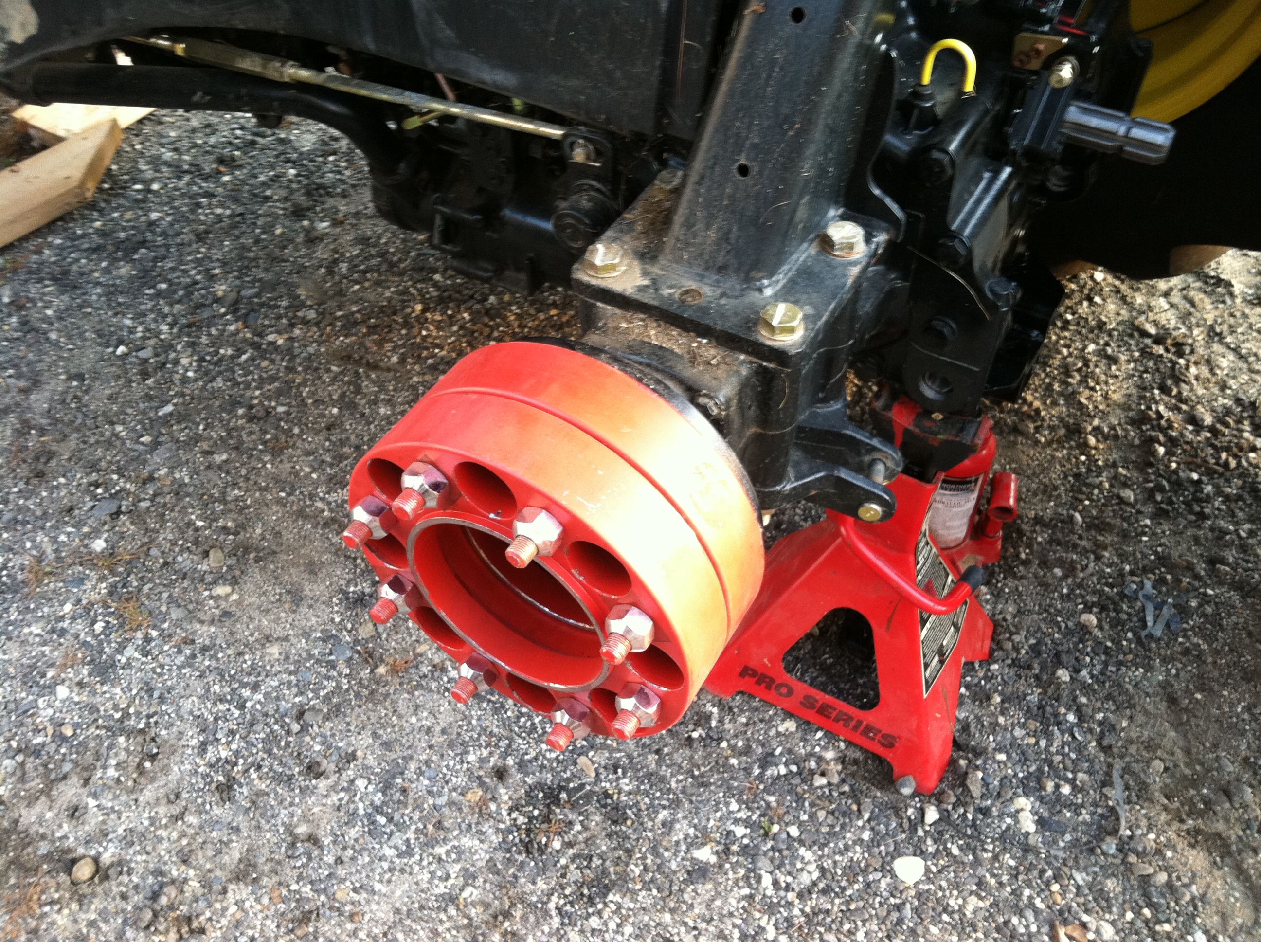

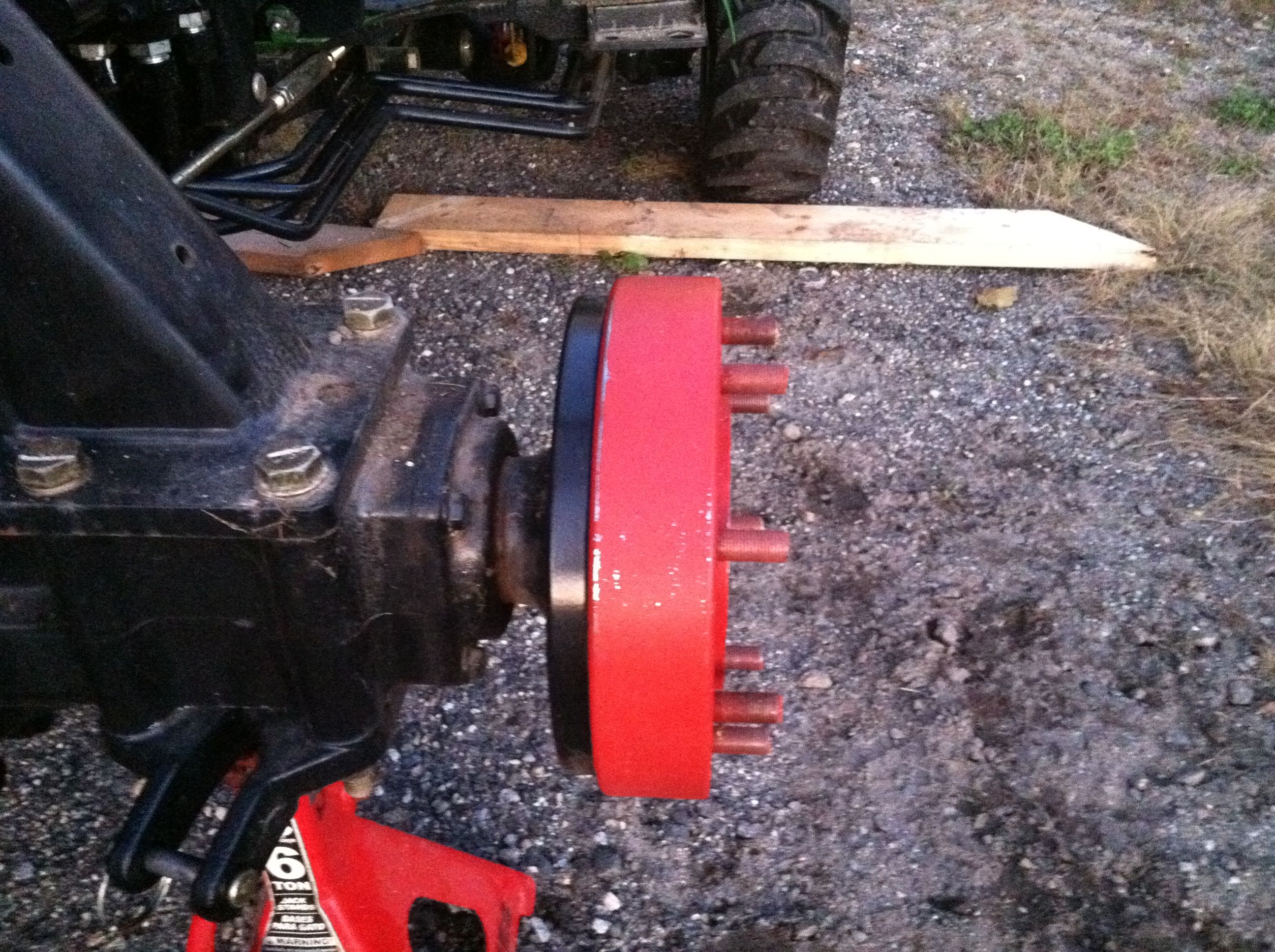

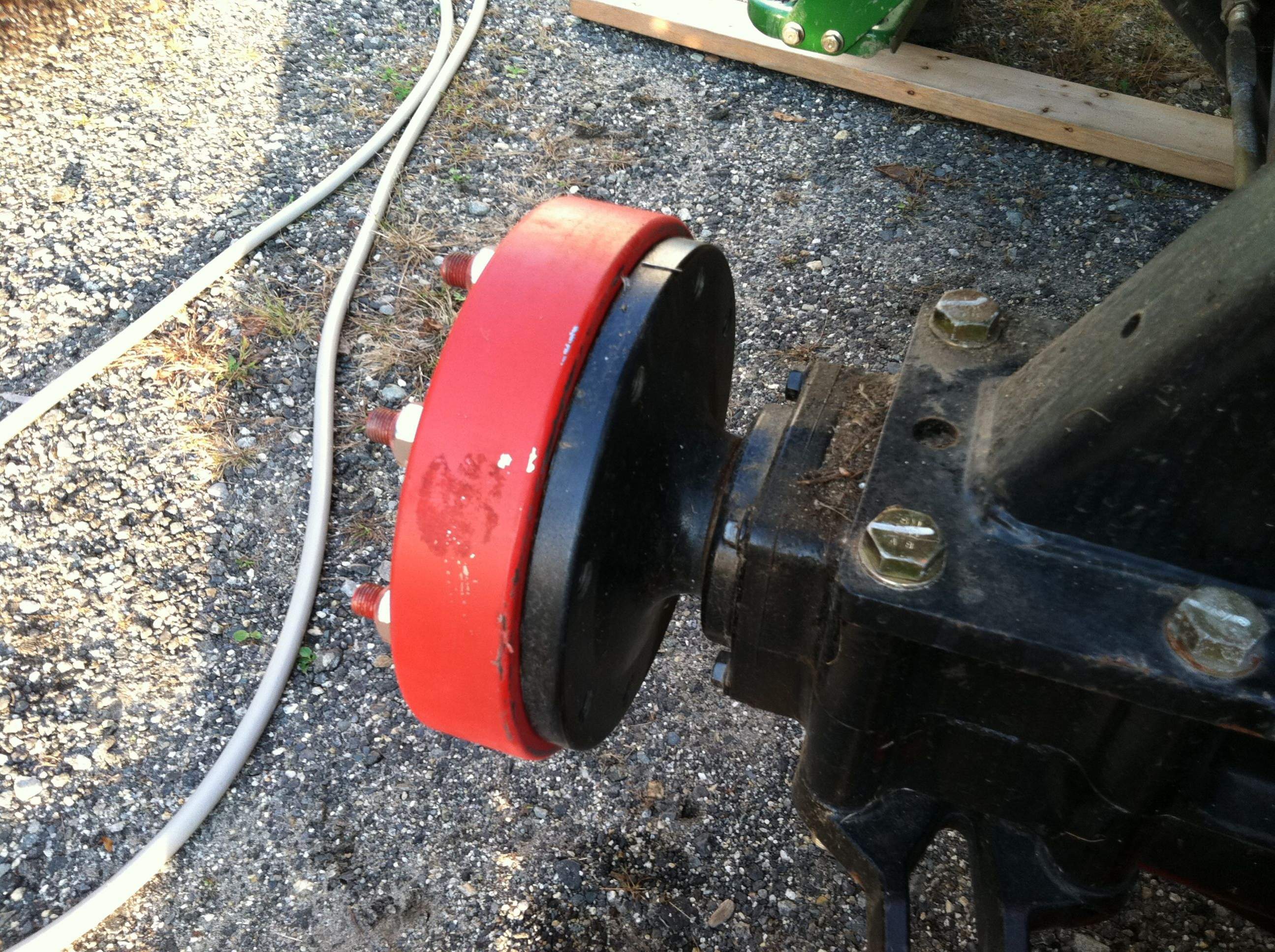

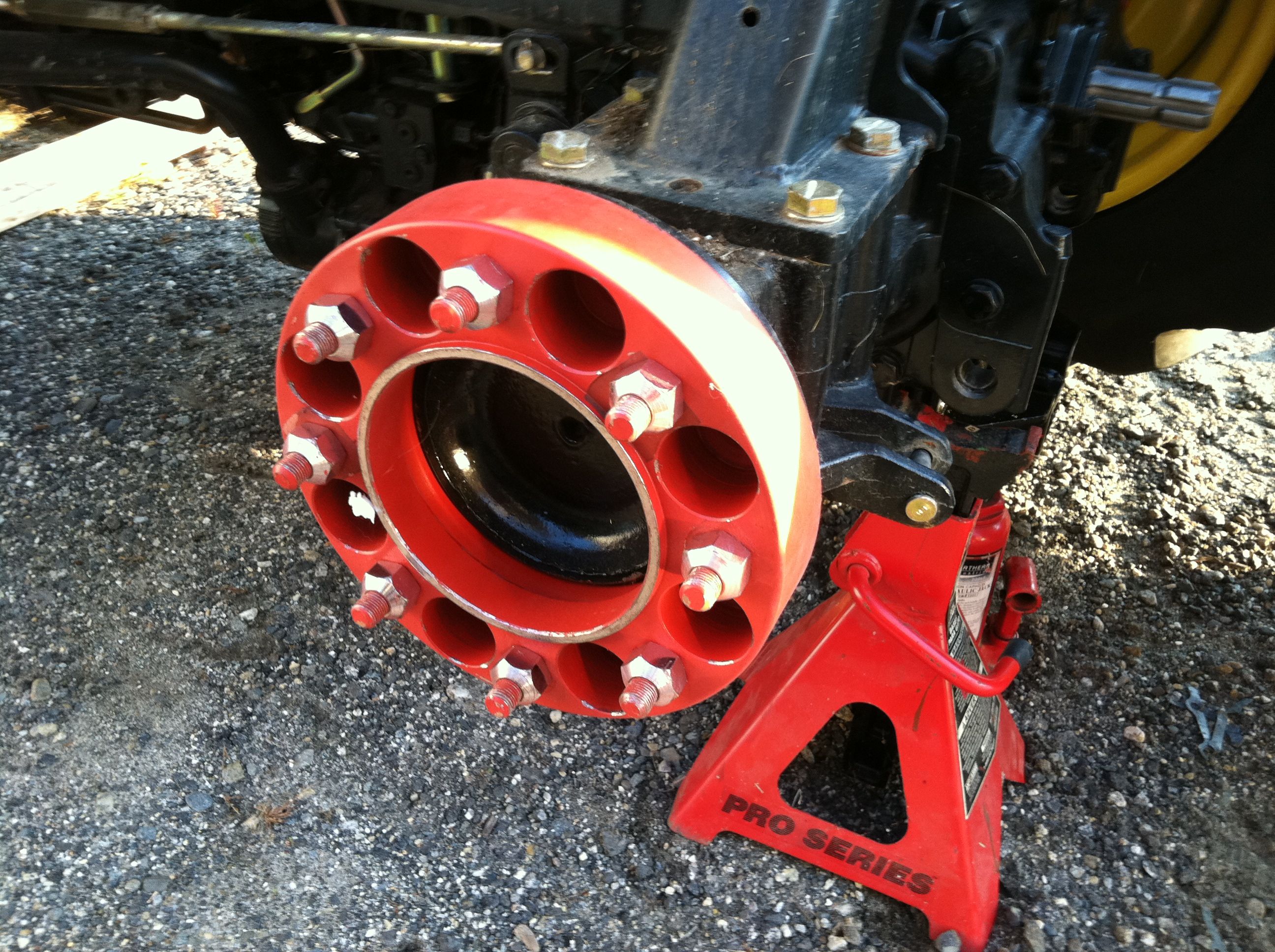

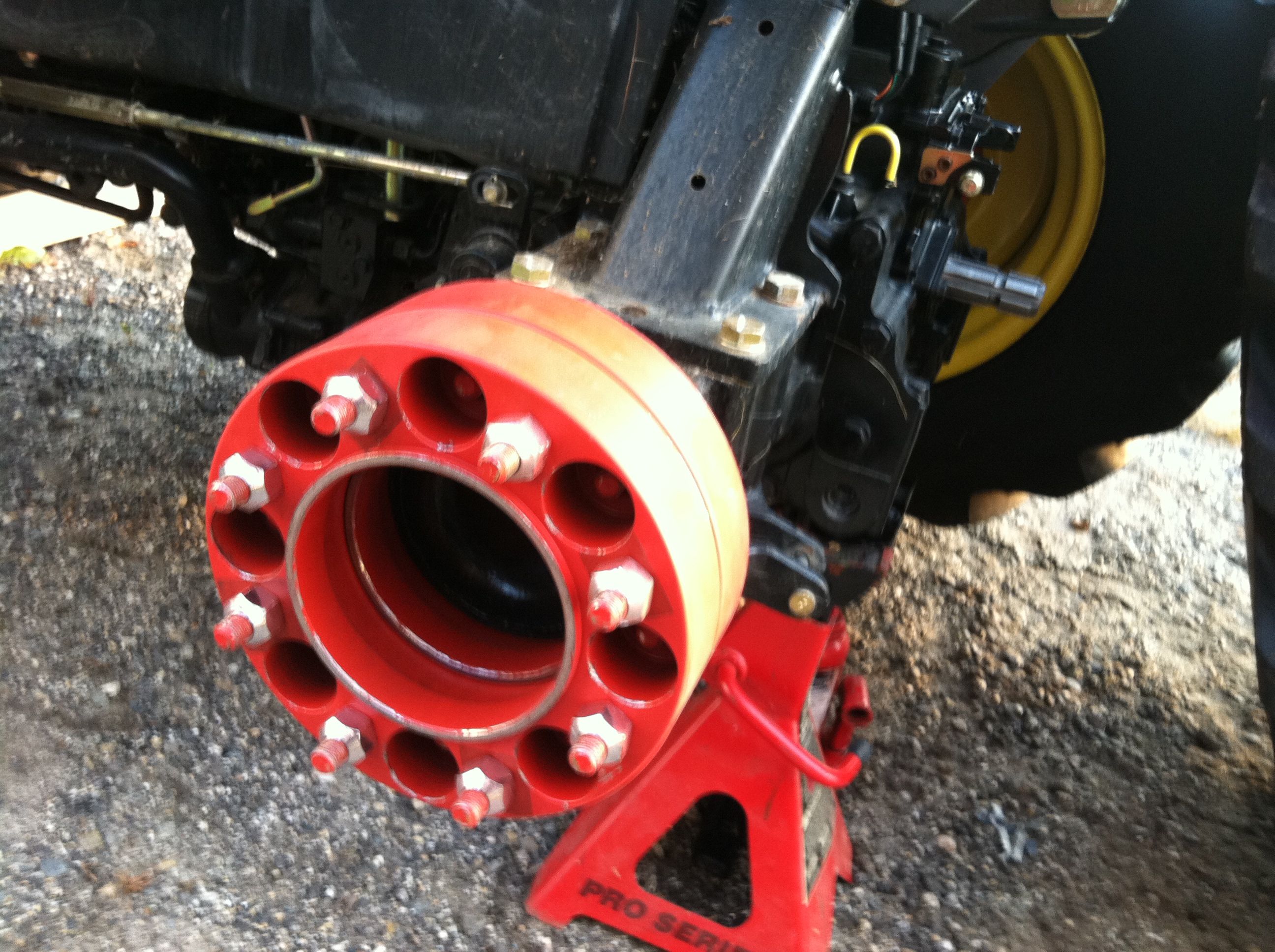

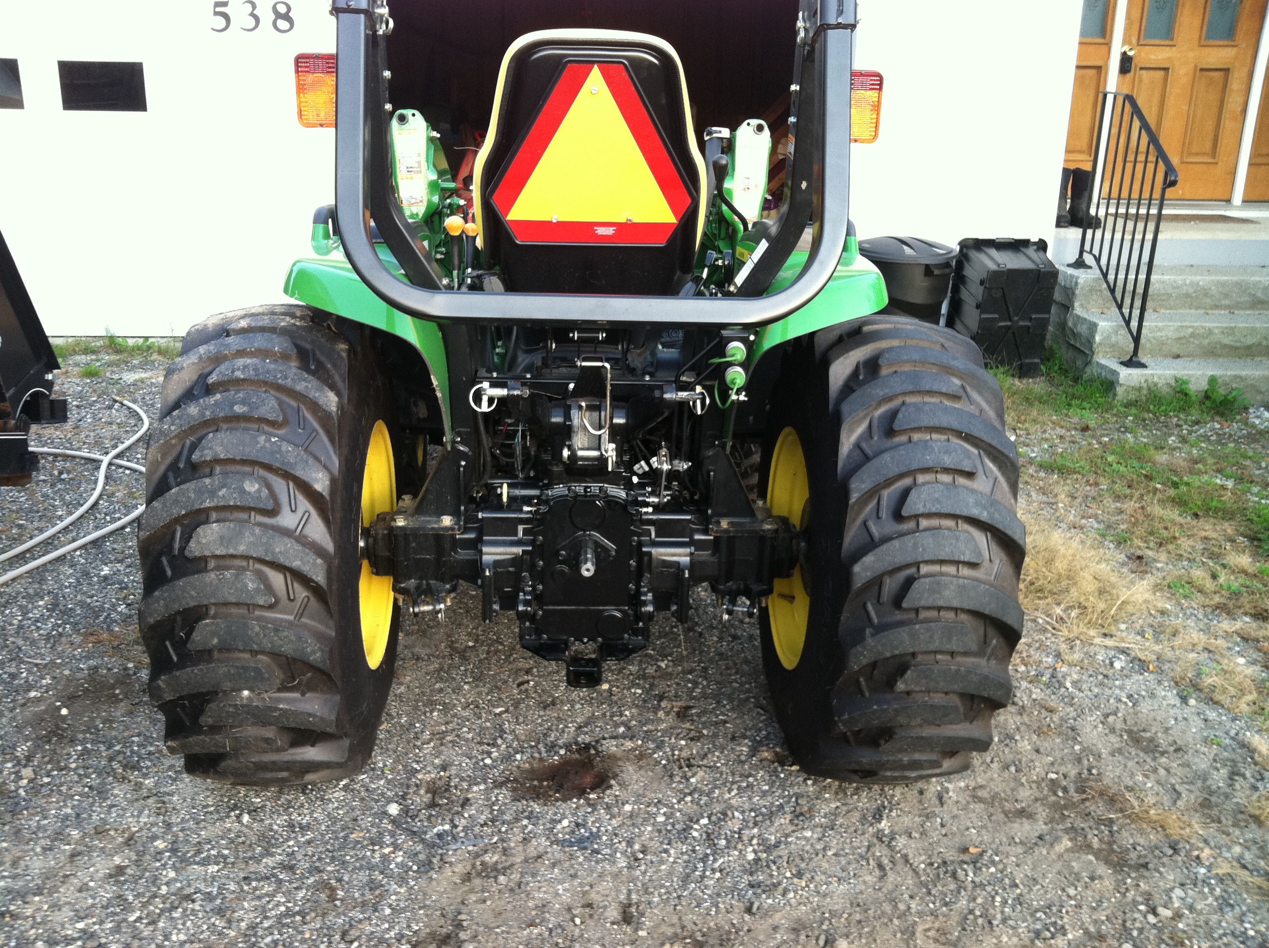

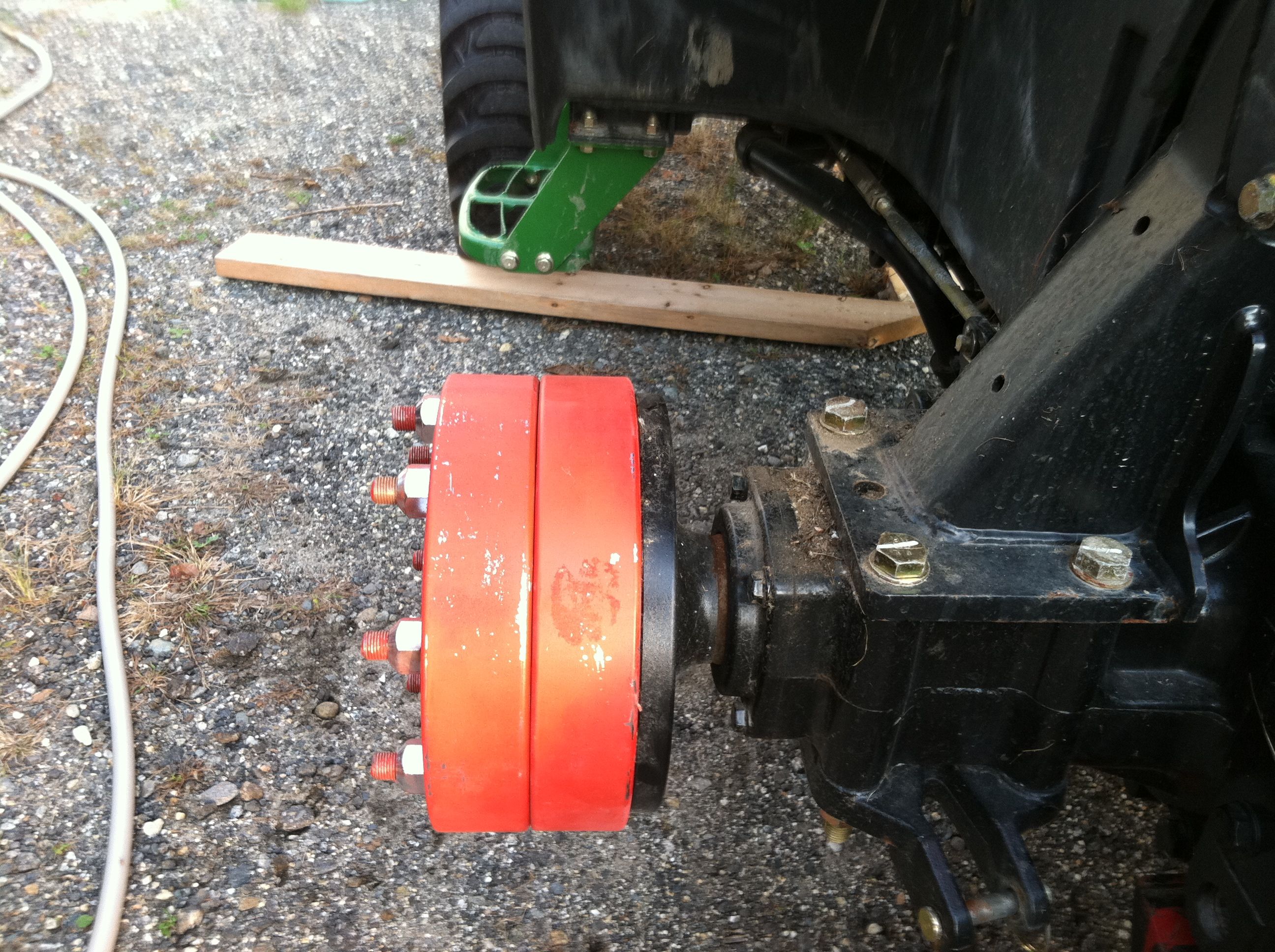

Pictures of 8" of increased track:

Fuse, if you look at his pics a bit closer, you'll see he has two 2" spacers installed per side and his wheels are reversed (note the valve stems are inside).
Using one 2" spacer (per side) and reversing the wheel would result in about 4" per side (that is, 2" for the spacer and 2" for the reversed wheel), 8" overall.
Just using one 2" spacer, with those wheels set in the normal (valve stems out) position would give you and I the 4" extra we're looking for.
