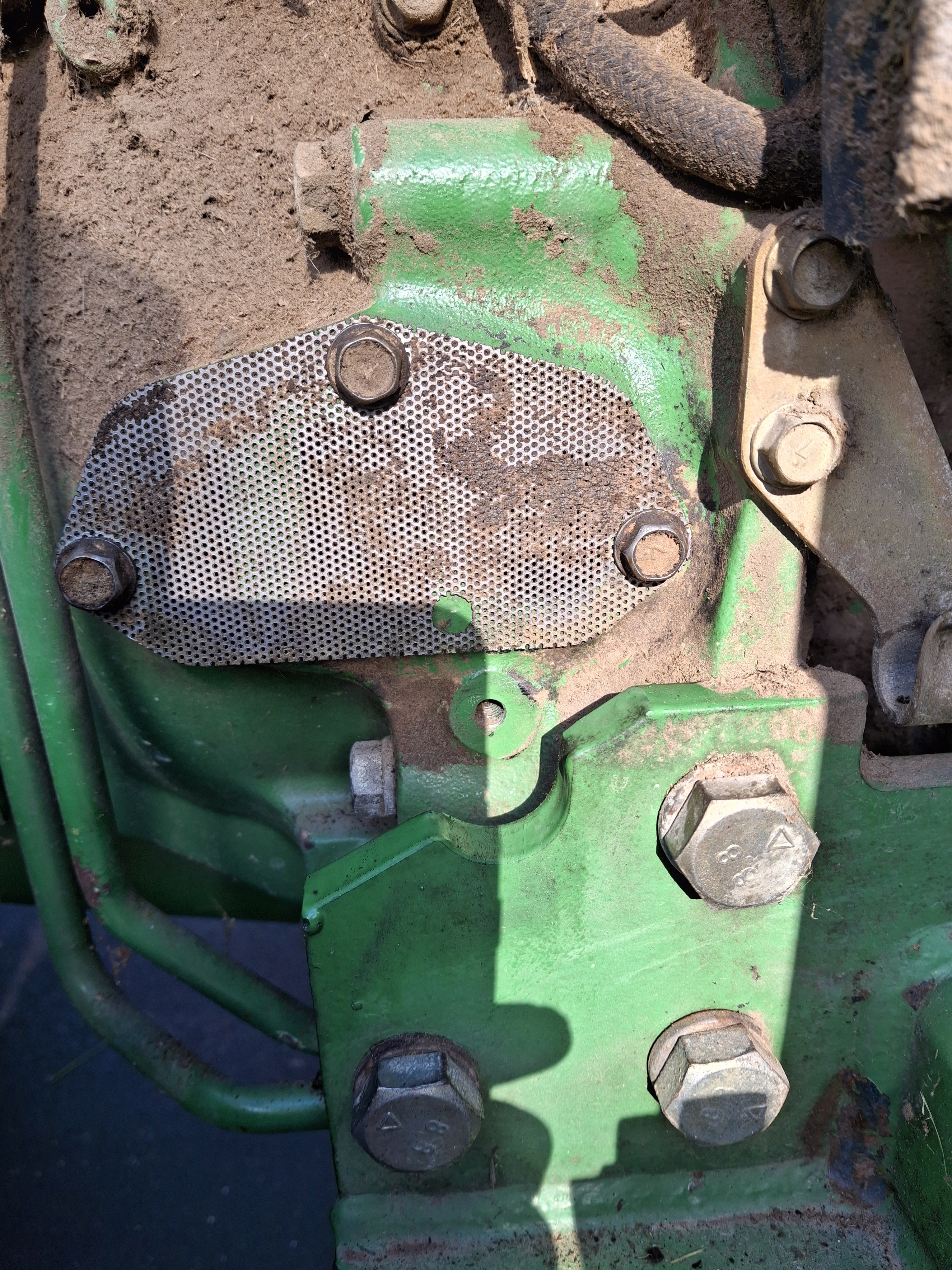

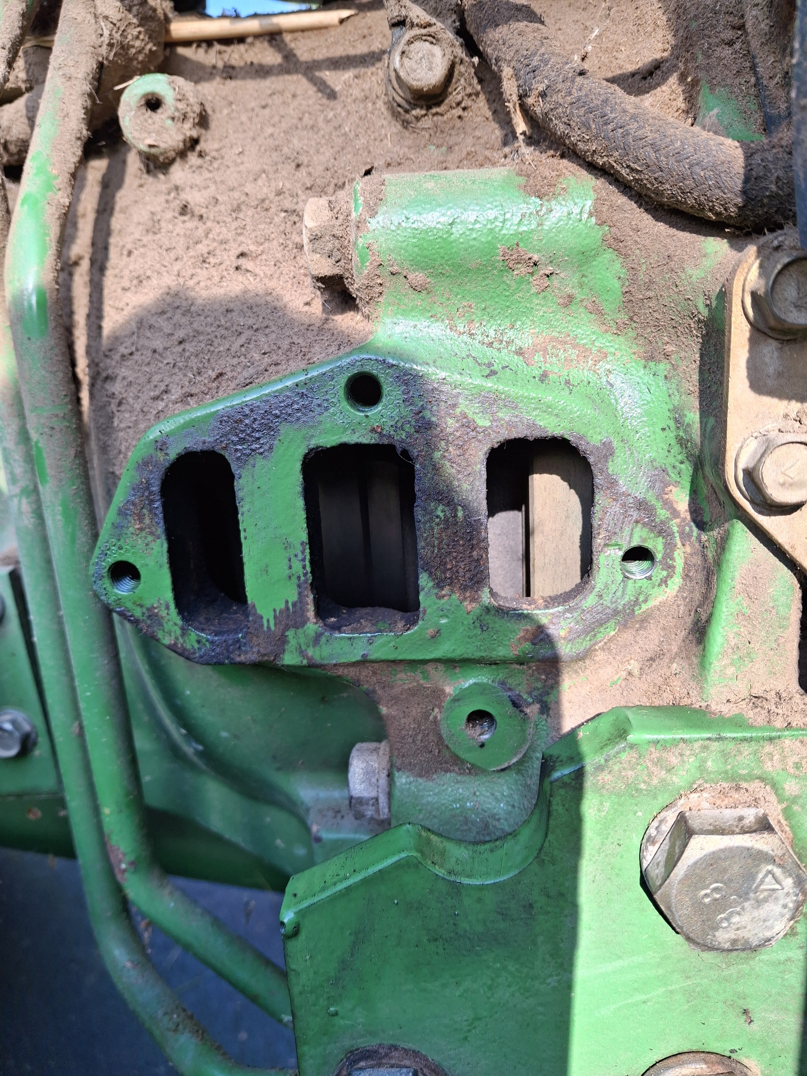

What I tried: I've used the manual and made the suggested "free to the top" clutch adjustment, Which I assume means the amount of play in the clutch before resistance. But that didn't seem to help. As for the post up above, I reached out to @Robfnk about how he did the PTO adjustment. He gave me some pointers but suggested contacting someone as to the steps how, because there may be a better way to rotate and identify the bolts needing adjusted. The pictures attached I believe are where adjustments need to be made, And the bolt(s) gap .06.

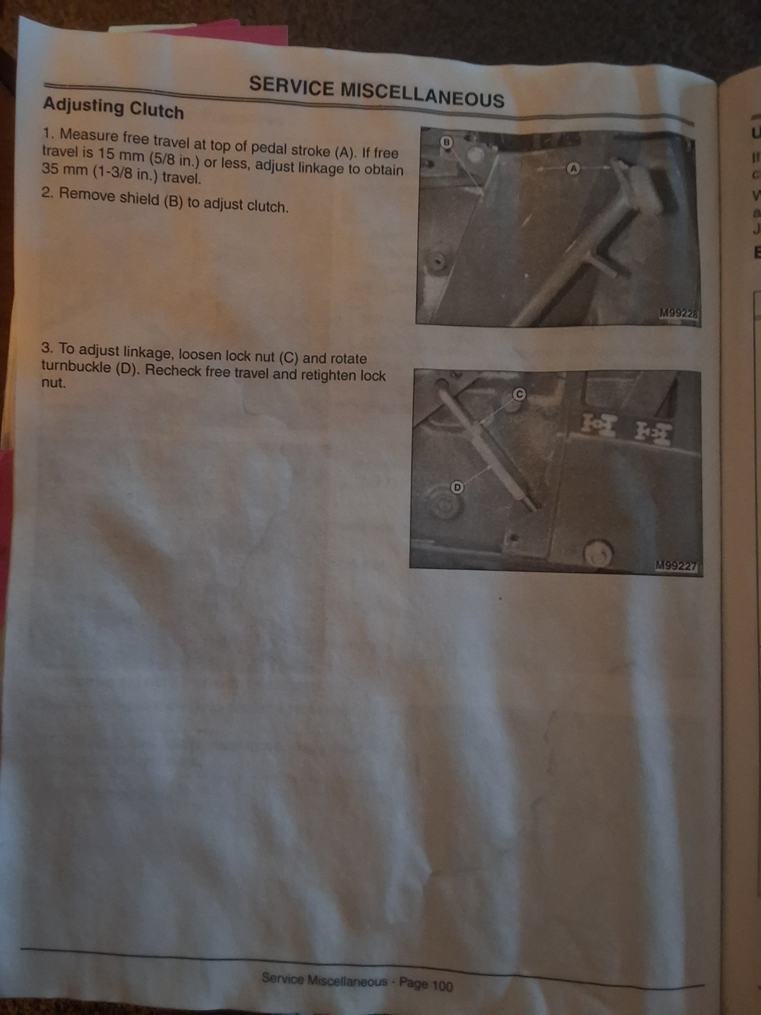

@beenthere Thanks for the video I did watch that video but I felt that it contradicted the manual and literally says quite the opposite. So I did attach a pic of the manual as you requested. I should say the manual gives specifications on both the two and four-wheel drive tractor. This is the only section I know of that addresses the clutch adjustment.

The pics you posted in the opening post are the openings that I believe you need to go through to adjust the two clutches.
You should poke around until you find the manual (not likely in the operators manual, but the service tech manual) or a video that discusses the clutch adjustment, and not just the pedal adjustment.

@beenthere I've been reading the technical manual and this adjustment falls in line with the video (see attachment).

I made adjustments according to the technical manual from a range of 5/8 to 7/8. I engaged the PTO with a slight grind noise which was less than before and released the pedal and it would spin. However when I depress the clutch pedal fully the PTO remains spinning. Additionally I still can't engage the PTO with an implement attached, only when there's no Implement attached.

Post a link to it here if you can. Maybe we can lead you from there. You get at the adjustment nuts through the port holes shown in your first post. You have to rotate the flywheel/engine to get at the three adjustment points.
