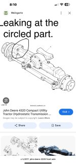

I have a 2010-2011 John Deere 4320 with a small leak on the front axle. It’s not down by the wheel, seems to be leaking where the front knuckle (not sure if that’s what it’s called) bolts to the axle with the 4 bolts. I talked to the tech at John Deere and he says there isn’t a gasket just rtv. Does anyone know if I take those 4 bolts that hold it on will it slide out so I can clean and re apply rtv sealant. Thanks for any help and also sorry if I posted this in the wrong section.
