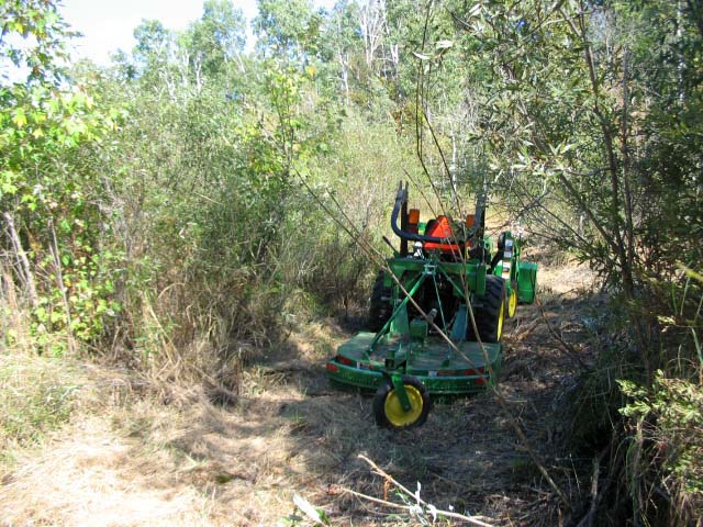

Picture is of an LX4 behind a 4110, second pass in project to clear 1 acre or so. Lots of brush, swamp maple clusters & alders (see 10 footer maple to left in pic). It was an adequate set up---more power would have been good, as I bogged/stalled a few times (going real slow, not a full bite on the clumps). 4 foot was a match for tractor in this particular app. Had a bunch of full size trees to get between & around too, so beside the power issue, smaller equated to more maneuverable. Good luck

al3, you really oughta have that ROPS up, especially when brush cutting.

Efreet: Went with a Speedco. Knew I was going to weld chain boxes to the QH, so adding Green paint wasn't a problem. Regardless of brands, a QH certainly makes life a lot easier. I routinely drop my ballast box to either skid logs or do some blade work--don't need to leave the seat. The Speedco mates to the LX with no mods. It didn't work with an older Brushhog brand without the upper link "H" adapter. Good Luck---al
