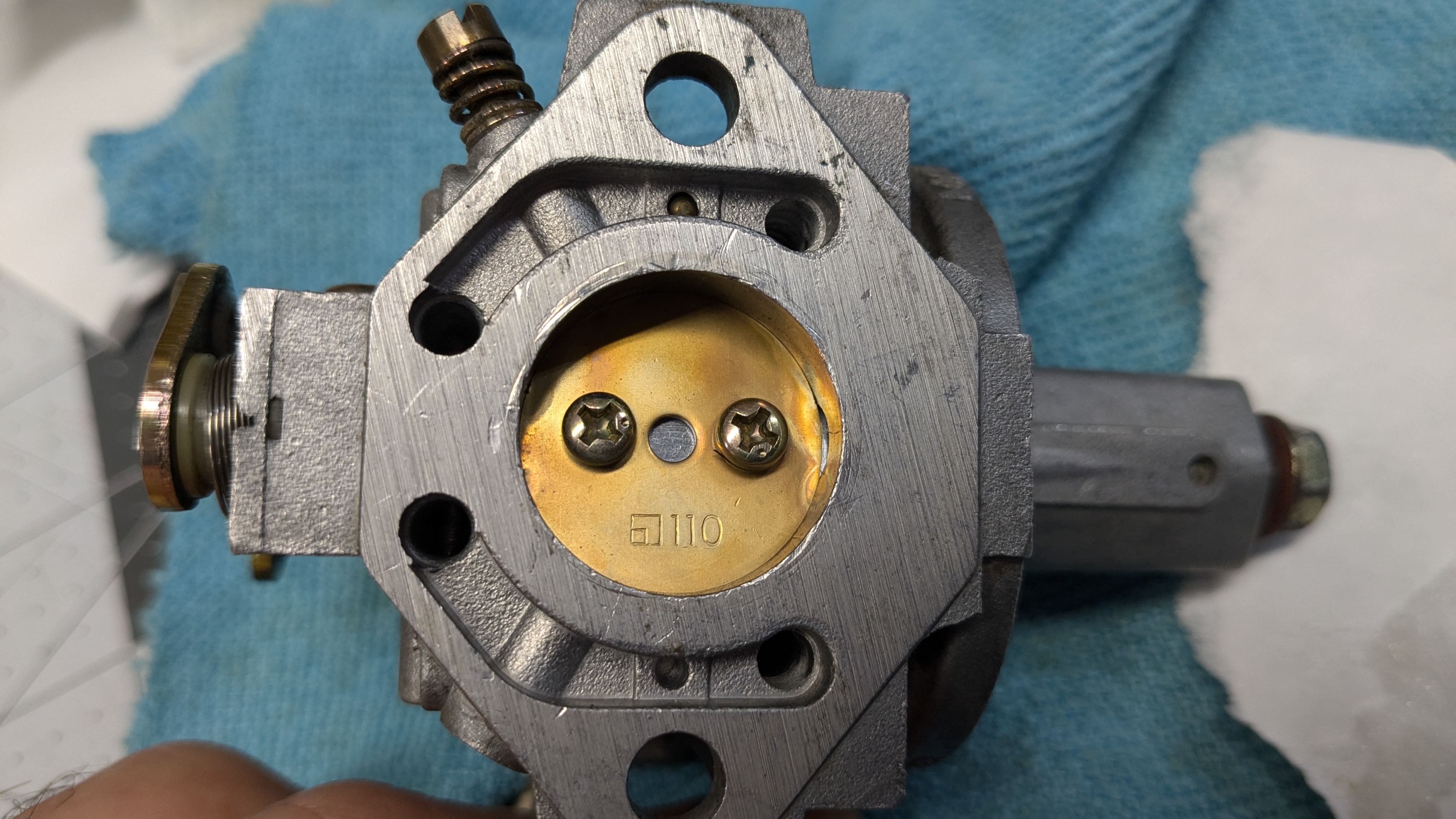

I have 2 JD 130s. I believe one is an'86 and the other is an '88. I have been beating up the '86 for years. I picked up the '88 for parts, specifically for the mower deck and seat. I am looking to possibly try to rehab the '88, but am having trouble finding parts. Whenever I search for JD 130 parts, 90% of the links are for newer, lettered 130s, like D130.
I have been searching for an inexpensive carburetor for the FC290V, 9hp Kawasaki but all of the ones that come up have the gas line on the opposite side. They say they are for an FC290V, but on different JD models.
I have searched for JD 130 here, but haven't found anything. Could someone point me in the right direction to help me get started?

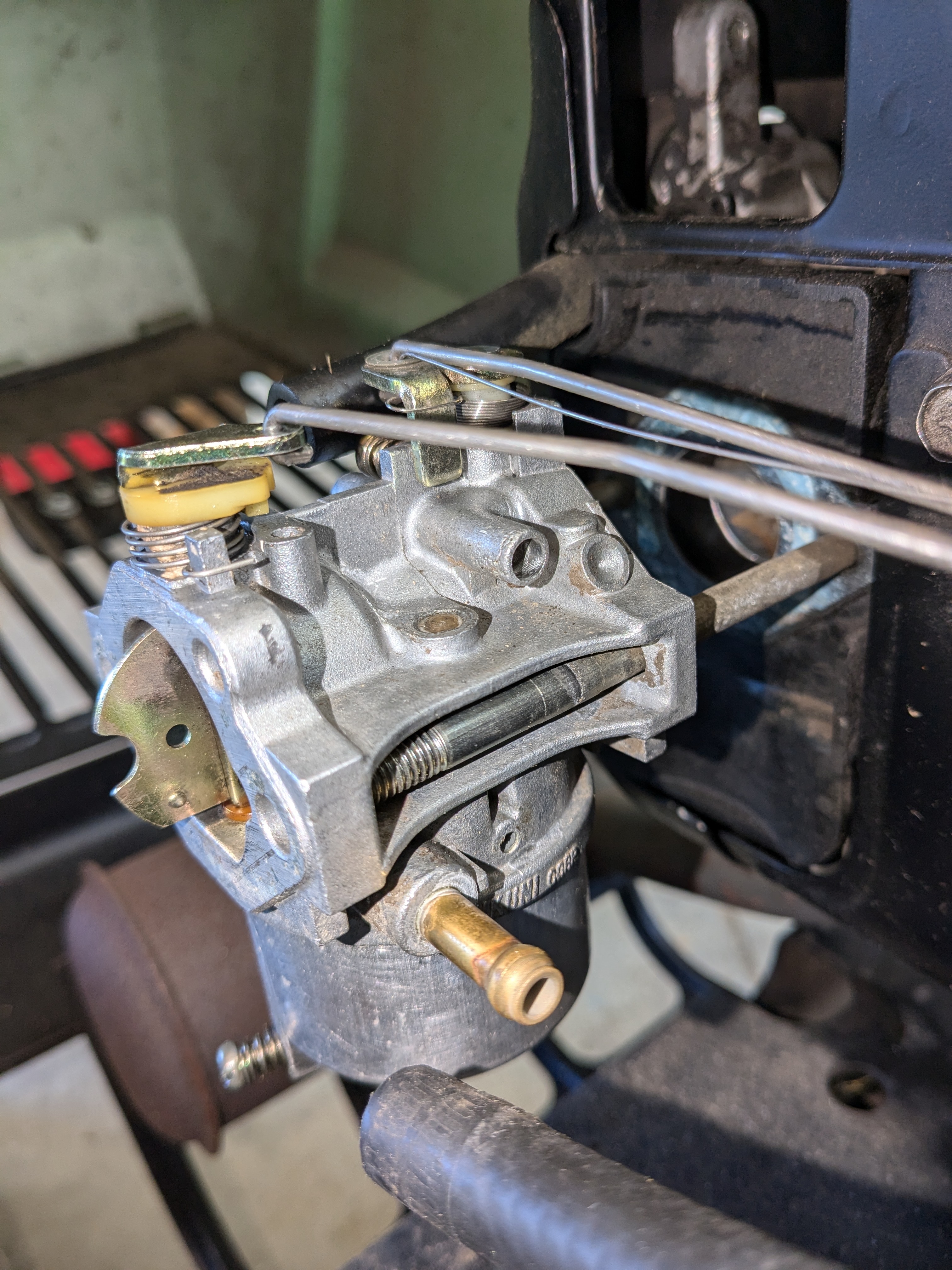

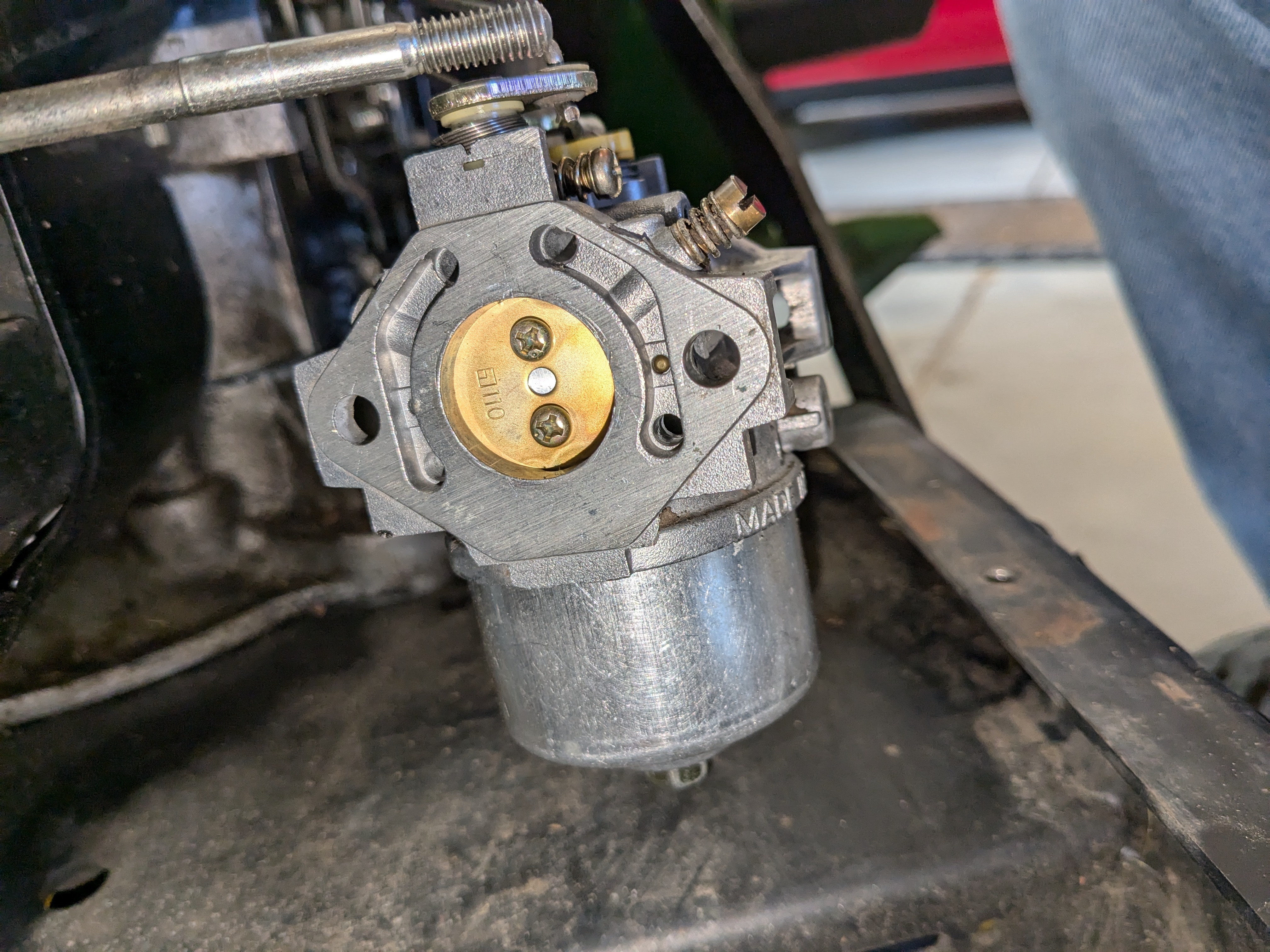

Can you post a photo of the carb. That will help us when we look for one for you.
Interesting the you are seeing the carb with the fuel supply line on the wrong side.

Look closely at the carb. There should be a part number or model number on it and perhaps also the Mfg's name.
Good photos.

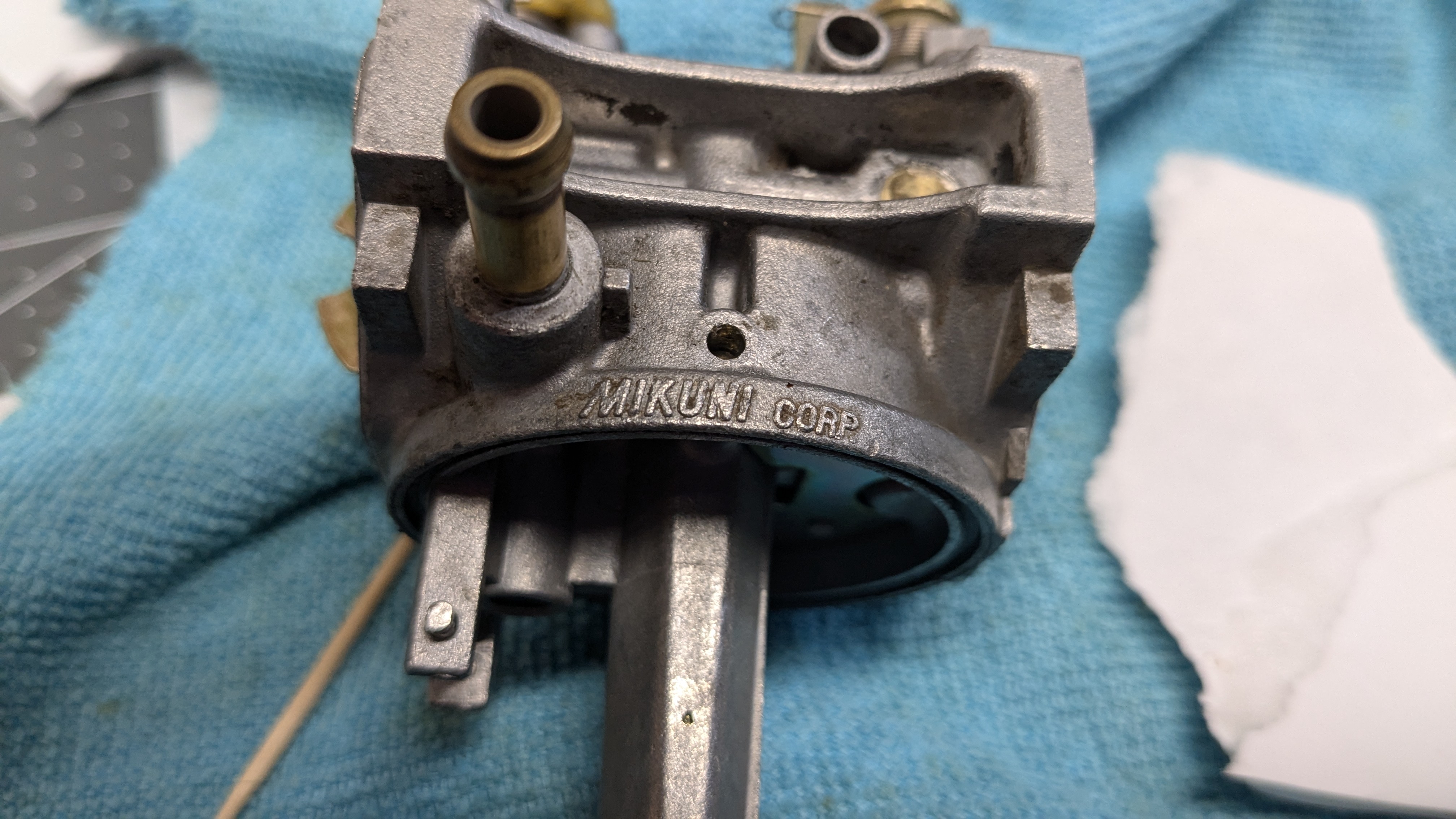

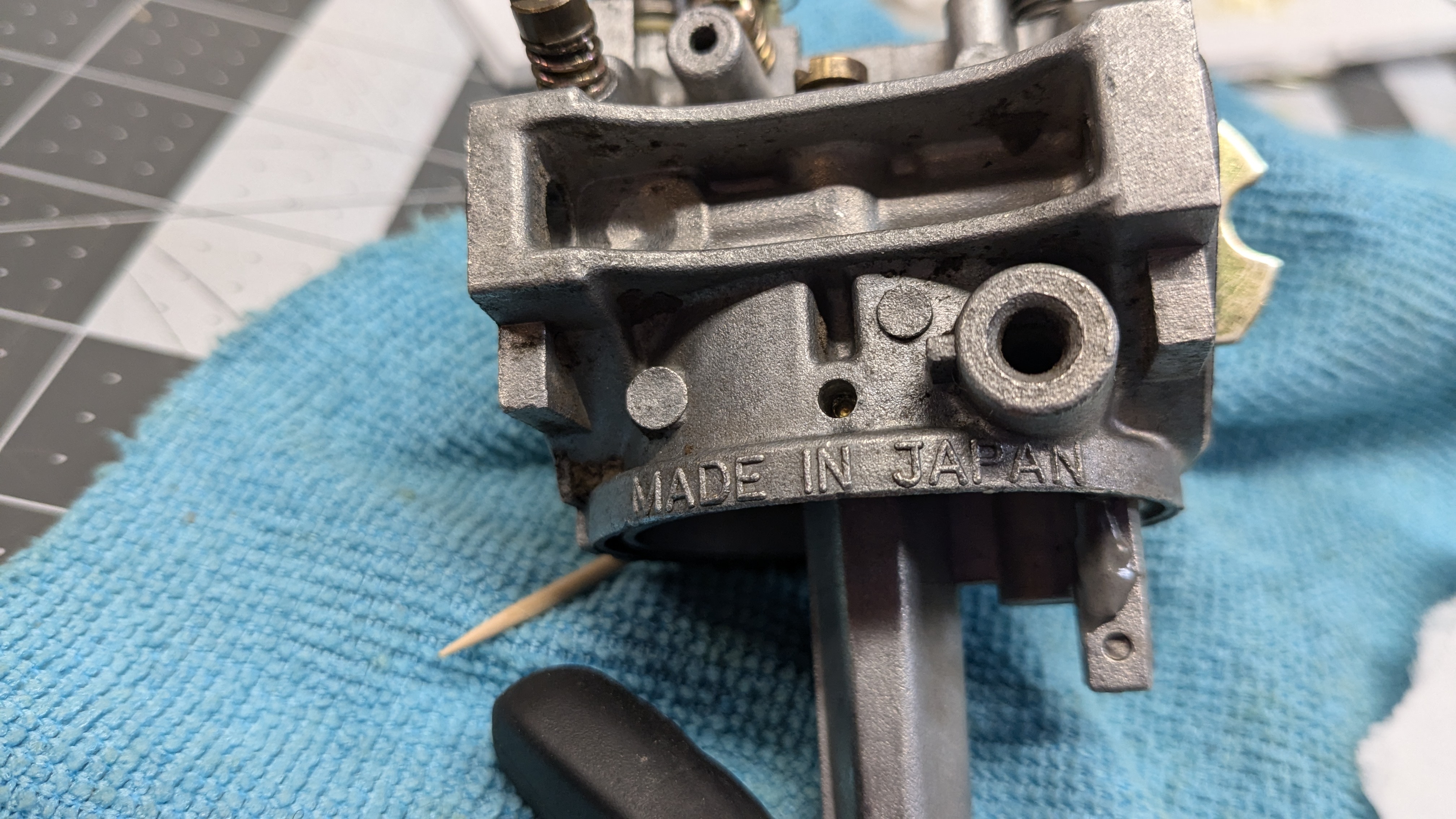

These are the only markings I can find on the carburetor.
/ JD 130 parts question #6
Well there should have/could have been some part numbers on there, but no.
So the search goes on.

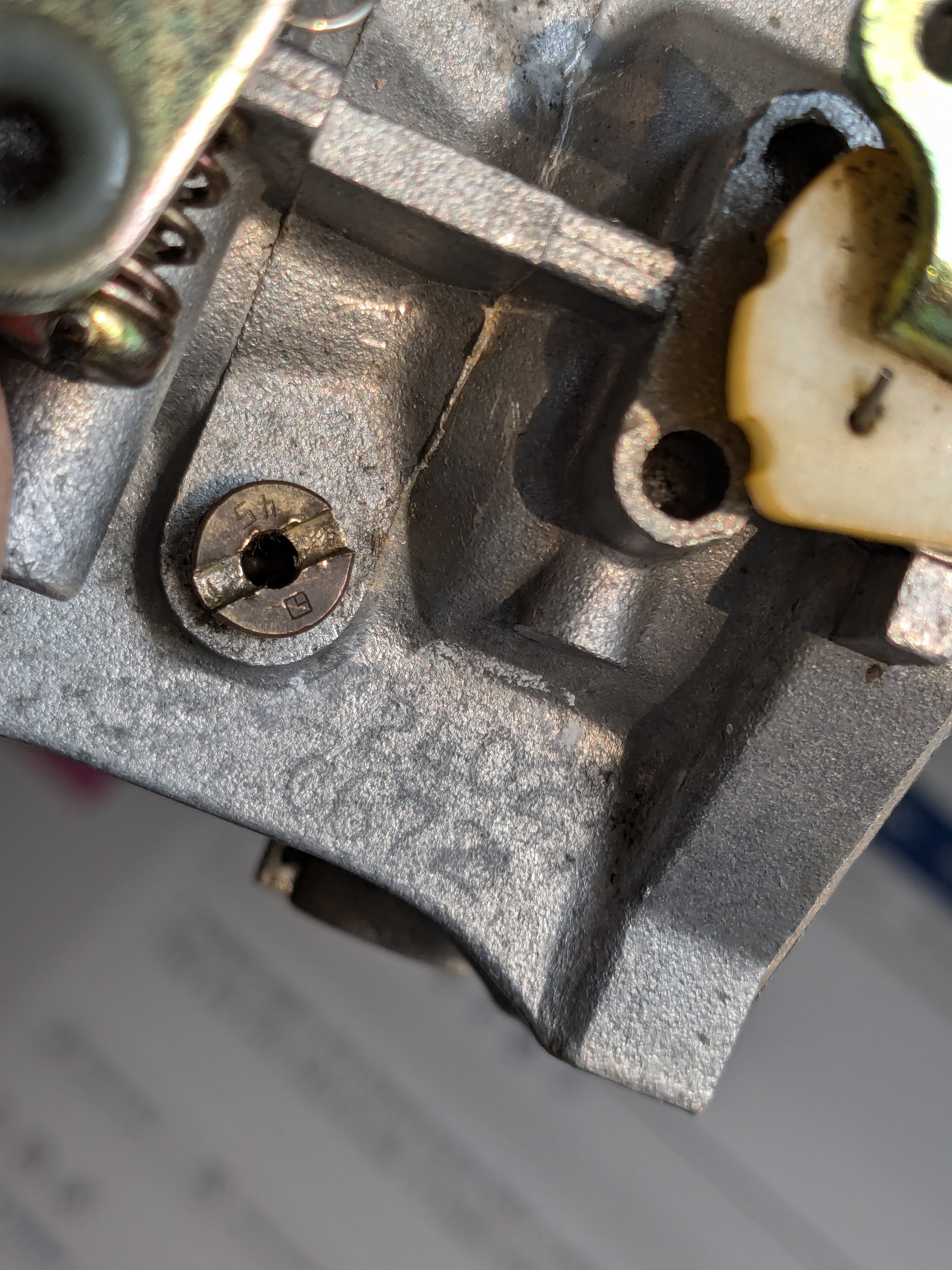

I looked again and found some faint numbers!
They are very hard to see. It looks like I2402 c672 or 12402 c672

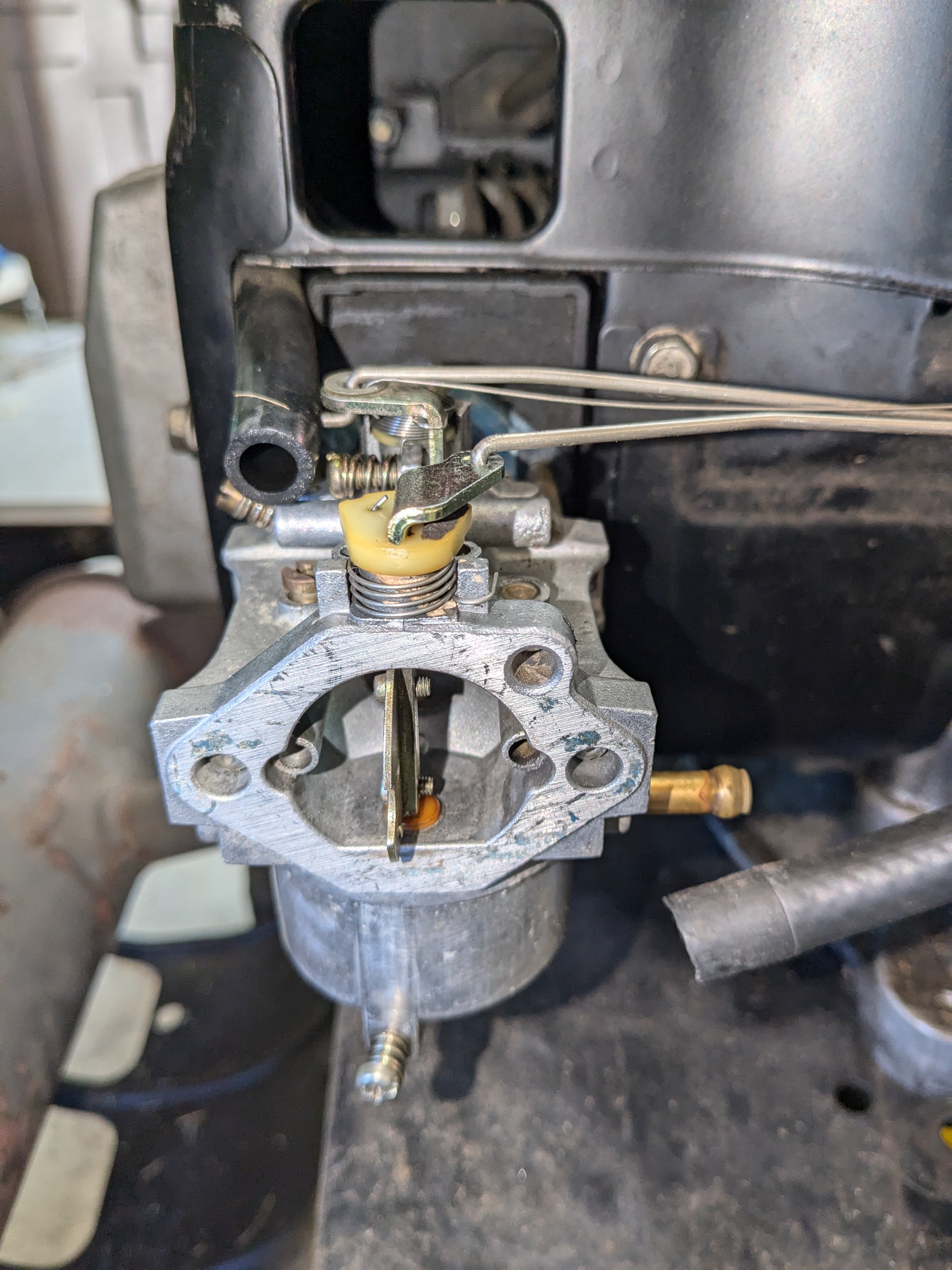

OK a couple of questions.
1. why not just clean and use the carb you have ?
2. is there room on the other side of where the carb is mounted to use one of the carbs that you found that have the fuel port on the opposite side from what your current carb has ?

1. Great question! That is what I was trying to do when I broke one of the float valve pillars.😄 I got it all cleaned up and used some JB Weld to fix the pillar. I put it back together this morning and got it to fire up for a few seconds and that was it. When I brought it home, it fired up once and was revving at super high rpms. Then the PTO fell off and that was it. I thought a $30 carb would be the easiest thing to try. I think I am in over my head.
2. There would be room to run the fuel line to the other side of the carb but I am not sure if the other connections would line up.
Could anyone direct me to information on how to adjust the carb to get it started? The last carburetor I worked on was on my '64 TR4 in 1970.
