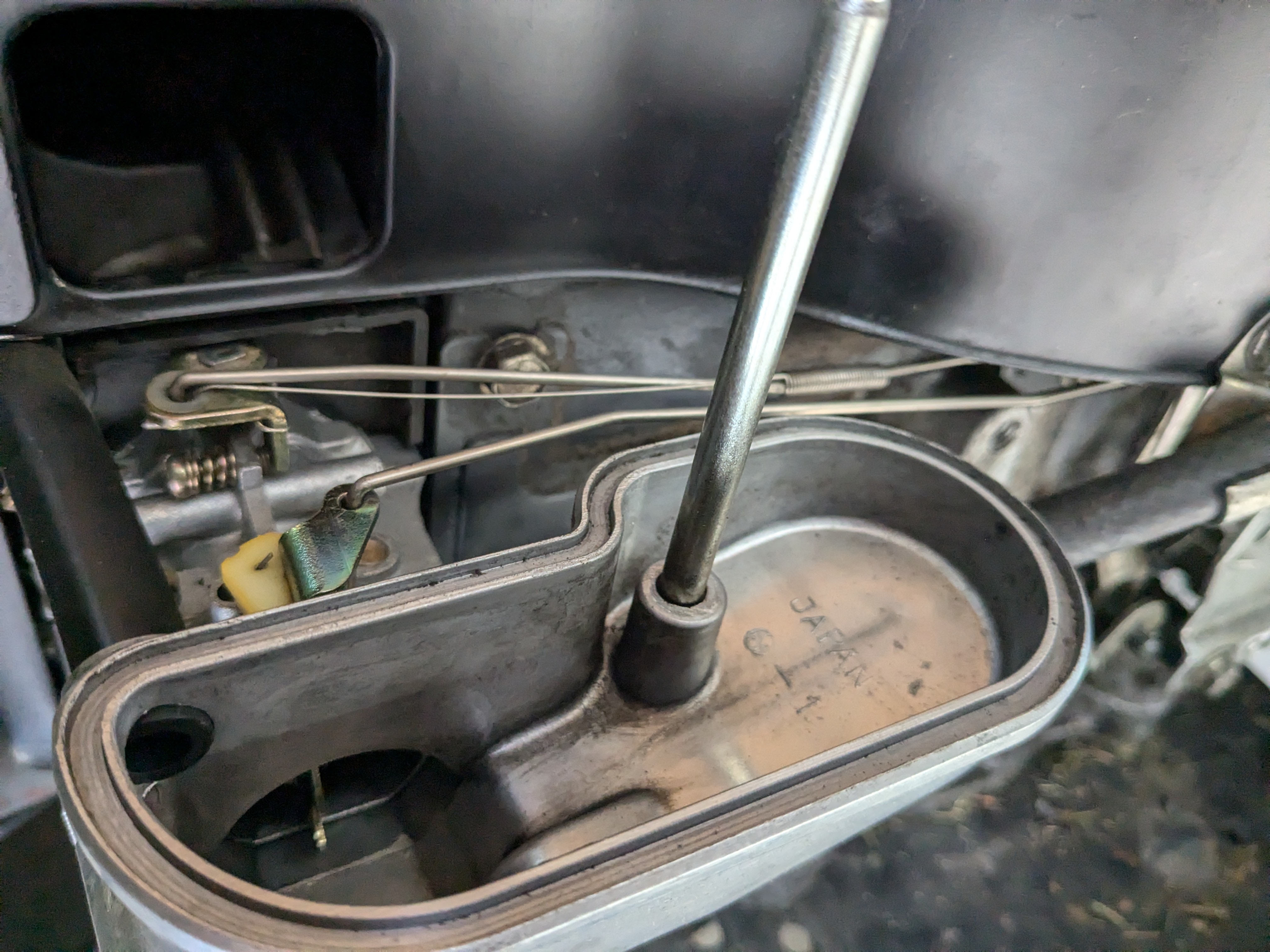

I got it running! It idles nicely. but the smallest bit of throttle cranks it up way too fast.
I believe I have the Choke and throttle hooked up correctly.
   / JD 130 parts question #13
You will have to check out the governor linkage and arm adjustment.

I've got the engine running pretty well. I found that I had a weak spark, so I tested the Electronic Ignition Module and it was way out of spec. I got a new one for $3.99 on Amazon and installed it along with a new plug. I also got some gasket material and replaced the carb gaskets. I was also able to adjust the the governor so it spools up nicely now.

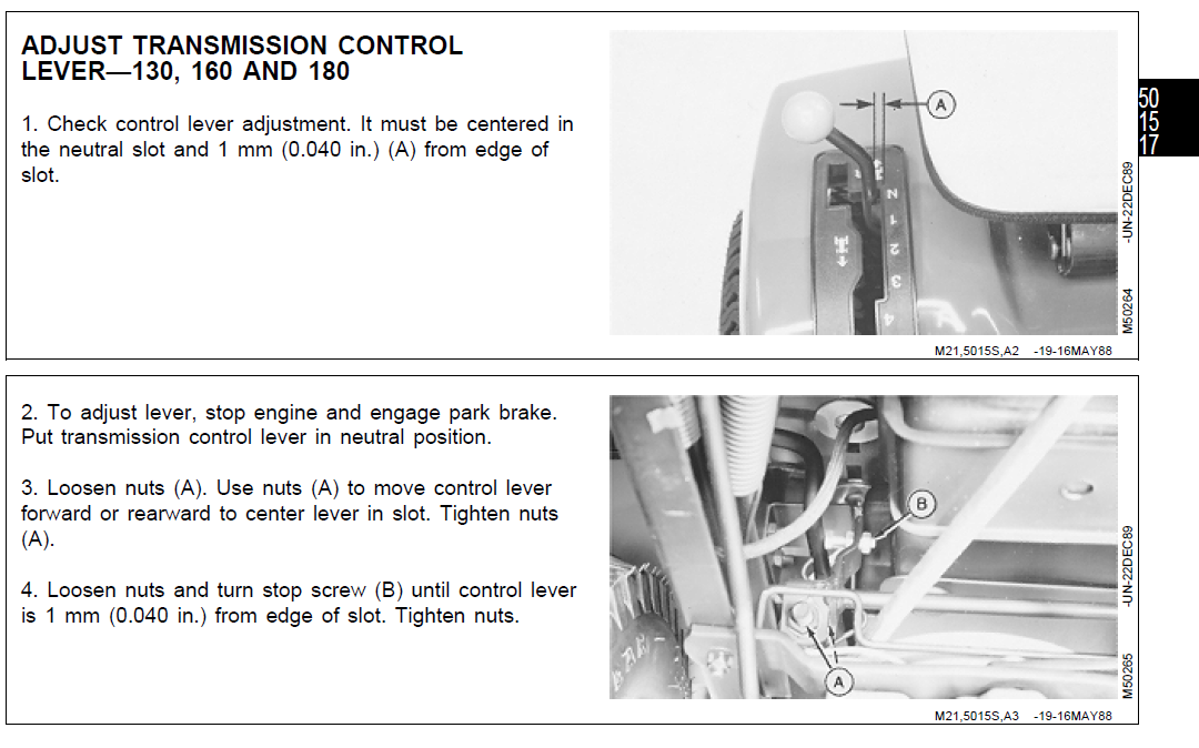

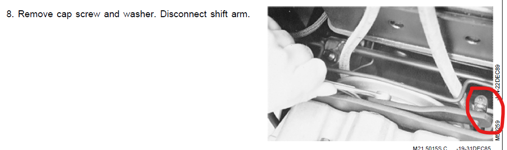

OK, Now we're cooking! I got the PTO back on and was able to drive the tractor around. THe shifting was pretty sloppy. The shift doesn't always line up with the gear indicator. Sometimes I have to shift to the reverse position to get into neutral. Then when I can get it into reverse, it will slip back to neutral. Any hints on what to look at to tighten it up?
   / JD 130 parts question #20
Look at the manual, there are instructions on how to adjust the shifter.
One thing you might want to check is this nut holding the shift rod to the shift lever, make sure it is tight:
See the circled bolt.
Here are the instructions for adjusting the shift linkage from the manual:
