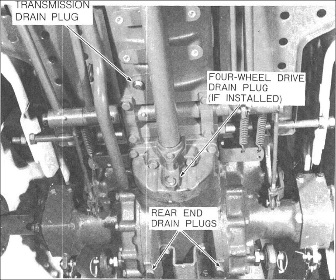

I've had my 1986 Ford 1310 4x4 for about 28 years and would just like to mention something I learned about it's transmission oil drains:
Mine has four "transmission" oil drains and uses the same oil for transmission, hydraulics, steering & the rear end gears.
In my experience if there are several drain plugs, all of them should be opened & drained at about the same time if possible, because there is bound to be some fine metal sitting in those low spots and I wanted it out!
There could be enough fine metal to block the drain, depending whether they have been previously opened or not?
It may even take a poke with screwdriver to get a flow...
JD 650 may have a different drain(s), but I think it's worth checking it out before opening any drains.

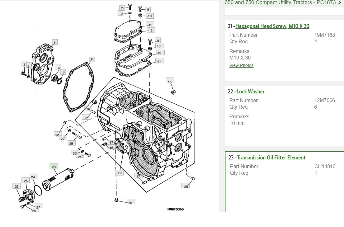

from JD parts
Filter element key #23 in attached file
Is that transmission filter cleanable, or does it have to be replaced? I found that the John Deere website has them cheaper than EBay and Amazon, seems like a lot of money for a throw away filter. I’m not sure so thought I’d ask before dropping the money to buy a new one.
The hydraulic screen mesh filter is re-usable and cleanable. A gallon of diesel and a soft toothbrush typically.
