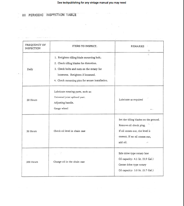

This should help you with your rotovator as well:

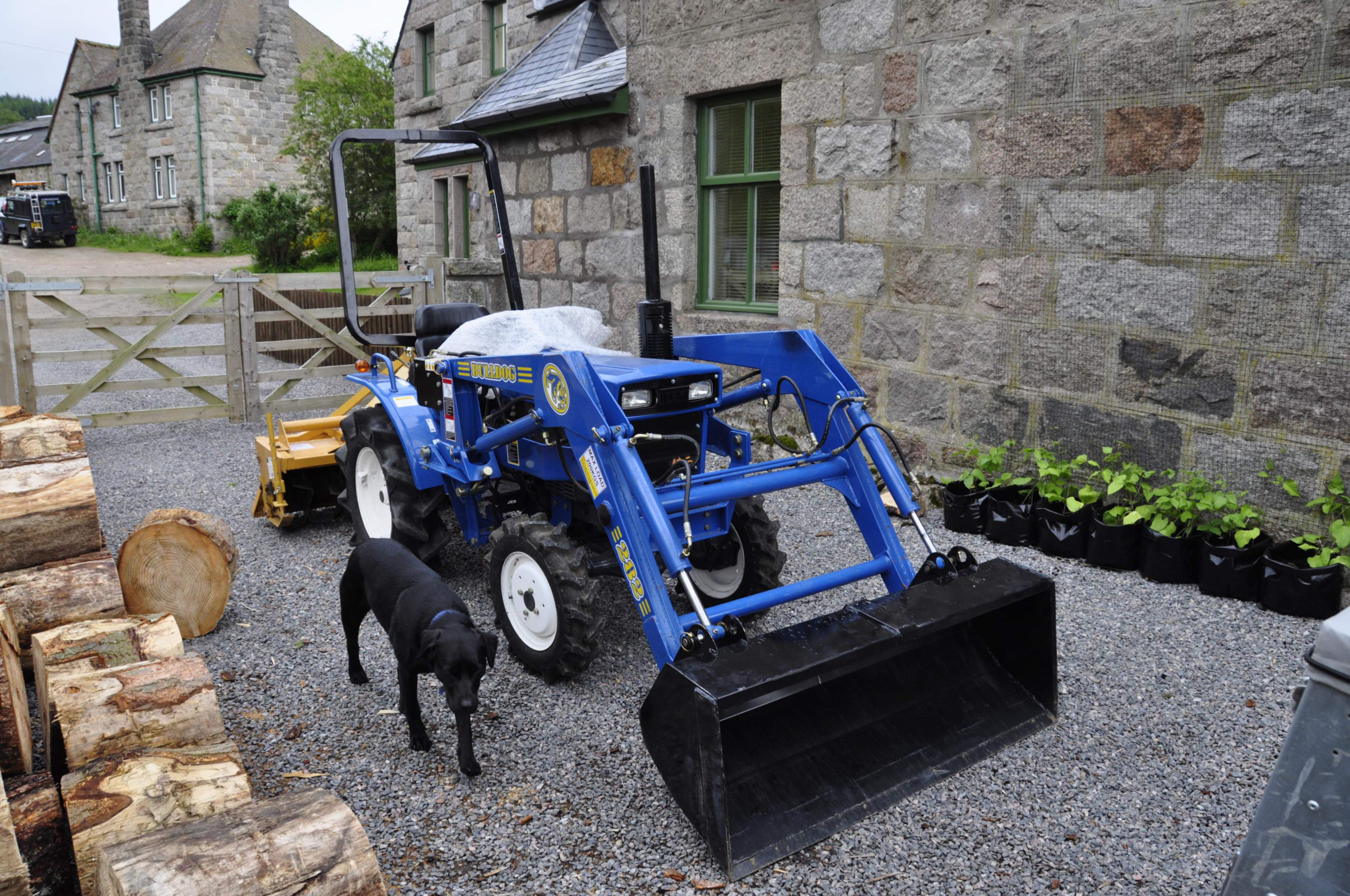

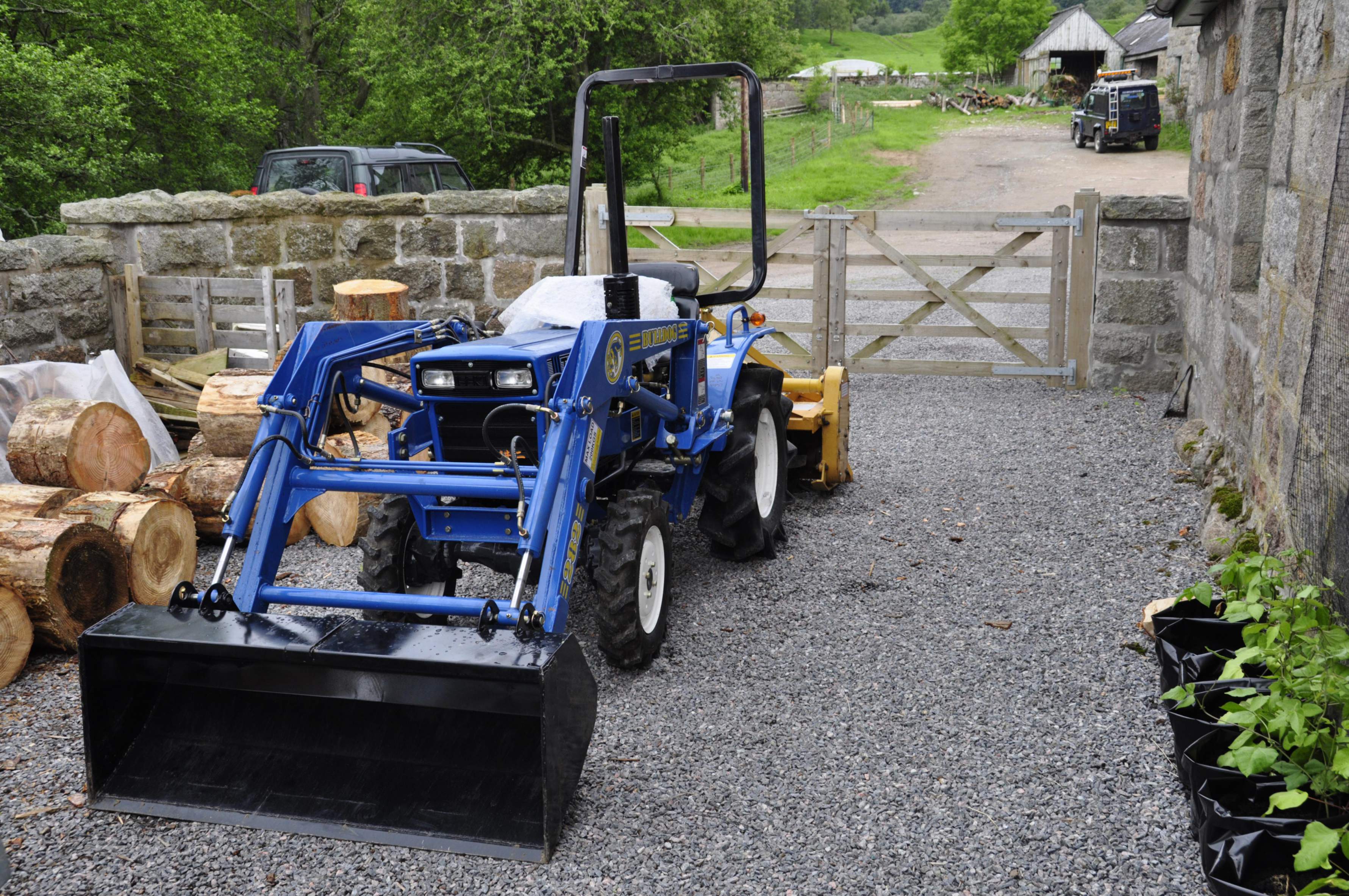

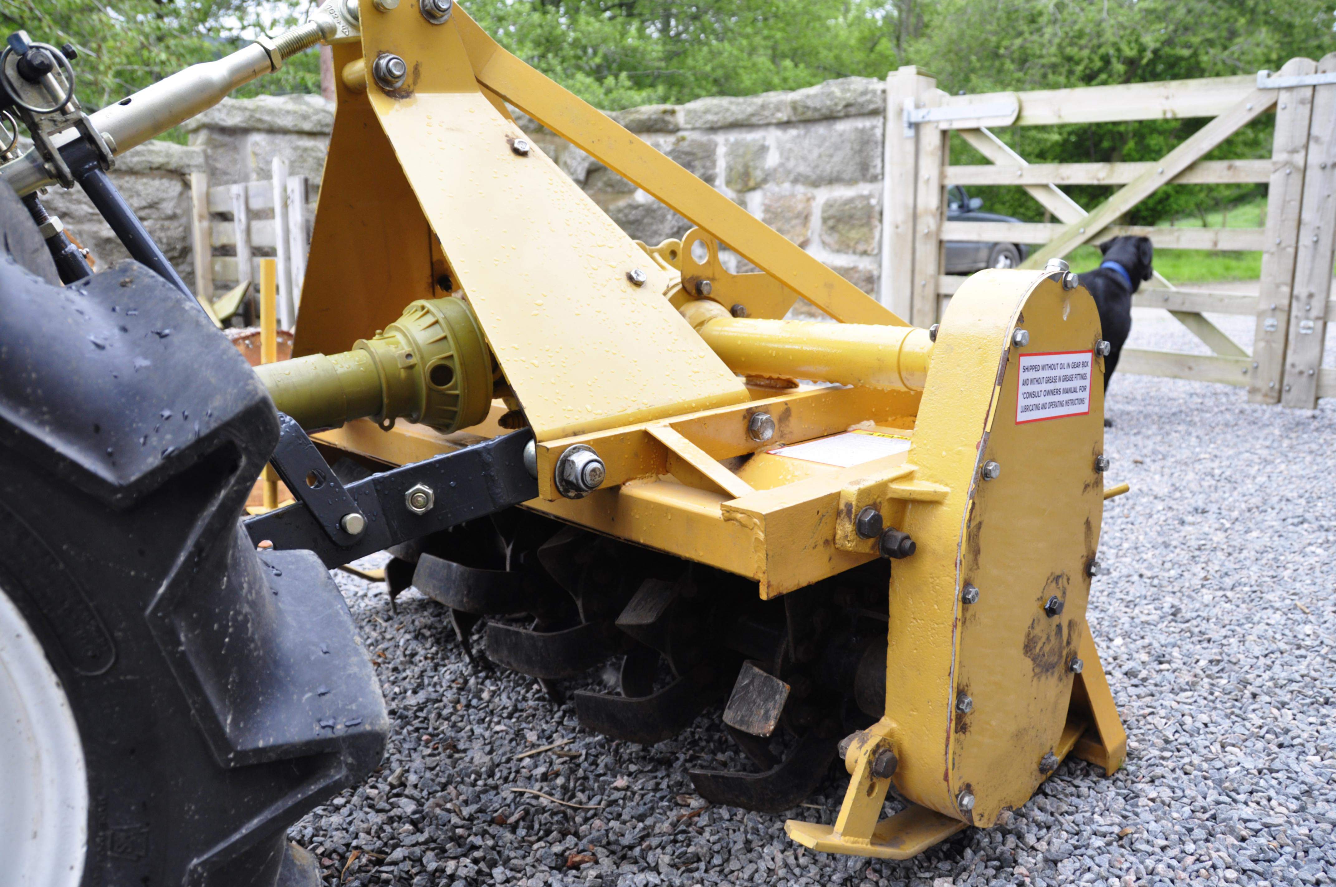

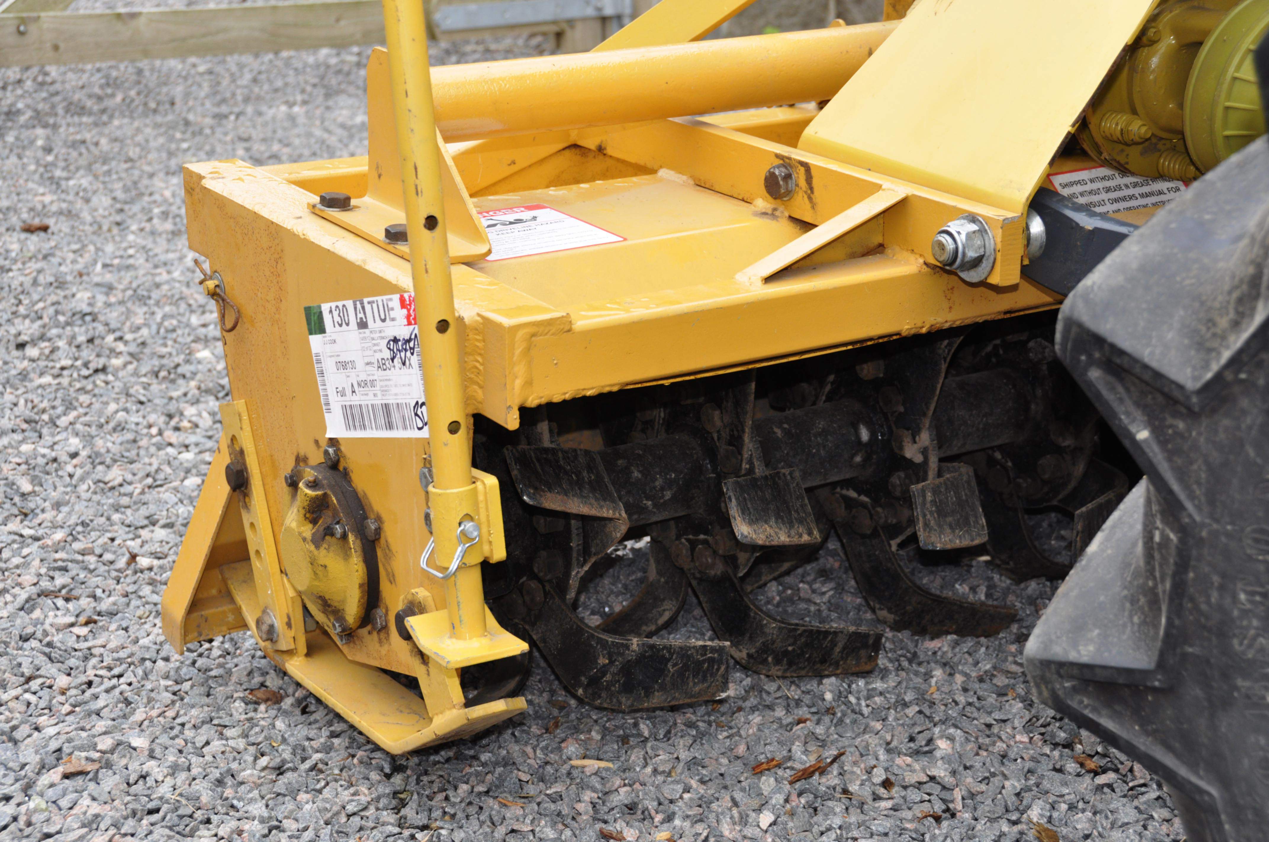

Used it yesterday for the first time with the rotavator wish we had got one years ago!!

I spot a LandRover as well .. :)

Thats a very sharp looking tractor! I am jealous, you have received a very nice setup. I looks like it was completely remanufactured, and you have heavy duty agricultural tires installed as well. I believe that I have found the rotavator, and the manual, listed below. The manual is below is linked to a PDF file on the page, and reads: product manual. Thanks for the photos, and post some more once your start using it around your farm! Glad to hear that it is working out so well! I need to purchase a rotavator myself, however I bought a single plow this year, and used that to turn the garden beds, and then used a hand held, gas powered cultivator. I like the stone walls you have. I wish that I had stone walls similar to that, however ours in New England, are just stacked stone walls around the property from the original settlers around the late 1700's. You may want to considered having your rear tires filled with liquid balast if they are not all ready to counterweight the front end loader when you are carrying a load. Well, great tractor, and enjoy! Please let me know if you need any additional information from the service manual. I would be glad to provide it on here for you.
CountyLineョ 5 ft. All Gear Driven Tiller - 2127109 | Tractor Supply Company

Thanks Mitch just a bit concerned that the rotavator states 25hp and our tractor is only 15 - having said that used it yesterday as i mentioned previously and worked absolutely fine at the lowest PTO speed (540)
