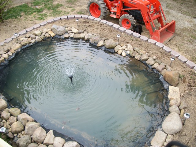

I totally agree that they are not designed to dig but it can be done if you go slow and especially if you use an implement to scarify the soil a bit first. I dug a nice little pond with mine using the scarifiers on my box blade to loosen the soil while at the same time scooping up the previous pass made with the box blade. I don't have any problem digging with my FEL in soft loamy soil or removal of pond sediment from dried up ponds. They work well for that but the sediment really loads the front end on a tractor.

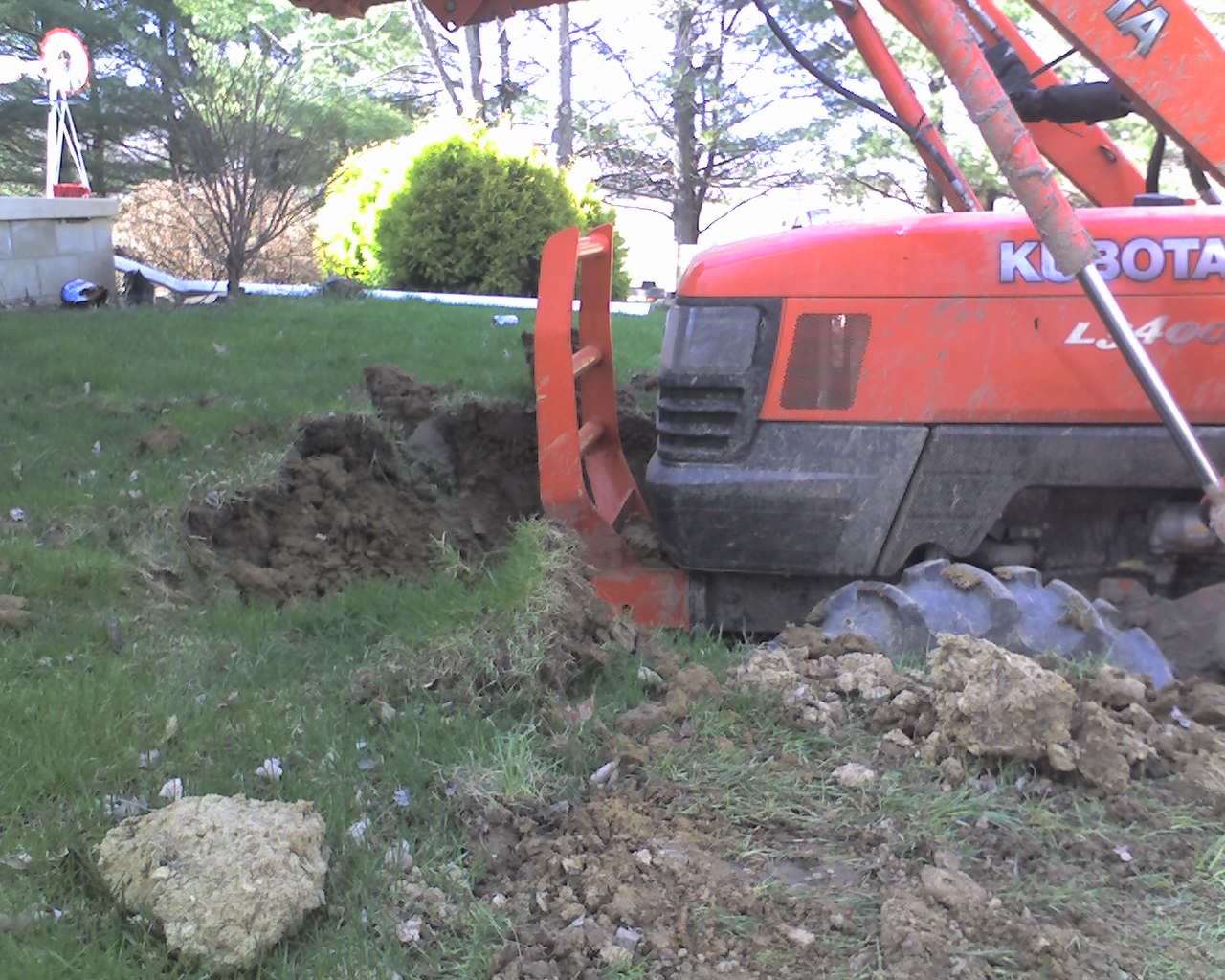

You can dig with the FEL, but it has to be done in a way that doesn't overload the FEL frame.
Basically, you peel off an inch at a time, over and over.
This is easy on the machine, but slow work.
Rocky soil will probably require a tooth bar.
Here's a test pit 6' wide and 4' deep:
