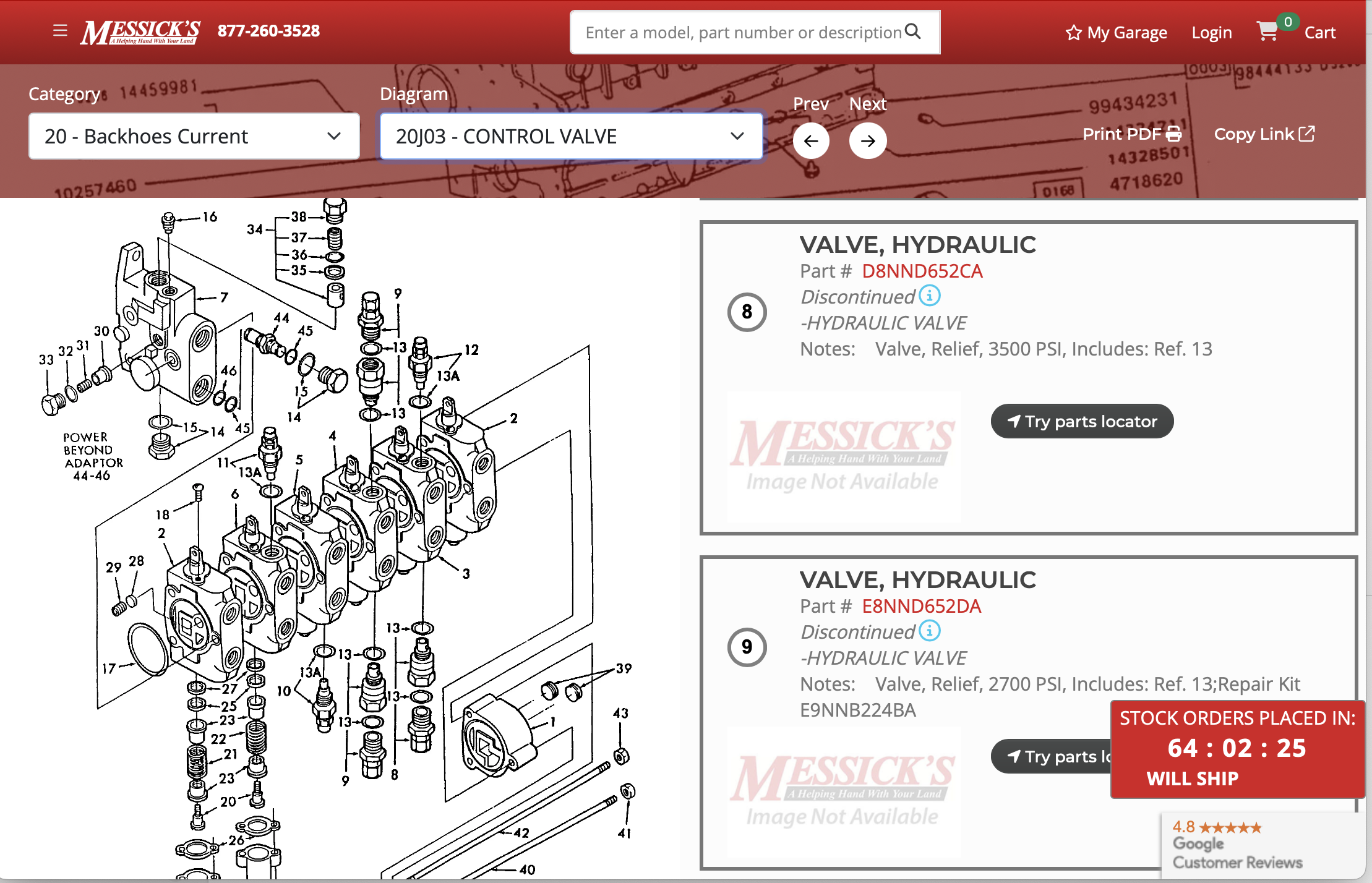

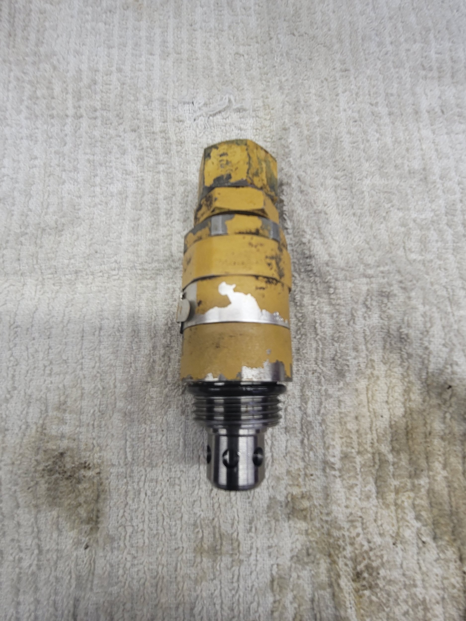

After thinking about it, I should not have taken the valve apart that far. I should have left the end cap and jam nut in place. I'm sure that determines the pressure of the valve. Thanks for the diagrams. My parts book does not have those pages. I'm glad they list the pressures on the valves. It makes sense that each function has its own valve. Dipper, boom, bucket and the swing has two. I'm assuming I could get some fittings and a pressure gauge and unhook the dipper crown line and install it on the line and momentarily dead head the pressure and adjust it to 3500psi. I just noticed that the boom valve is also 3500 psi. I'm going to take that valve off and measure the distance between the jam nut and the body of the valve and set the one I took apart to the same distance. That should get me close, then I am going to install them in opposite locations and see if and any the concerns swap between the dipper and the boom. Without a service manual it's a lot of educated guesses. If after all that and still nothing I'm thinking about checking gpm flow as K5lwq described. It very well could be a worn pump and it probably would be good to rule it out. I do not mind replacing the pump but would hate to replace it and still have the problem. Thanks for all the help. I'll post some results soon.
/ Ford 555C boom/dipper #22
It comes down to flow vs pressure, doesn't it.
No matter what kind of hydraulic pump a tractor uses, all a pump can do is make the fluid flow. Pressure comes about when that flow is blocked. If there is no resistance, there is no pressure and the hydraulic fluid flows from the sump to the pump and back again unimpeded.
We all know those things, But in the parts text next to the parts photos in post #20 we see relief valves with settings ranging from nearly 3000 psi all the way up to 4600 psi !
Seeing back hoe relief vaves with higher than expected relief pressures leads to some questions.
What happens when a pump is deadheaded? What is happening inside the pump?
Can a tractor hydraulic pump really put 3500 to 4600 psi on that backhoe relief valve?
What makes a new pump perform differently from a worn one? What is wearing?

Today I took the valve back out for the dipper and took the valve out for the boom. They are both rated at3500psi. I checked the measurement between the jam nut and the body of the valve for the boom and compared it to the dipper valve I took apart. They were the same. So, I'm hoping I got adjusted correctly. I installed them in opposite locations hoping the problem would move from the dipper to the boom, but it did not. So, I'm thinking the valves are ok. After cleaning up my mess I took off a line for the dipper cylinder and put it in a 5-gallon bucket market at 2 gallons. I ran the tractor close to full throttle, help the stick for that particular dipper control for 4 seconds. After the oil settled it was just slightly over my 2-gallon marks. 31gpm flow equals .51 gallons a second. So basically 2 gallons every 4 seconds. It right at the spec. So, the pump and valves are good. I'm assuming it has to be something inside the valve block. It's like excess flow from the dipper is being dumped to the return.

No, I have not received the manual yet. In the parts diagram in the description of the part it states what the pressures are. Also, when I took the two valves out there is an aluminum band around the body of the valves and it has the pressure stamped into it. The boom and dipper are 3500 psi, the bucket is 3000psi and the swing valves are 2700psi. All these valves have at least two valves built into them, possibly three. There also is a pressure relief valve of 4600psi. This valve is a simple one valve pressure relief. This might be an overall system pressure relief valve. Odd thing is this valve in on the oil input side of the valve block assembly. I guess it really does not matter where the valve is at in the system as long as it dumps the pressure to the return if it reaches 4600psi. Something I just noticed if you look at the diagram you posted on page 2. Mines is the picture without the power beyond, look at number 24 and 25. It is a poppet valve and spring and it is all the way on the left side of the valve block, the return end. That spool valve happens to be the left stabilizer.

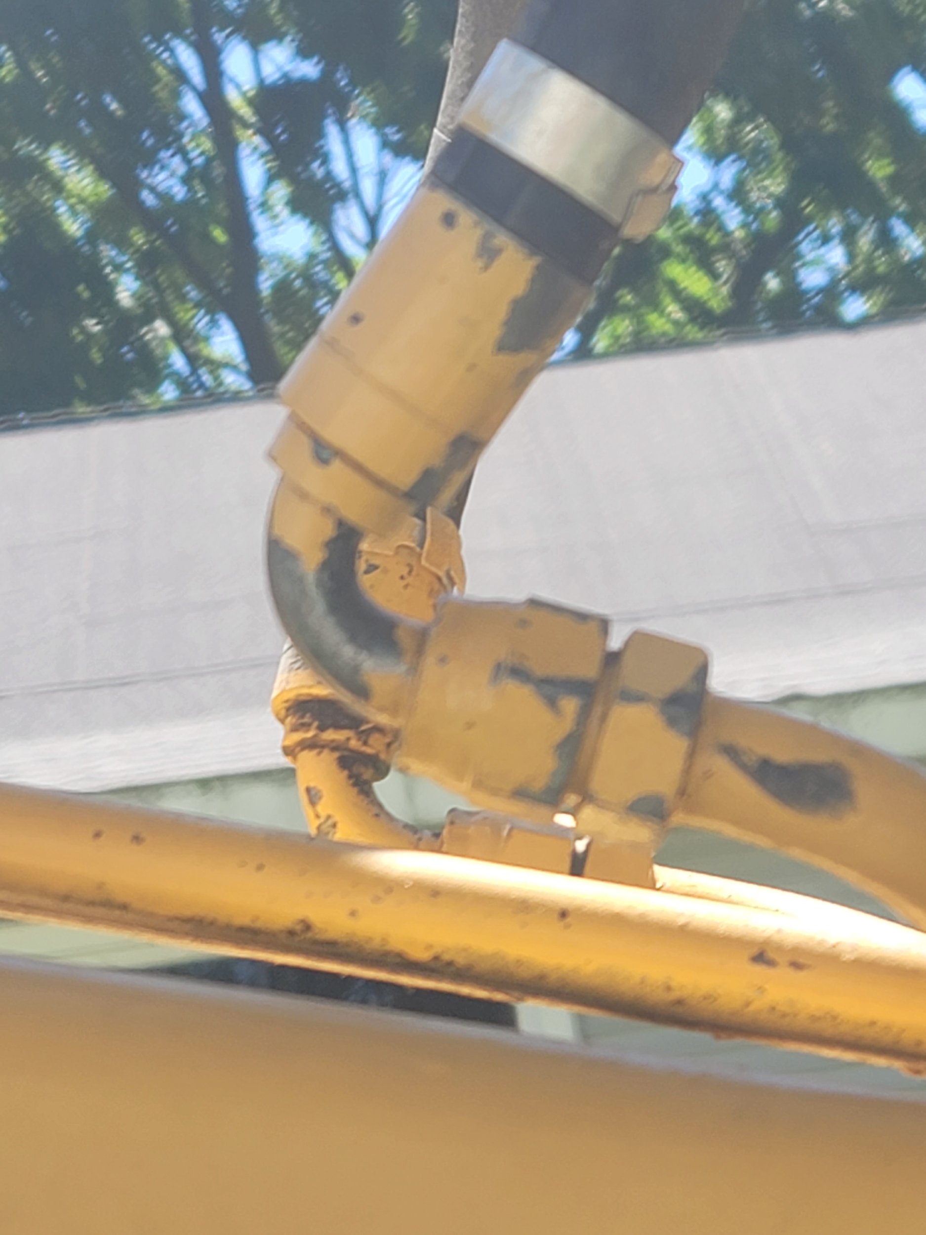

Checking flow was easier than I thought and without spilling a drop. I took a 5 gallon bucket and measured 2 gallons and marked it, cut a small hole in a lid and snapped the lid on, tired the bucket to the boom, unthreaded a dipper hose and put the hose into the hole. I had someone hold the hose so it would not come out of the hole but did not need to after all, ran it at around 2000rpm pulled the lever and timed it for 4 seconds and got a little over 2 gallons. I was surprised how easy it was.

Look at the attached picture of the loader control valve. The loader valve is where most tractors with a loader has its main system relief valve, because it is the very first thing connected to the pressure output side of the hydraulic pump. Note that it has a max of liess than 3000 psi - just as we thought yesterday this tractor uses common hydraulic grade components, and so the main relief valve absolutely controls the pump output. Pump Output will never be more than roughly 3000 psi minus a factor of safety - often the FoS is 10%, but here it seems a bit higher. That's good, and saves you and Ford major money.
For now, ignore the 4600 psi relief. It is especially specific only to that function on the backhoe. We can get around to the physics of it when we get deeper into the hydraulics. Only a portion of that pressure is from the hydraulic pump; the remainder of the extra pressure over (3000-SoF) psi is mechanically generated by the movement of the backhoe.
Nice catch. That is the backhoe main pressure CHECK VALVE. It is what keeps the hoe from dangerously collapsing if a hose breaks.
If you look closely, that check valve is within the common pressure plenum defined by the O ring between each spool valve body. So like many things hydraulic it could be anywhere within that plenum; it just happens to be physically located on the left stabilizer. I doubt that it is the problem, since that poppet works the reverse of a relief valve and should normally be open, not closed.
