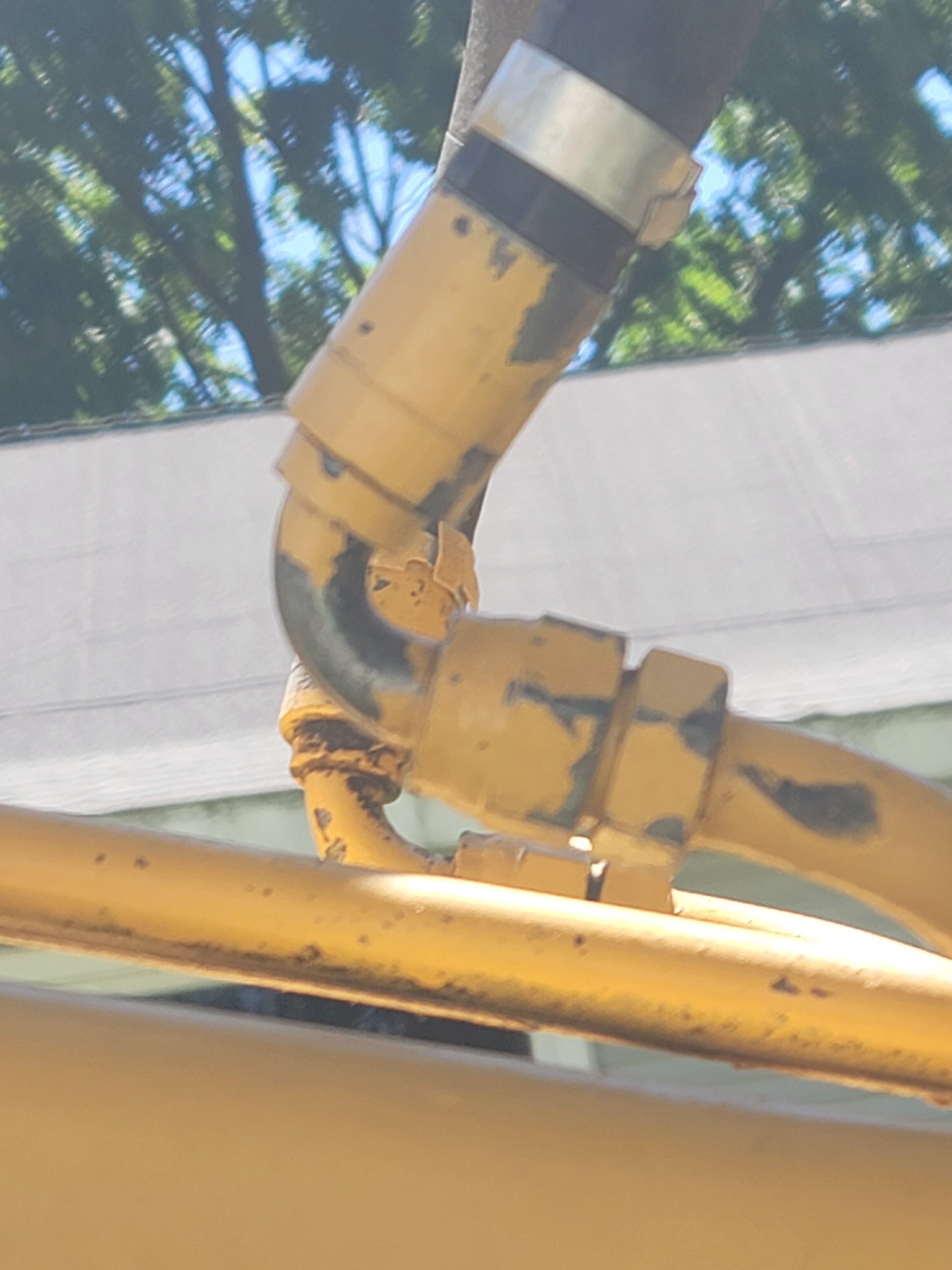

Thanks Scotty. That sound like my issue exactly. I do not have a shop manual yet so I'm kind of guessing at this point. I did take off a valve yesterday that was on the top side of the dipper spool valve. I think it was an adjustable pressure relief valve. Under the cap was a jam nut, adjustable straight slotted shaft/pin, spring and a valve in the bottom. On the bottom of the spool valve is a larger type of valve. I'm thinking this is the one you're referring to. I would think all these poppet valves have to be together and right next to the related spool valve. One thing I think is not the issue but want to mention. I noticed that I have one 90 degree fitting that has a slight bend to it. It's on the hose that would pull the dipper in. I took the hose to a hydraulic shop and was told it was not causing any restriction.

Well after looking at the hose routing I realized I made a mistake. The pressure relief valve I took off yesterday was for the boom and not the dipper. Today I took off some kind of valve for the dipper spool valve and took it apart. I did not see anything wrong with it. There is a part of it I cannot get apart. It's in the first picture. It's the very top left part. There is a spring and a valve inside it. It must come apart somehow. I did kind of screw up slightly. I did not realize that was a jam nut for the cap on the very top and did not count the turns when unthreading it. There is discoloration on the threads on the inside and the picture should help some putting it back together.
Yep. Just for review.....A backhoe spool valve array is composed of a bunch of identical spool valves bolted together like a sandwich so each spool can work individual BH cylinders while sharing common high pressure and return circuits. And each spool valve has its own team of small identical protection poppet&spring valves mounted on it.
Most common is for each spool valve to carry an upper combination reliefs/anticavitation valve, a lower comination relief/anticavitation valve, and a single centrally located load check valve.
So one guess now is that one of those safety valves associated with the dipper or boom spool valve has some crud caught under it and is providing a path for high pressure fluid to escape.
If you had the shop manual, with decent hydraulic diagrams you probably could figure out which particular valve is not working right by logic & comparing which functions are not working.
Some people even claim they have gotten BH checks and reliefs working again by extending a boom or dipper and then letting it drop an inch and "bouncing" it repeatedly to get crud to move. It might be worth a try...but I'd be careful and if it doesn't work not pursue it.
