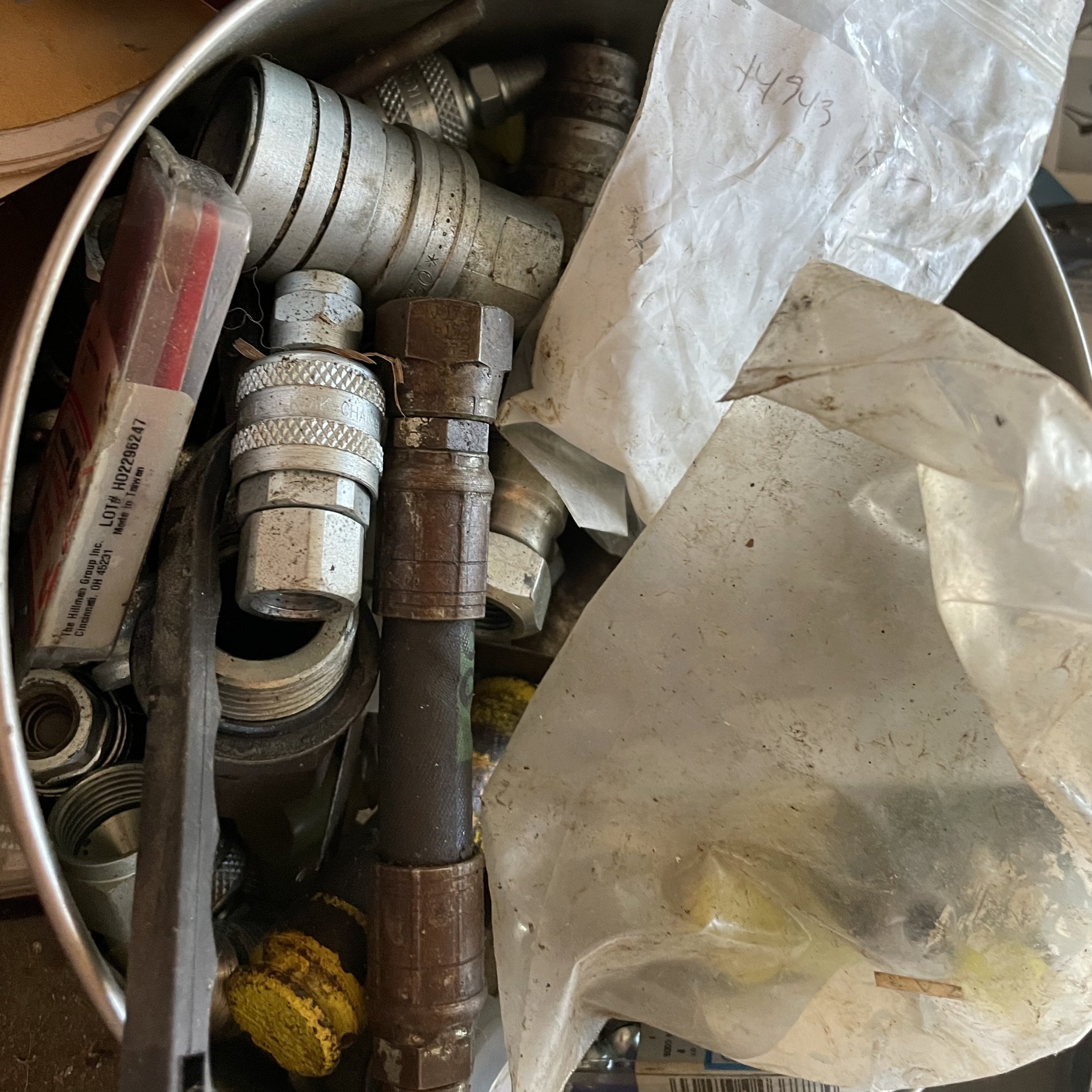

I haven't checked that but that's a good idea. I need to get a gauge. Recommend any in particular?
not really, the cheapest you can get because it doesnt have to be super accurate. Northern tool has some reasonably priced. Fittings, hose and adapters ring up quick too. Since the 580 is kinda big to haul around easily, maybe your local hydraulic guy will let you “rent” one.
Some of my adapters are in the bowl, like the 12 jic x 8 jic hose because I couldnt get a straight fitting.
