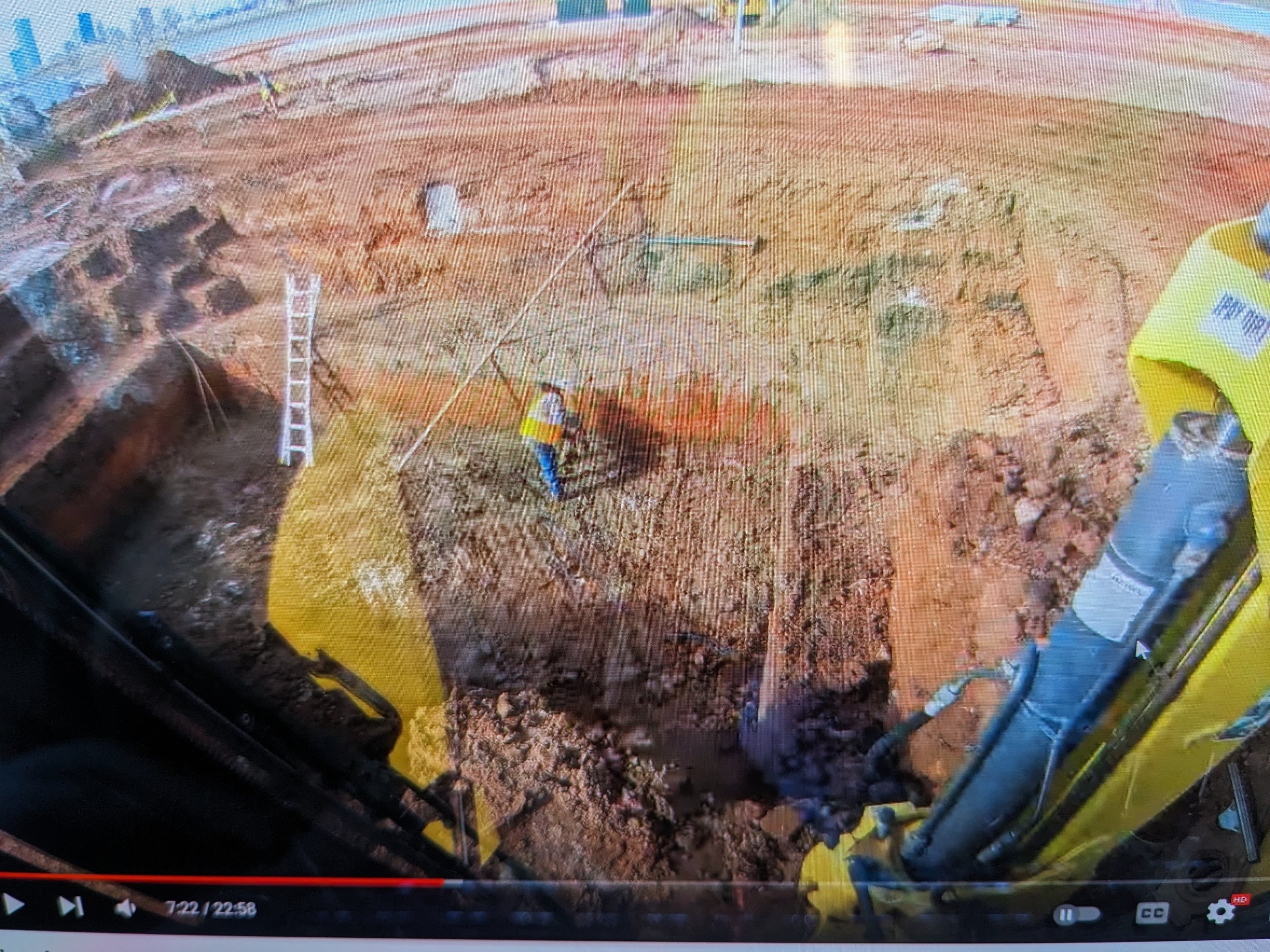

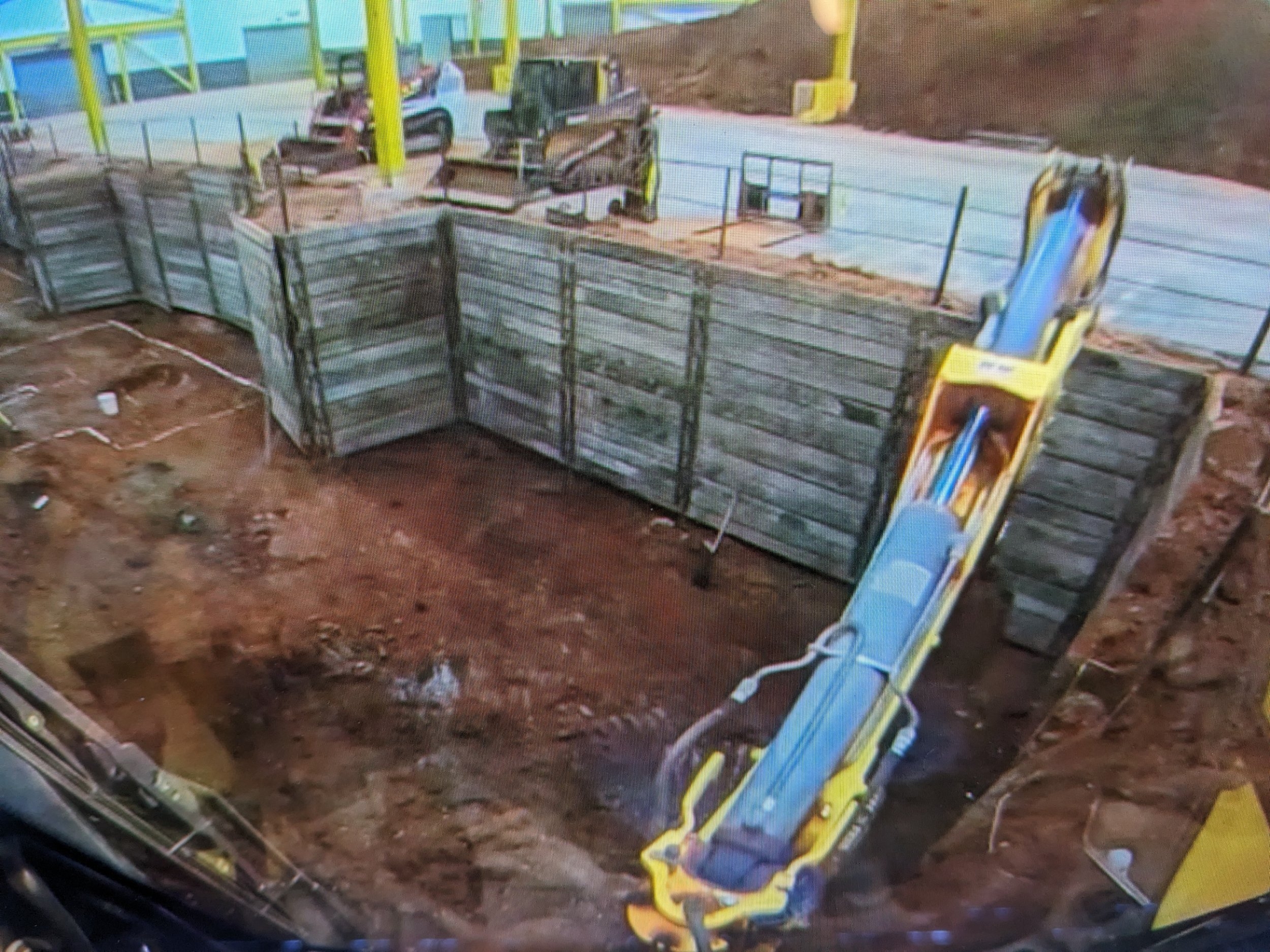

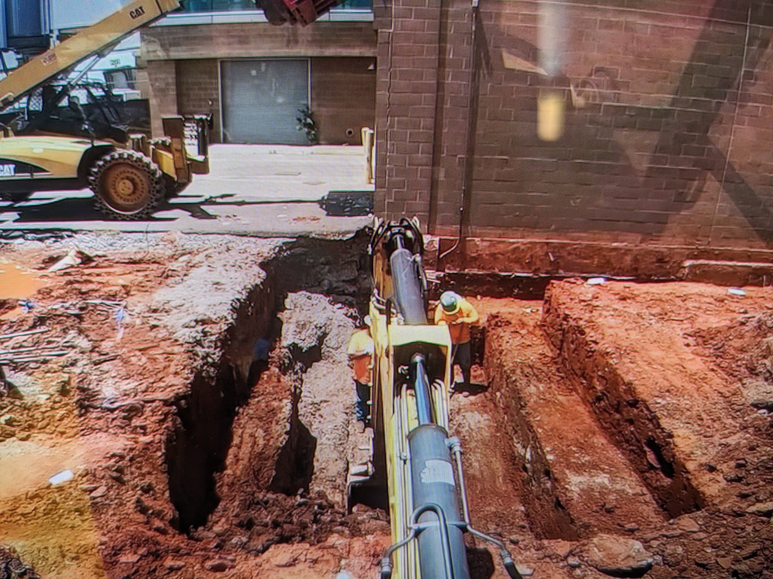

Being a bit hard on Frank I think... He has been at this quite a while.
From Norman Hospital expansion in Oklahoma, with heavy footings to support bridge cranes to Church's digging up leaking pipes to Okana 12 story motel in OKC etc and IIANM putting ~ 10000 hours of digging on that B 95 NH.
I bet he could hold his own against most skilled operators.
