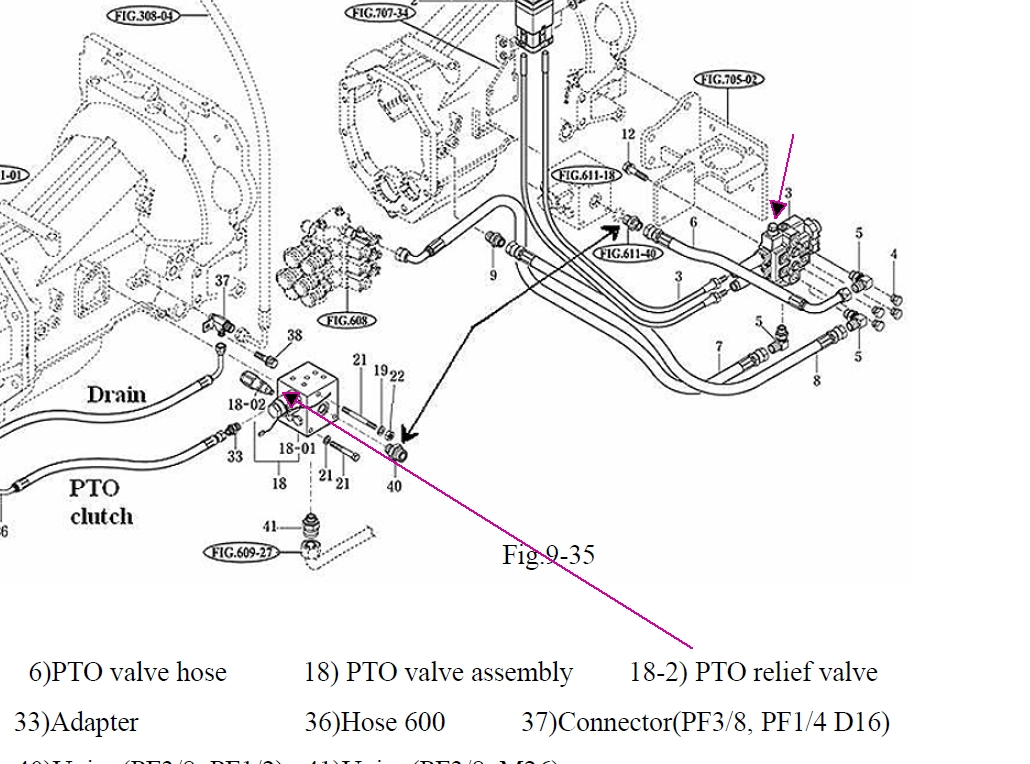

I found a picture of the PTO & FEL blocks.
   / FEL Hydraulics Just Died #23
Mm
I didn’t go back and read all your posts but I believe you stated PTO did not work. If this is correct then problem is not FEL relief since that is after PTO block.

Regarding relief valves... the PTO does not work and is first in line after the main pump. From your description, it sounds like if the pump was good and the PTO relief was NOT open... the PTO should work even if a later relief valve (FEL relief) was open? If this understanding is correct, sounds like the PTO relief would be the problem since all other valves are after that. I will look more closely at the PTO relief valve but I'm a bit unclear as to how to see any potential broken spring.
