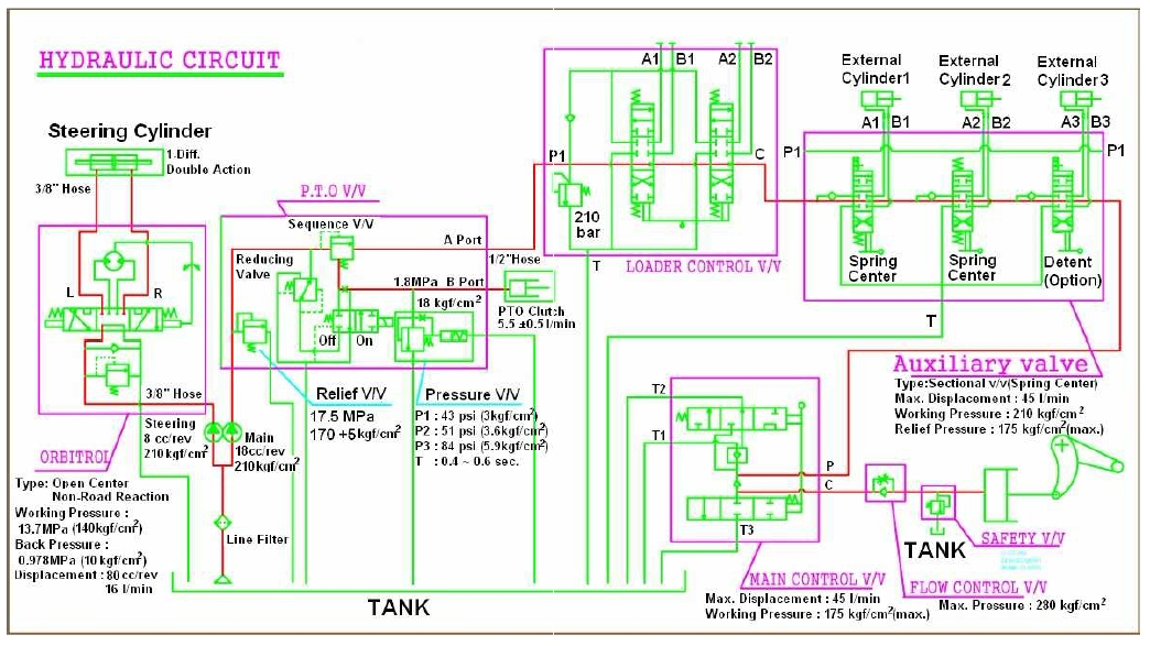

I found a picture of the PTO & FEL blocks.

I didn’t go back and read all your posts but I believe you stated PTO did not work. If this is correct then problem is not FEL relief since that is after PTO block.

Regarding relief valves... the PTO does not work and is first in line after the main pump. From your description, it sounds like if the pump was good and the PTO relief was NOT open... the PTO should work even if a later relief valve (FEL relief) was open? If this understanding is correct, sounds like the PTO relief would be the problem since all other valves are after that. I will look more closely at the PTO relief valve but I'm a bit unclear as to how to see any potential broken spring.

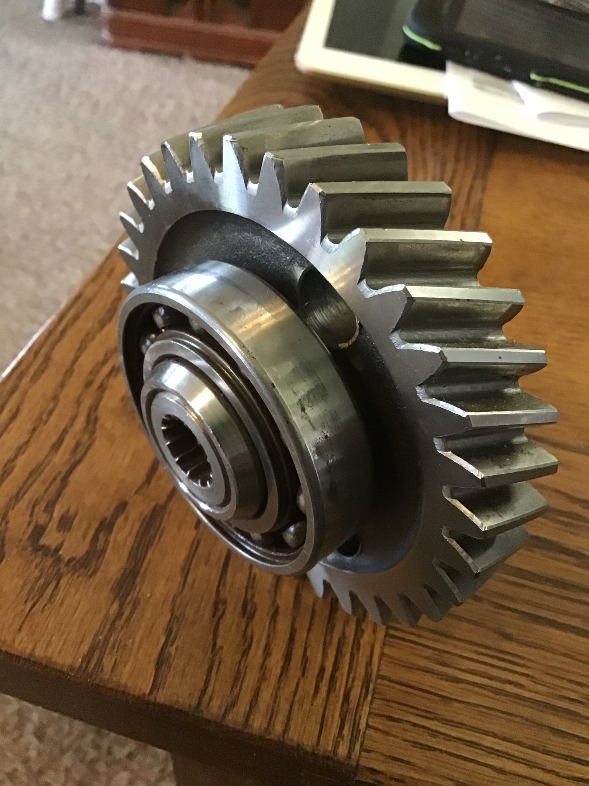

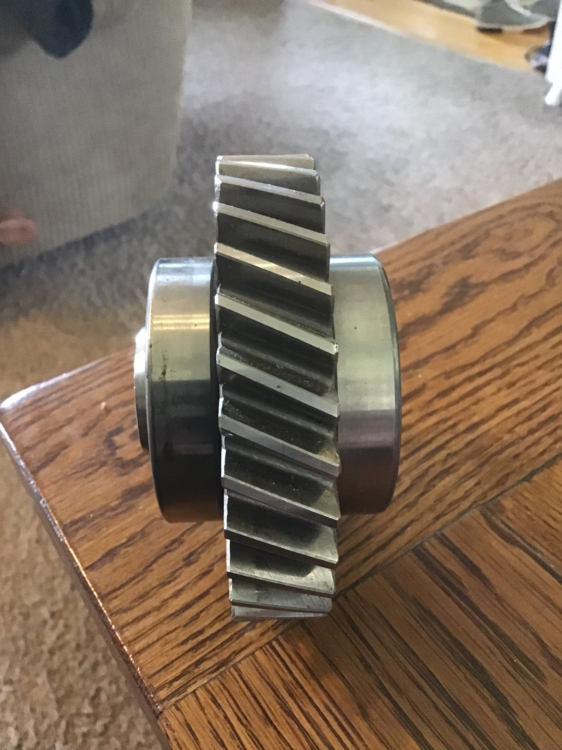

I did find that my pump drive shaft mates perfectly with a 5/8” socket, depending On OP skill set/tools on hand a good 1/2” drive drill can be used for testing purposes. I did sacrifice a socket extension to use to drive the pump, cut it off so it could be inserted in the drills chuck. This was after getting the new pump.
I was concerned, in my case that I had some sort of blockage that caused the damage to the drive gear.
I sure didn’t want to do all the work only to have the same failure down the road.
I found that I could ”clock” the new pump 90 degrees and connect it to the hoses. With this setup I tested the hydraulics with my drill, with a zip tie on the drills trigger, I could run the pump and test the front end loader. That drill had enough power to test all functions.

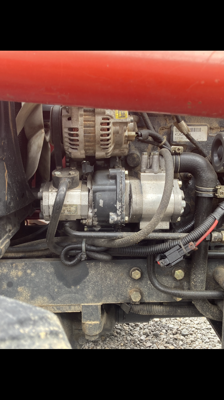

Here‘s a shot of my tractor‘s two pumps, hopefully similar to OP’s. PS on left Hyd. On right. Drive gear inside gray housing between pumps. It is a lot of work, getting to that gear.
Yes, looks like it would be.

Void to right is where that drive gear would reside, whole front cover of the motor is off in this picture.

A blown PTO fuse would not prevent flow from going to the FEL or other functions. It would just prevent the solenoid operated valve that engages the PTO from operating.
