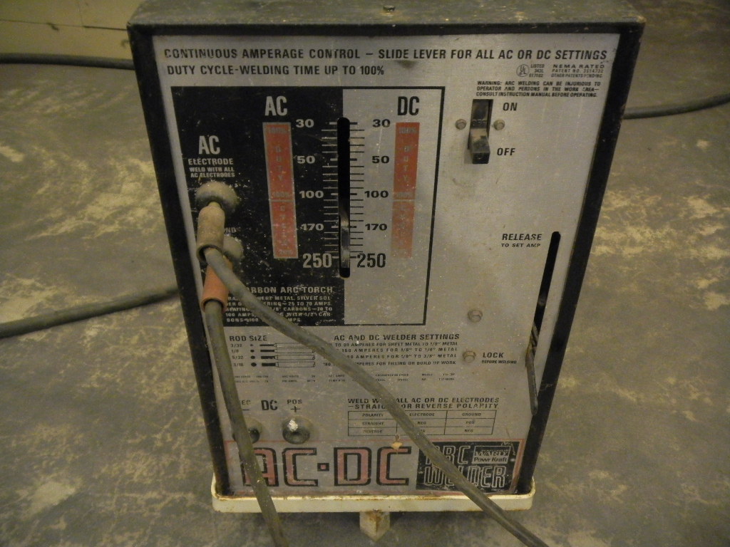

If you need a stick welder, as has already been mentioned, you'd be hard pressed to find anything better than the old Lincoln IdealArc tombstone welders. That's what I learned to weld on 25 years ago with a machine that was probably 40 years old at the time, and I'm sure it's still kicking in that classroom today. Watch your local craigslist, you'll find them on there anywhere from $200 - $500 and I can promise you that other than submerging it in a pool of water or burying it in the dirt, it will work every time you turn it on. Even the AC225 is a good little machine that can be relied on.
/ Inverter stik welder problems #37

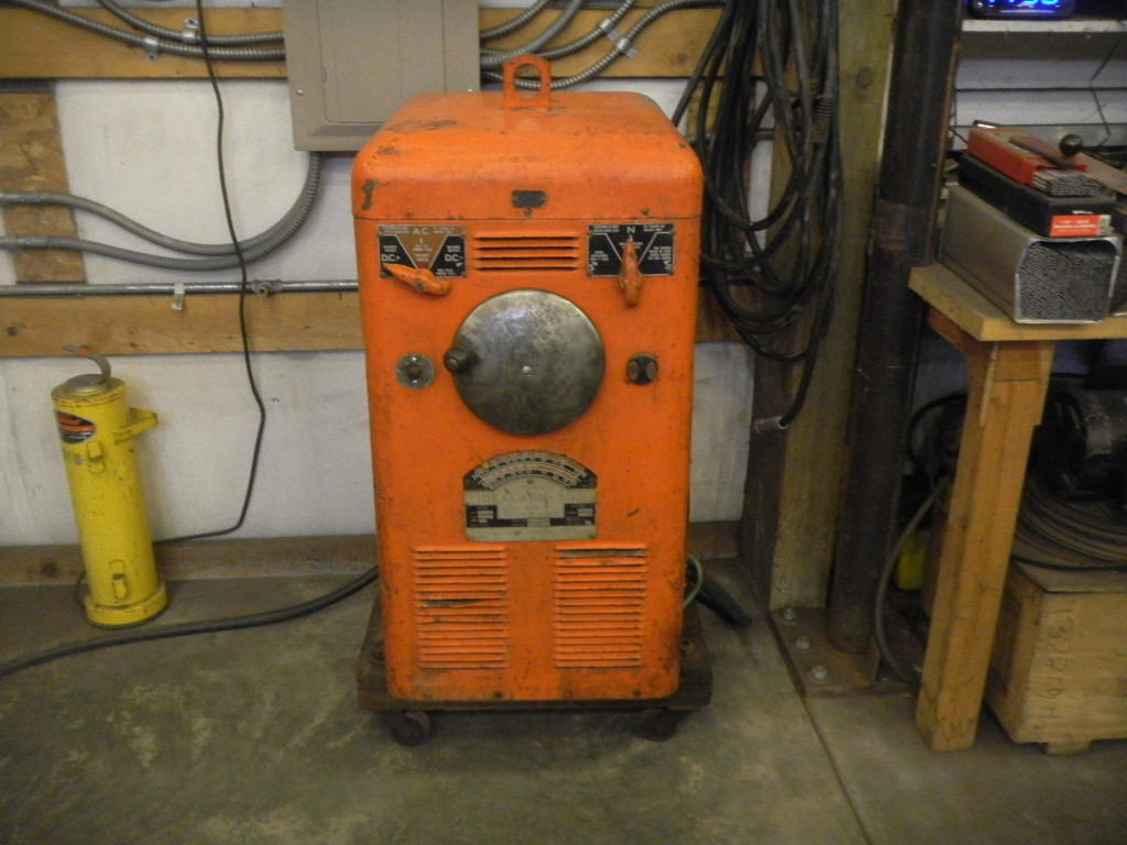

All this looks like a good reason to go out an hug my Tombstone. Around here it's nearly always damp and or cold and I just cant be bothered lugging my welder into and out of the basement to keep it working. It's not like you can heat and air condition your garage to keep electronics content. Besides, a lick with the grinder and a coat of paint and my welds look good too.:rolleyes: That reminds me its about time to put my Handler135 in the basement until it's needed again, winter's a comin.
