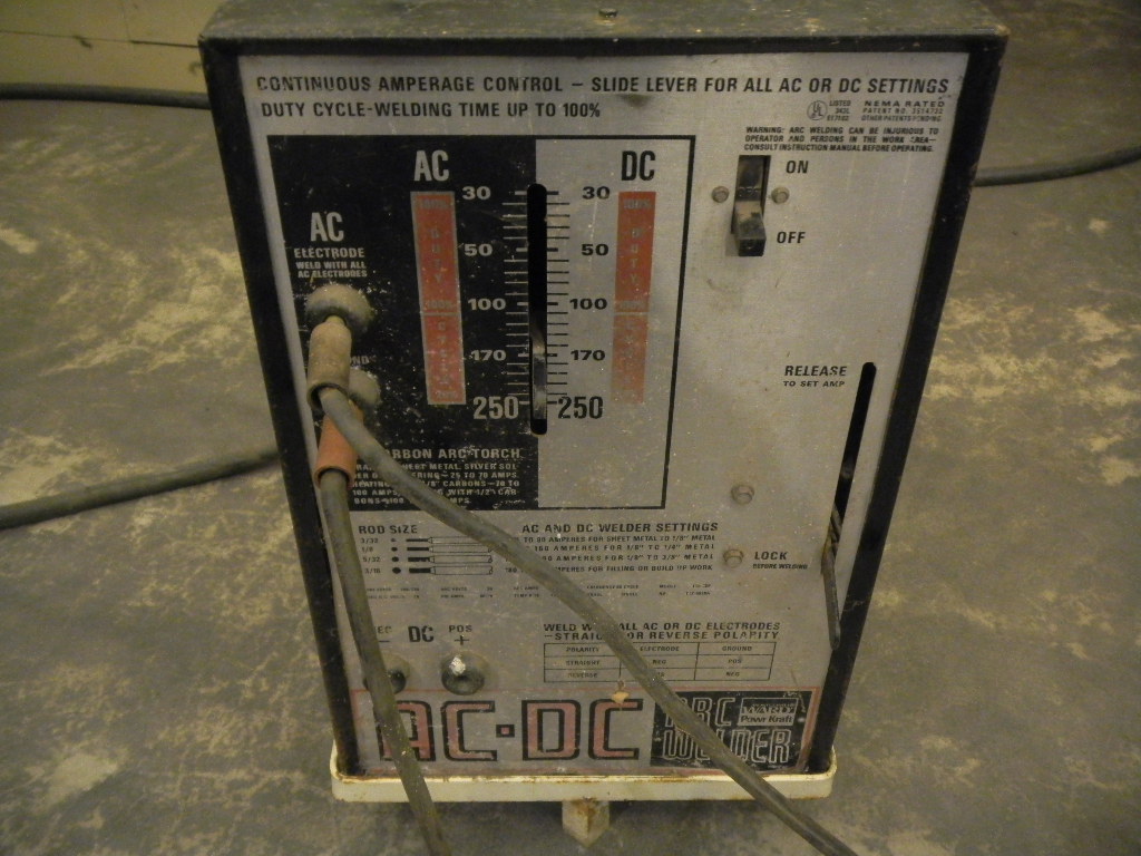

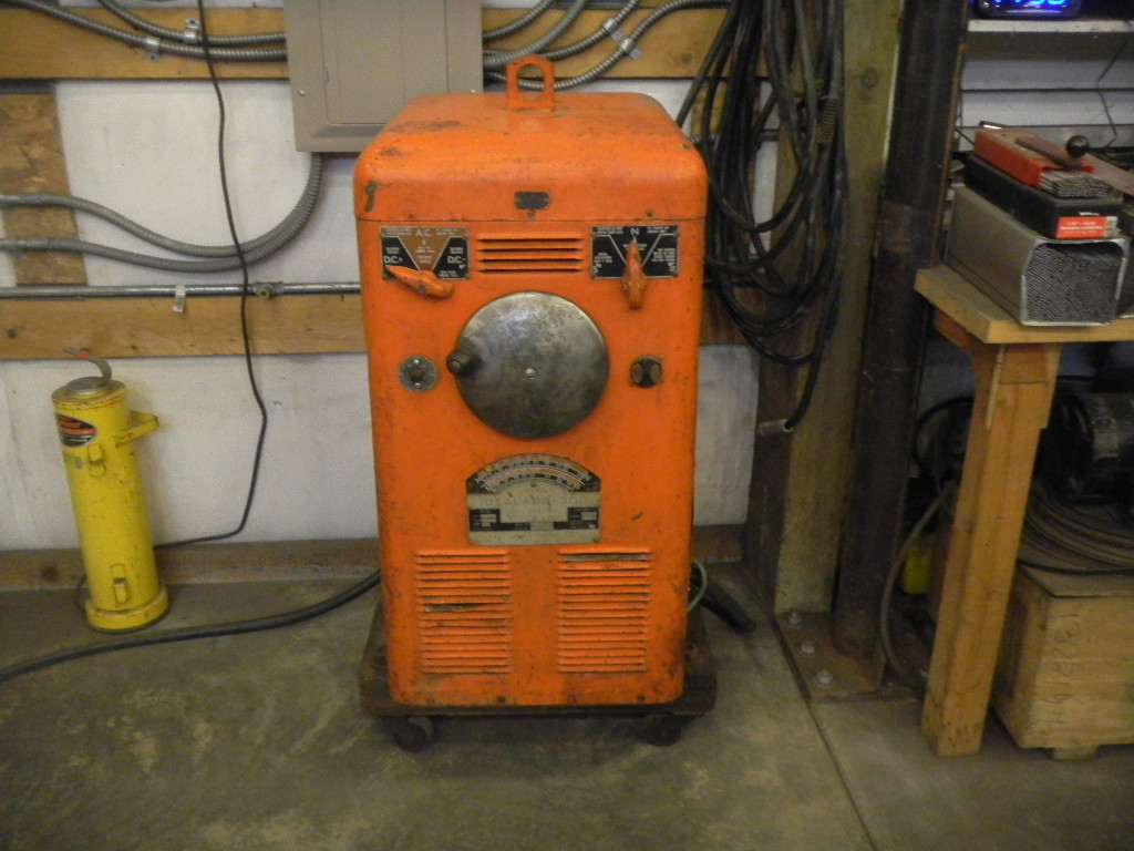

I cut my teeth on transformer, and generator welders. I still have a couple old transformer welders, and three generator welders.
But the control over the puddle these inverters have just amazes me! Hot start means nothing to me:rolleyes:, but the adjustable arc force is the best thing since chocolate ice cream!:laughing:
How long will they last? God only knows, but they are sure fun to play with!:thumbsup:
Here is one of my transformer welders. 1937 Lincoln.
