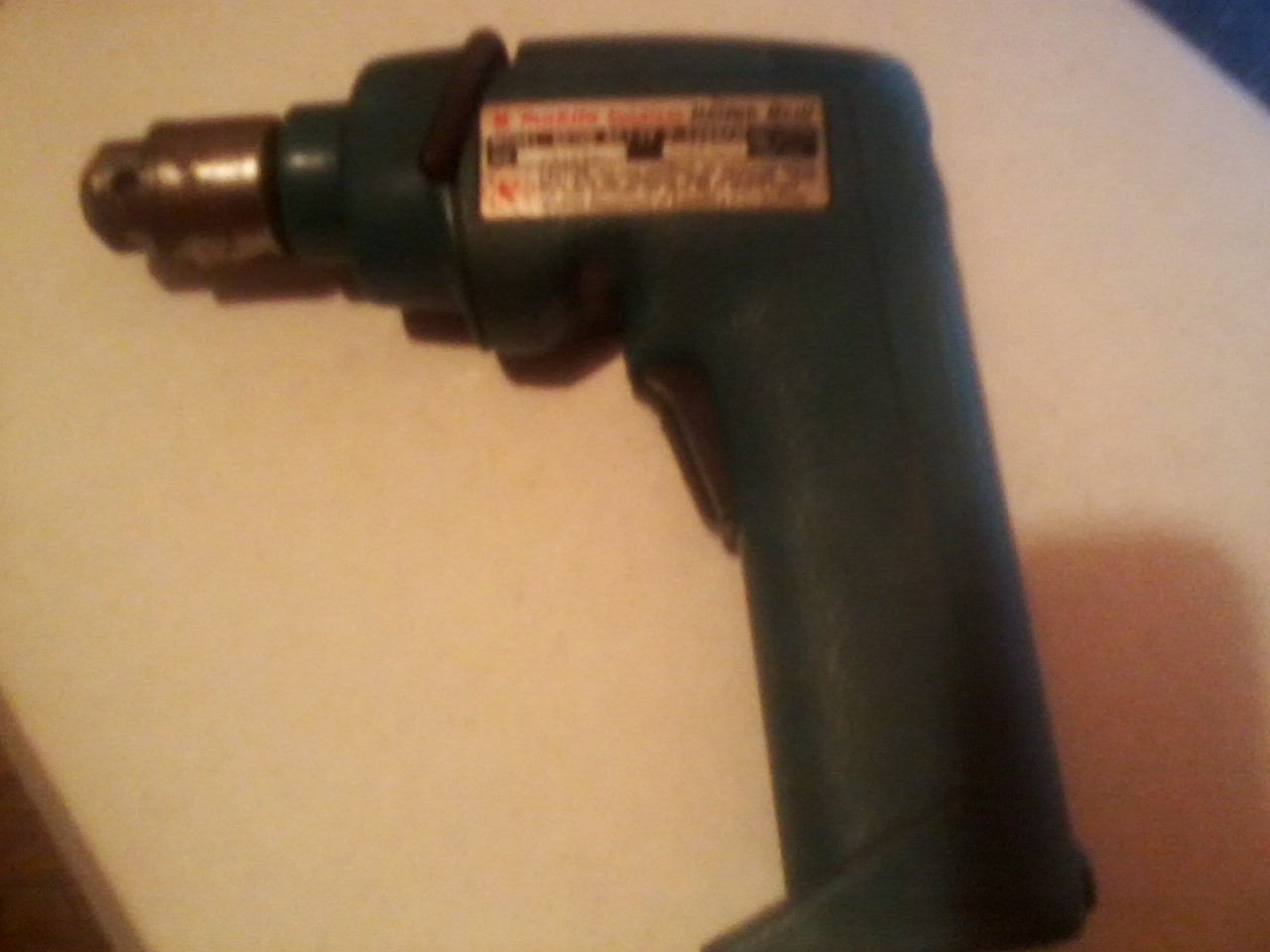

I just decided to put my 7.2 Makita out in the trash this week while cleaning up my shop. Battery begins to smoke when you plug in the charger. These types are soldered and not removable. I don't even know if you can still get the batteries. Those already were replacements too after the originals failed to hold a charge. Was a favorite drill of mine for many years :)

TBN suggested Batteries Plus for rebuilds and I had some done there this summer... so far so good.
The local Batteries Plus was at least 50% higher than the one near my brother... same specs... so I dropped them off there.
In all the years I have owned it I only charged when fully dead... I would run the down the battery with a tool or flashlight and was still using batteries that were 15 years old... again... never charged unless I ran it to dead.
I did all the sheetrock in my first house with the 7.2 plus lots of other tasks...
At work I picked up a Dewalt 12v Drill which has also been good and it now lives in Washington...
My go to drill around the house is my 12v Bosch with 15 minute charger.
Soldered and not removeable? Please.. and the earth is flat and the sun revolves around the earth.. :(
rechargeable nicad, nimh an LI batteries are readily available, including sub-class size batteries.
