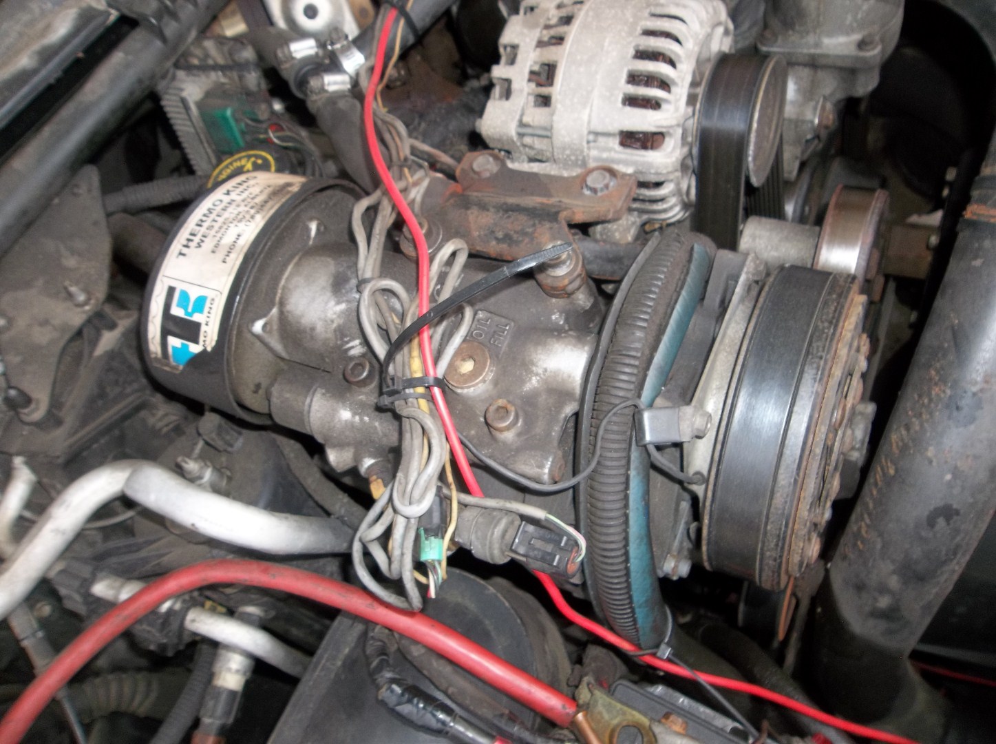

I have a couple of the York a/c air compressor setups, absolutely love them, from airing up tires to air tools in the field. I have mine set to on at 120 psi and off at 160 psi. Then regulate anything from there that needs it. Kilby was one company that had bolt in kits, but think they have sold out to another company. Air boss also had kits for dodge Cummings setups.
I have seen York air compressors set up in Jeeps, with the air supply routed to a pipe bumper. That gives a fairly good reserve and requires no extra space.

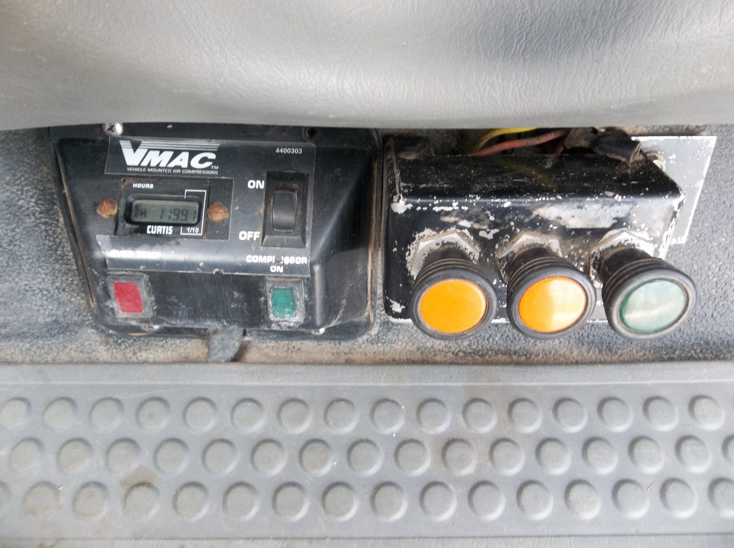

Here's mine. VMAC VR70.

You would be surprised on the output of a standard AC compressor on a vehicle... I have a friend that put a pressure switch on the clutch and a 20 foot hose, he can air up his 35" tires from 6psi to 25psi twice as fast as my harbor freight high flow (the biggest one) 12V compressor... this setup is on my short list... he just adds a little bit of ATF on the breather filter he put on the inlet every now and then... I've heard of people using air tools on them... add a small tank for volume and it wouldn't care about much...
Everyone raves about York compressors, but they're huge and expensive...
