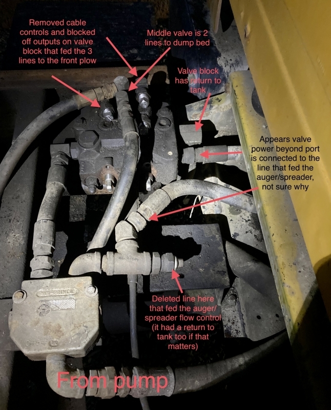

I bought a 1981 Kodiak C70 dump truck. It had a plow and salt spreader. The hydro pump is engine belt driven with an electric solenoid to engage it (switch on the dash).
I have removed everything for the front plow - 3 hydro lines ran to the front from the valve block, and the two cable control levers in the cab.
I have removed everything for the rear spreader and auger. The pump fed the 3 way flow diverter box shown in the attached pictures. The diverter box split fluid to the valve block and to the variable flow control box in the cab which controlled flow to the auger and spreader. The variable flow in the cab had two hydro lines going to the back and a return to tank line. There was also another return to tank line from the back to the tank for the return from the spreader and auger.
So, one thing I don't understand is why the power beyond port on the valve block is connected to the other side of the flow diverter box which fed the variable flow control.
The attached picture with notes on it shows what I have after removing the above.
I was tempted to plug the power beyond outlet on the valve block and remove the flow diverter box, connecting the pump directly to the valve block.
I think the valve block has a pressure relief valve and it has a return to tank line, so I think this is ok?
Yesterday I fired it up and tested it. If I held the dump lever in the UP position and turned on the pump it worked as it should. When travel stopped and control lever returned to center it seemed like the pump was working harder. Lower pitched noise, not a high pitch maxed out pressure noise.
If I turned on the pump with the control lever in the center position, and then tried to operate the dump bed, it was slower and jumpier while going up. It sounded like the pump was surging or something.
I repeated these two methods of operation a couple times to verify.
So I'm thinking that power beyond port's connection with the flow diverter box might be doing something weird and I should delete it.
What say you more experienced people?
Does this set up seem safe and functional?
Thanks!

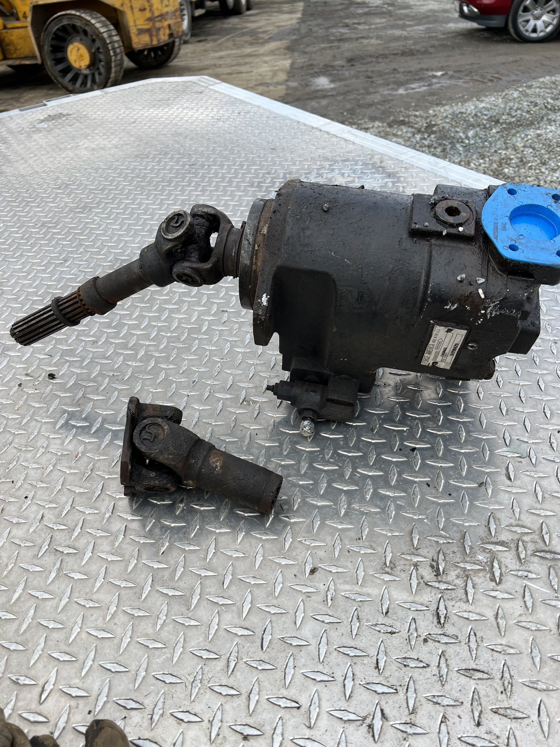

I just shut the pump lever off up at the engine driven pump.
Here was mine before I removed it.

I'm not sure what you mean. I still need the hydraulic pump for the dump bed.

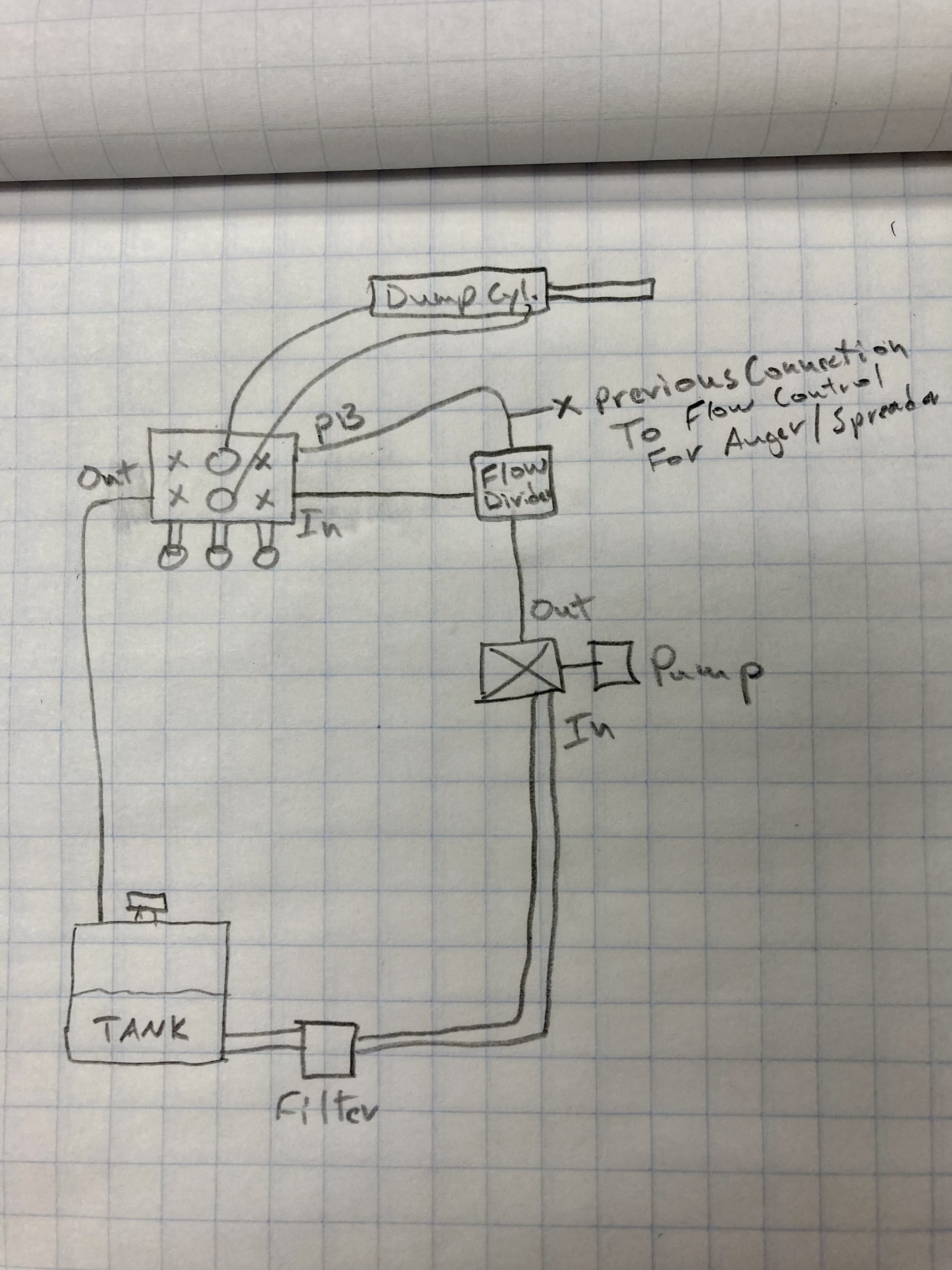

Thanks for looking at it. Here is a schematic that might help you help me. I think the flow divider box that still exists has some capability built in to shift flow where it is needed more. But I’m not sure. If it didn’t then it would just be a simple T connection. But i dont see how what i have now is different from what existed previously when the flow control box was turned off

It sounds like I should connect the power beyond outlet to the tank. When the dump bed isn't being used and the pump is running the power beyond will dump all the fluid into the tank. When I use the dump bed valve the power beyond will be cut off and flow to the dump cylinder. Is that correct?
/ Dump Truck Hydraulic Lines #8
First off, those are nice drawings - that makes it easy.
I think you can see the problem in the way it is now. The only way that works is if that diverter block has it's own (large) return line to the tank. You didn't show one, and so my bet is there is no place for that PB flow to go...
The PB flow out of the dump control valve is a flow with the potetial to build pressure. So it gets over to the diverter valve where it is going to somehow backpressure the innards of the diverter valve - all the time building enough pressure until some of that rogue PB flow can escape inside & join in the pressure line to your dump control.
I can imagine there is chaos inside that diverter valve. And while all of this is happening it is periodically building enough pressure to slow the main pump and probably dumping whatever it can via the relief valve - assuming that there even is a relief valve somewhere.
My bet is it oscillates, gets hot, and you should not do much of that.
When the auger and spreader were there, there was a use for that PB flow. Now it's problem and I don't know what to do with it using what you have there. You cannot just dump it into the sump, because there goes all your flow wasted and no power anywhere.
You could:
1. Switch to the right PB sleeve so you can plug that PB port. IF so, BE SURE to increase the diameter of the return line. And make sure the valve can handle that much return flow.
Best get the specs on that valve model before doing this.
2. Or you could get a diverter valve with a real return port and hook that up...which is not a bad idea anyway because a diverter should have a relief valve, and the fact that yours doesn't have a return line means it doesn't have relief.... and that would frankly scare me when being used on something with high dump truck flow & pressures.
3. Or you pitch the diverter AND the existing dump control in favor of a one lever control valve without PB but with a return port & relief valve. If you do that, you have to up the GPM of the control valve and probably all the pressure & return lines too. You may want to upsize the return lines anyway. I would.
My side worry is that I do not see a relief valve and line. Was it in the deleted parts?

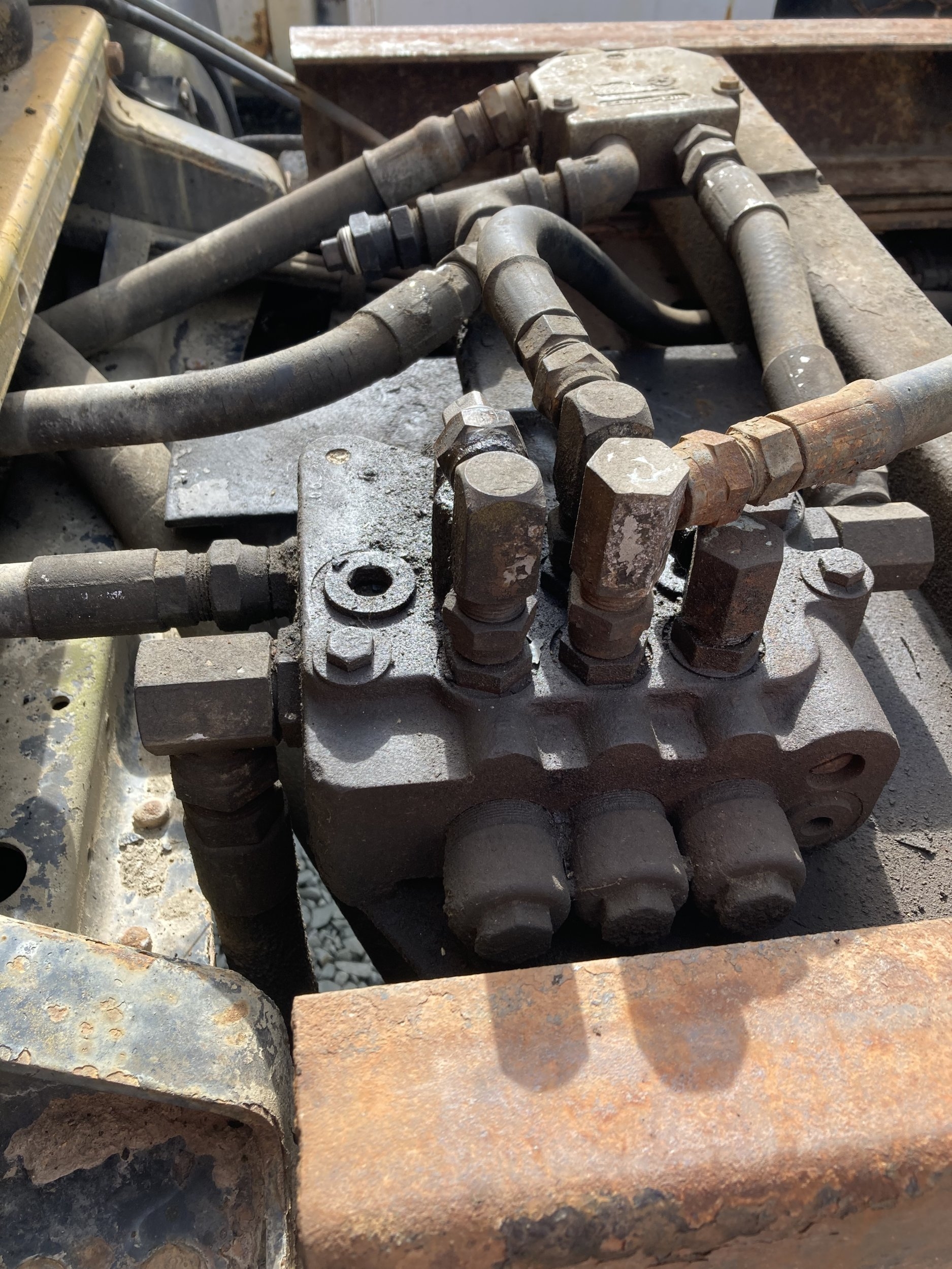

The valve block return like is the same size as the line coming from the pump to the diverter box. Show left side, close, going down in the first photo. The second photo shows what I think is pressure relief valve by the valve block inlet. Im not seeing any identifying markings on the valve block.
/ Dump Truck Hydraulic Lines #10
Typically the return line is at least twice the diameter of the pressure line, and even larger does't hurt. It needs to be able to return unused fluid to the sump without the fluid resistance of a small line that would put back pressure on the valve and cylinder.
Your original system had two return lines - one from the main valve body and another from the flow control for the auger and spreader.
So if now it just has the one return line from the main valve to handle the entire flow, that return line not only has to be much larger, but the main valve must be rated for enough GPM to be able to handle all the flow as well.
I'm not seeing a relief valve by the inlet in the second photo. Have you got a photo of the old flow control valve for the spreader and auger? Maybe one was there?
!!! One idea I just had is to put the auger & spreader control valve back into the circuit, but take off the handles and plug the cylinder ports so it cannot be actuated. Add a relief valve if it doesn't have one. Then you would have a place to put the PB line and also get back your original second return line. Also since the flow would be split, the original valves GPM rating is good. They can all handle their share of the flow.
The relief valve thing bothers me. Just lifting an empty bed doesn't build much pressure, but lifting a load will build real big pressure. And then drop it suddenly.
Plumbing in a relief right off of the main pump is easy and cheap. Look on surpluscenter.com

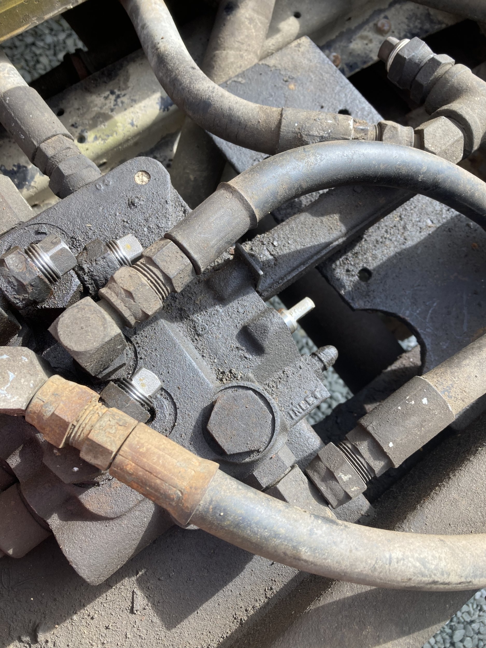

I attached a photo pointing to what someone told me was pressure relief on the valve body. The other pictures are the flow control valve that was removed.
How would I go about specifying the right pressure relief valve to add to the system

Is that the diverter? Whatever it is, I've added an arrow pointing at the relief valve.
Relief valves are adjustable. They can be opened up. Inside will be seals plus some sort of compression spring-loaded poppet or ball bearing that seals an orfice. Adjustment for pressure at which it opens is done by changing the preload on the spring. Some springs have a threaded adjuster, others use shims.
Either way changes the preload and thereforenthe psi at which it opens.
Most Ag machines run at 3000 psi max, but not all do. Don't screw around with psi; and only use rated hydraulic fittings. Plumbing fittings will often thread on, but please DON'T.
For finding a proper psi, look at the markings on your hoses and hose fittings. Then call the manufacturer and ask what working pressure that part number is designed for. Set relief at that pressure +- 10%. Be real suspicious if anyone tells you higher than 3000 psi for a working pressure.
On dumping the PB line straight to the tank like LouNY says is OK. It might work. It all depends on how much of the flow in your valve was designed to go to the PB. It might work if the PB flow is smaller than the main, but won't if the PB flow was designed to handle full pump output.
No way to know, different valves had different schemes. But I agree with Lou that it won't hurt to try. At worst you will just not get enough pressure to lift a load and we can work on one of the other ideas.
OK, I thought you were looking to remove it altogether. If you need pictures of my setup now that it’s done, I can send. I had a dump truck set up with hydraulic lines for bed auger, bed tilt & drop spinner
