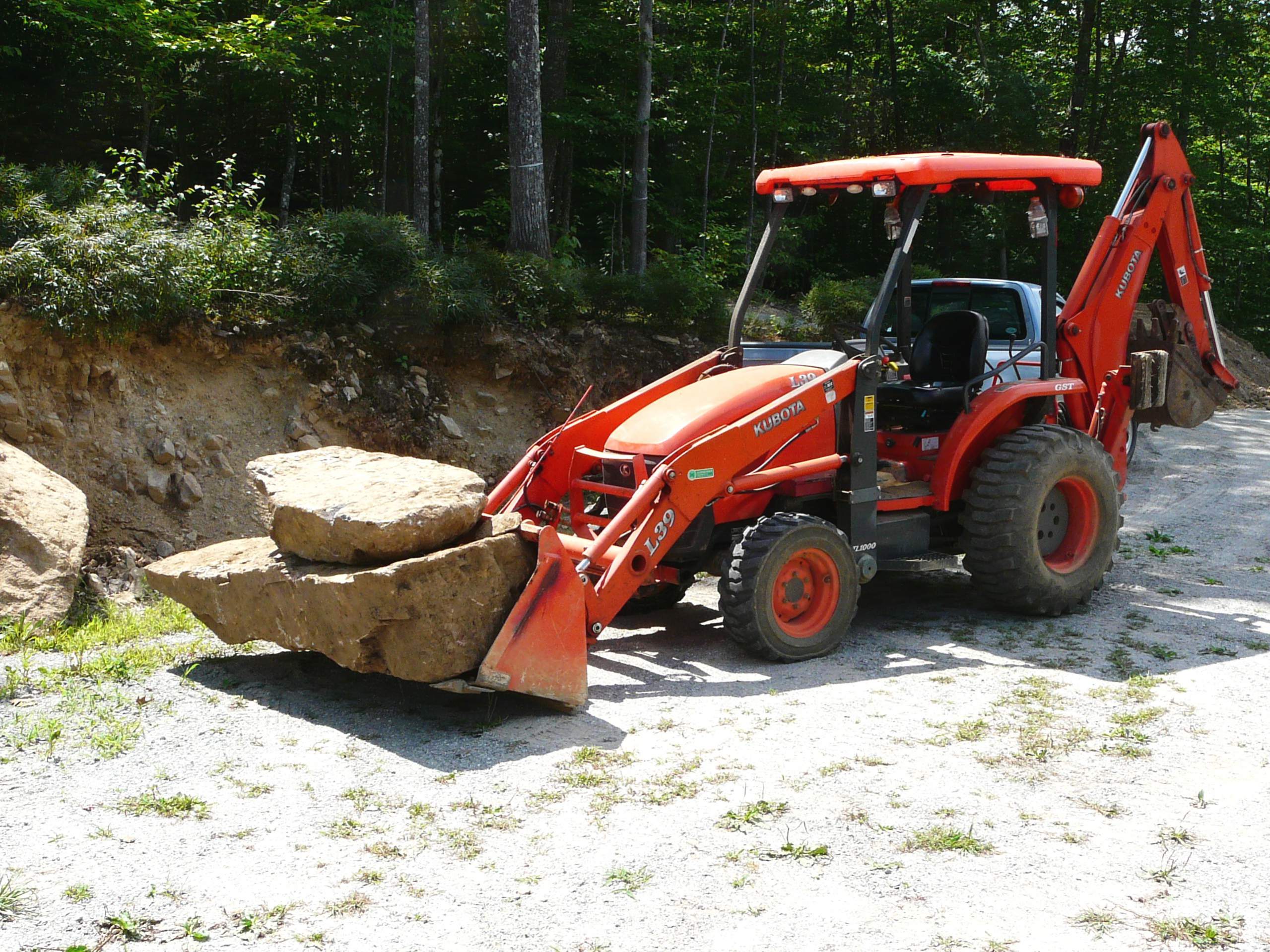

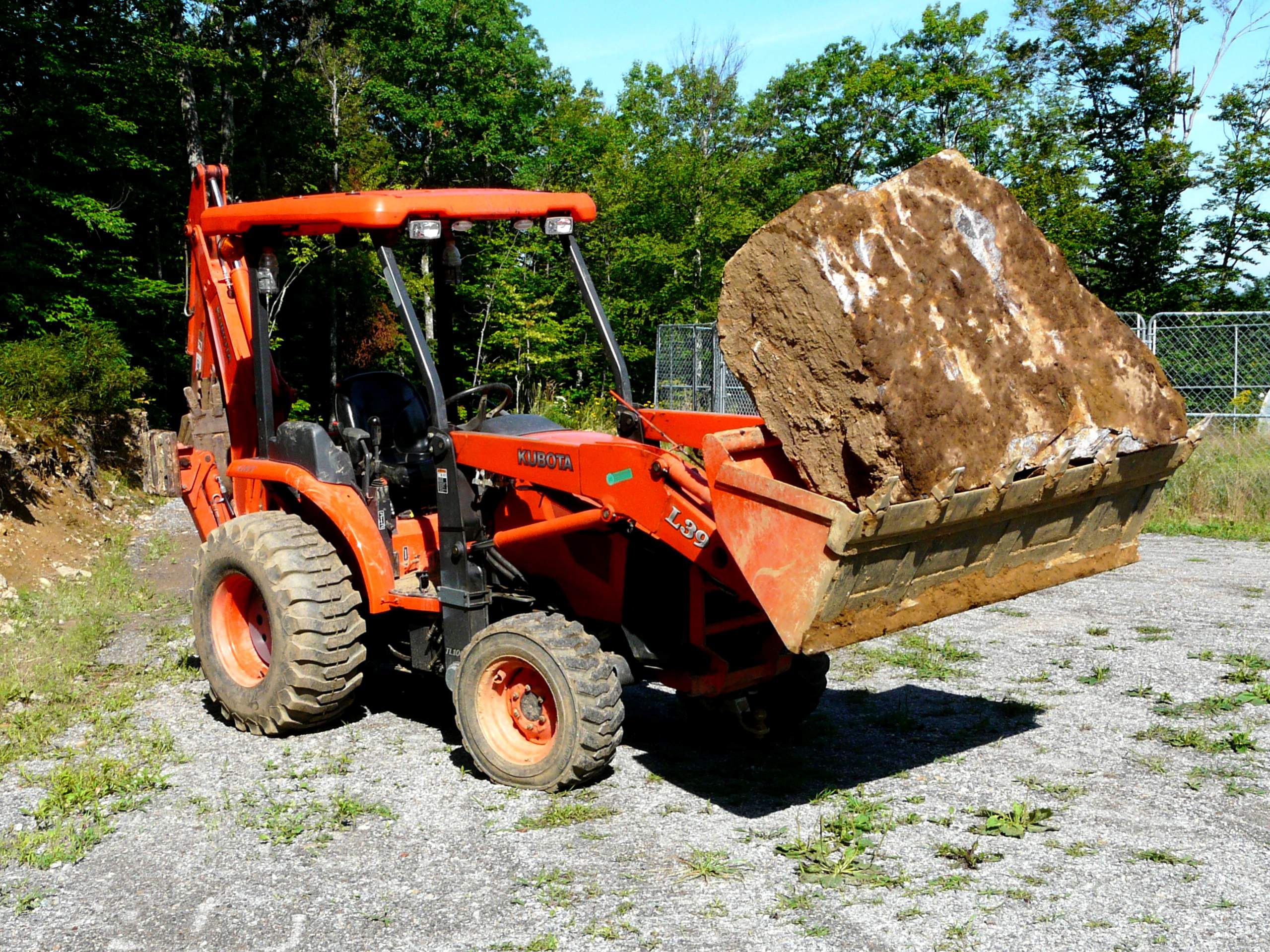

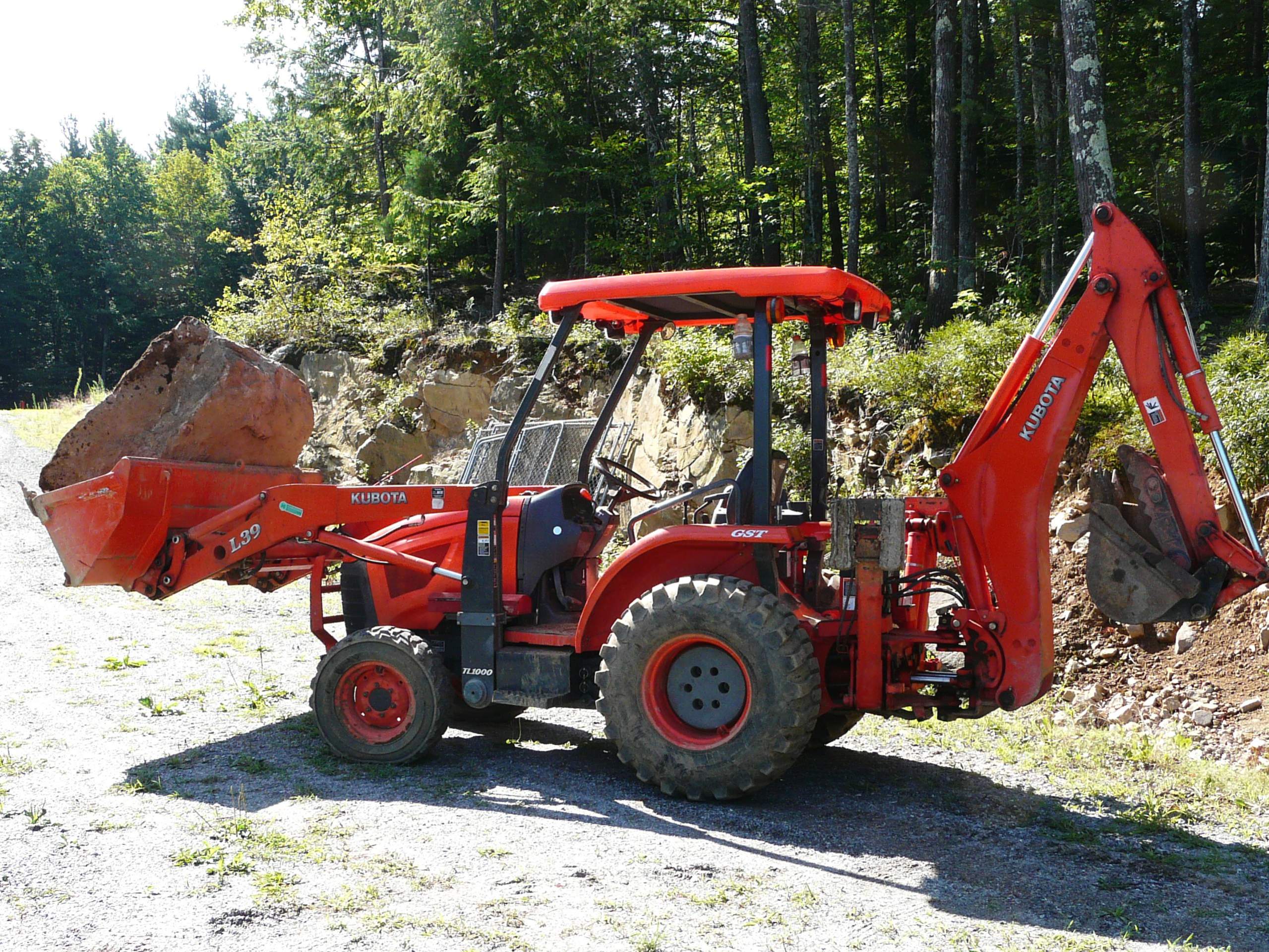

Rocks & Rocks
Note i have 750 lbs of inner and outer wheel weights, a 120 lb thmb on hoe, The loater tube s are stuffed wuith 4" dia steel barss and some other reinforcmets, that adda toatal of =1000 lbs to my l39,
Note rear wheels are vety light.
How do you keep rear on ground?
Impressive! I have loaded my little BX to the max with cement retaining wall blocks but have never had the pleasure of picking up something like those! :thumbsup:

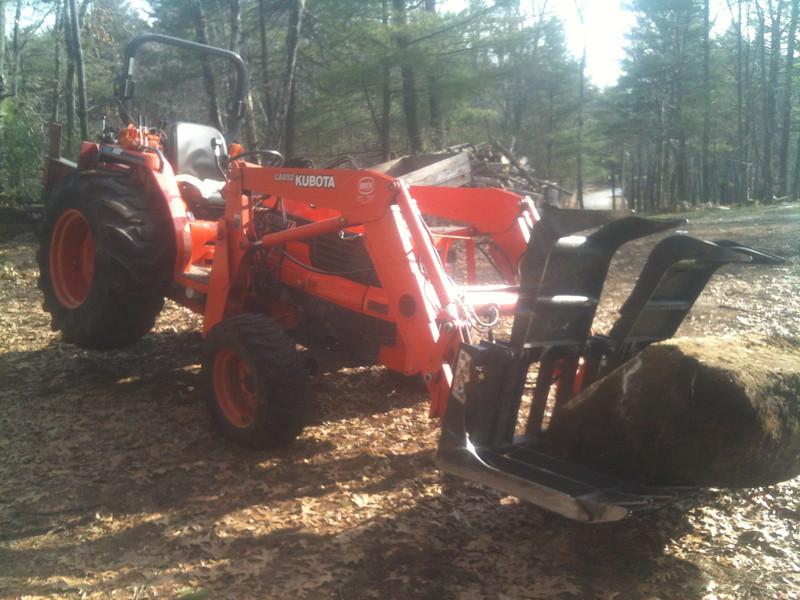

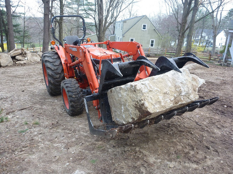

Could you give an update on how the new rams are performing for you? I would like to make this modification to my L45 as well. the seals keep blowing because we use a large grapple. Do you have any information on the larger rams and where I could get them.

Kent, I don't have a clear picture of why using a grapple should cause the curl cylinder seals to fail. But it might make sense to figure it out and fix that problem that before investing in custom cylinders. My first guess is simply that it needs a bypass valve in the front loader curl circuit like the valve that enables a backhoe bucket to overpower and push the backhoe thumb backwards without damage.

I can only surmise that the length of the grapple protrudes so far forward from the pivot point that it creates too much torque on the seals and they fail. beyond that guess I have no clue.
