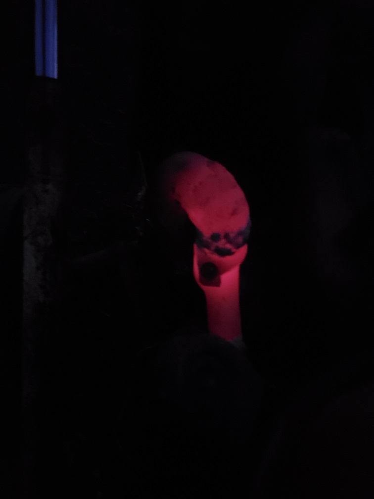

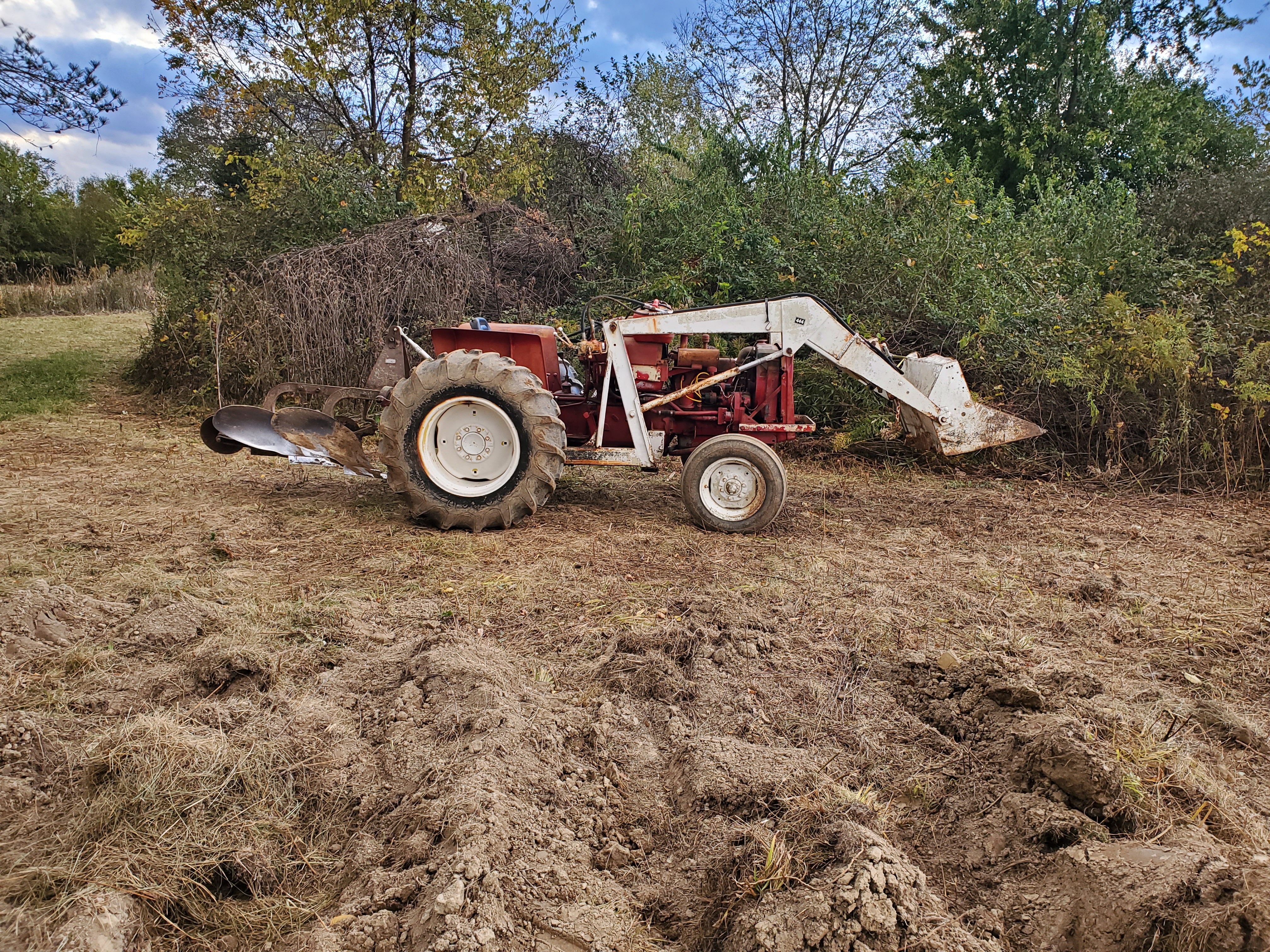

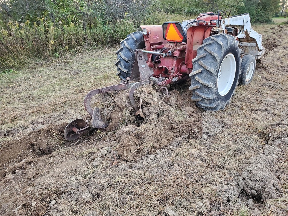

We got a 2 bottom dearborn plow. Over the ripped ground it was a bit tough to get the plow to turn the ground over, it liked to catch the "sod" on top and clog with the carpet patches.
That aside, when I came out of the field after running the plow the most (didnt finish, got too dark so I continued the next day) the exhaust was glowing red. With the hood off sine I've been working on the tractor the glowing exhaust caught me off-guard. It was a substantial red glow coming from the engine at dark.
A friend of mine is suggesting that the fuel mix might be way off.
Thoughts?
Another issue I found is the wide track width of the drive tires does not work well with the plow - the right side drive should sit in the bottom of the furrow with the front steer tire. That doesn't happen - the drive sits above and rolls over the turned over ground.
After I took this picture I switched sides - I was plowing over the turned over ground going this direction. However, that made no difference in the sod clogging the plow.

You have solid non-adjustable wheels. With the AG two piece wheels or the power adjust wheels one can adjust the wheel spacing to let the tire run in the plow furrow.
There is a good thread on here that explains how to setup a tractor with a moldboard plow.
/ International 444, 1968. Progress Thread, Getting Going #89
Dieselscout80 is absolutely correct. You have pressed steel wheels and they are set as narrow as it will go. Whereas a tractor set up for Ag./row crop use has a 2 piece set up with a center dish, and looped rim. Width can be adjusted by setting loops on either side of the center dish, or even flipping the concave center dish is or out. And more than likely on an Ag. tractor rear tires may be a lot narrower like a 12.4 width. Here is another link from Case/IH showing the difference: Case IH | Schematic, Manuals, Specifications and Diagrams for wheels and wheel weights, rear wheels | MyCNH US Store What you have is on the left, what we're describing is on the right.
To be set up correctly, the end of the first plow bottoms share should be even with the inside of your right rear tire. When making the second round, and rear tire running in the previously made round that will make the plow cut the bottom of the furrow off clean into the previous pass furrow. If not cutting off cleanly it usually kicks the plow sideways towards unplowed ground, and will turn over, or try to turn over the extra width of sod/soil between the inside of the rear tire and end of share. That appears to be a 14" bottom plow, and with your tire spacing you may be trying to turn over 16" to 18" or more of sod. When that happens you get the results of what you have. I do see some adjustment left on the crossbar the 3 pt. lift arms attach to, but not sure it is enough to get the end of the share to align with the inside of the tire. You can eyeball that distance setting on the ground, and measure how much you can slide that bar, but looks like about maybe 2" at best.
The least expensive option would be to find a decent pull type plow (assuming the tractor has a mounted drawbar that I can't see) there may be enough adjustment on the plow hitch to set it over far enough to match. If not, a 3 pt. drawbar in the 3 pt. lift arms has various holes to adjust sideways.
If you decide to go this route, find a plow that the shares a good on or at least a brand you can still get new shares and moldboards for. You can still get now wear parts for most older IH, John Deere, and Oliver plows. The mechanical lifts most generally work great. They can get caked up with dirt & grease in the lift mechanism, but cleaning them up and new grease, they'll work great. I see you have a rear hydraulic remote, so a hydraulic lift plow would be great, but more expensive, and many don't have the cylinder with them so there's more $$$.
As for the red hot exhaust, yes, it could be running lean, or timing could be off too. If timing is retarded it will make the exhaust hot. Too far advanced can burn the pistons. If you have a timing light, or access to one probably best to set the timing that way. But in reality, if you're working it hard, probably not uncommon, and more than likely why the manifold is cracked as you described. Always best to let them idle for a while to cool down after working them hard. I'm assuming by the time you got to where you park it, it may have cooled down enough not to glow. I'd set the timing first you can tweak on the carb. when working it and see if it makes a difference.
One other thing, it's pretty dry to be plowing now. You want a smidge of moisture, but not wet. I suspect subsoiling before plowing didn't help when it's this dry. It can actually pull the topsoil loose from the subsoil. Had that happen 6-8 years ago when I tried running my subsoiler in some wet spots in the hayfield, it literally pulled slabs of topsoil loose. I just let it go until we got some rain and worked much better.
Thinking through this - If I narrow up the tractor that is going to be a significant help all around the farm, not just in plowing. And depending on how narrow I can get it - I might even be able to get it on my trailer.
Do you have any thoughts on how to track down a 2 piece wheel set?
The tires I have now have a lot of tread life left. They aren't the same tires, but close enough - same "size" and the tread wear is about the same. I'm thinking it would be great to be able to swap those to another wheel set, but with the age of the tires I don't know if they will survive dismounting them and remounting them?
