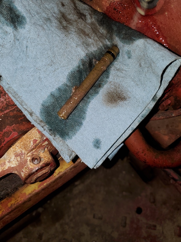

As to the suction filter - the diagram I have in the ops manual isn't very clear on the exact locations of what filters.
That said, I pulled one of them that looked to be about 2 to 2-1/2" long and about 5/16" diameter and cleaned it off a bit. It just had some goo on it, no debris. I can't tell you if it was specifically the suction filter or not.

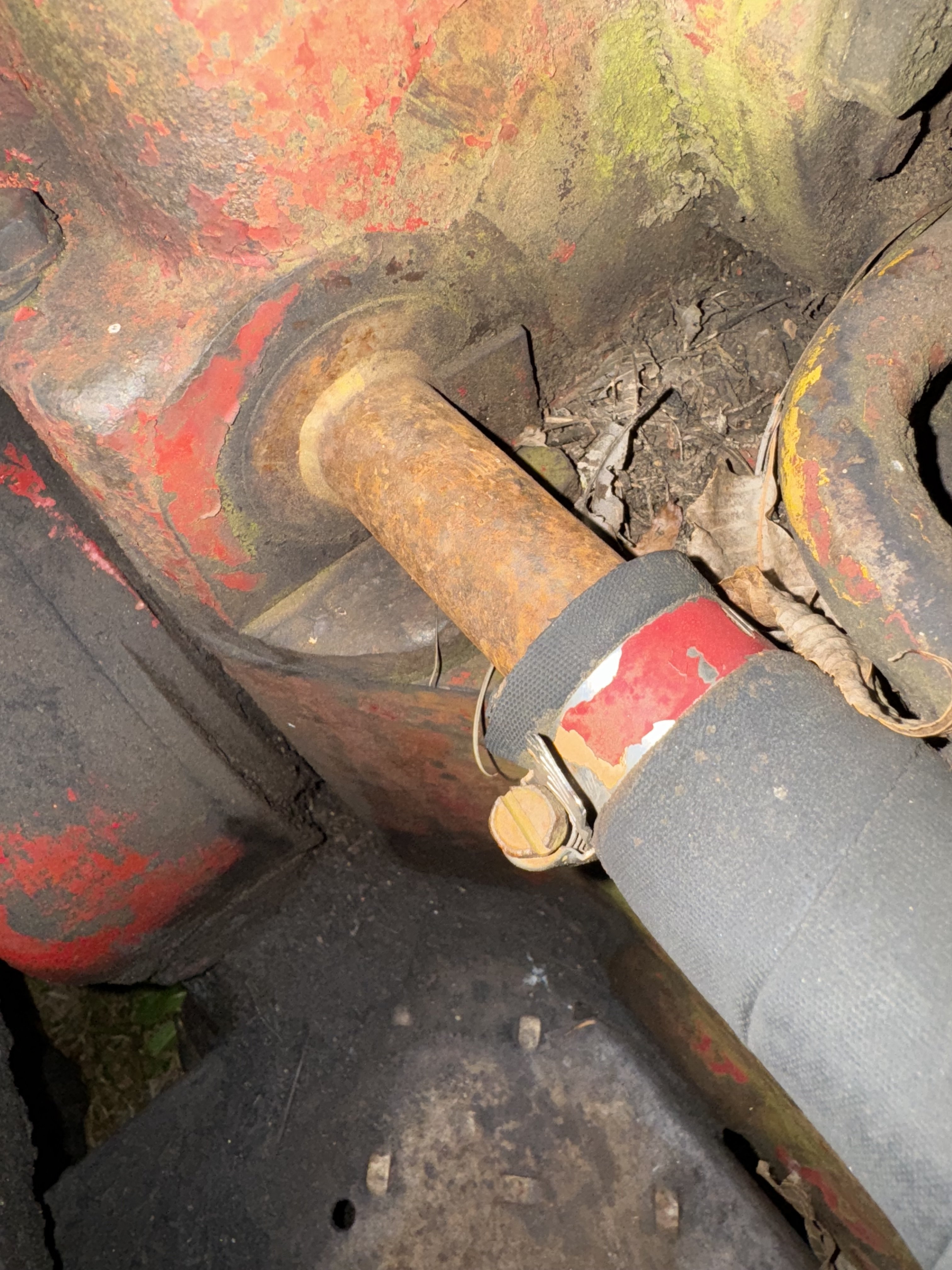

That one is in the valve assembly.
The suction screen is the larger hose coming straight out of the bottom of the tank which is what your seat is mounted to. There is a bolt with a metal tab that holds the suction screen in place.
Remove the bolt and tab and then disconnect the hose/hose clamps and slide the short piece of hose forward and then suction screen pulls out.

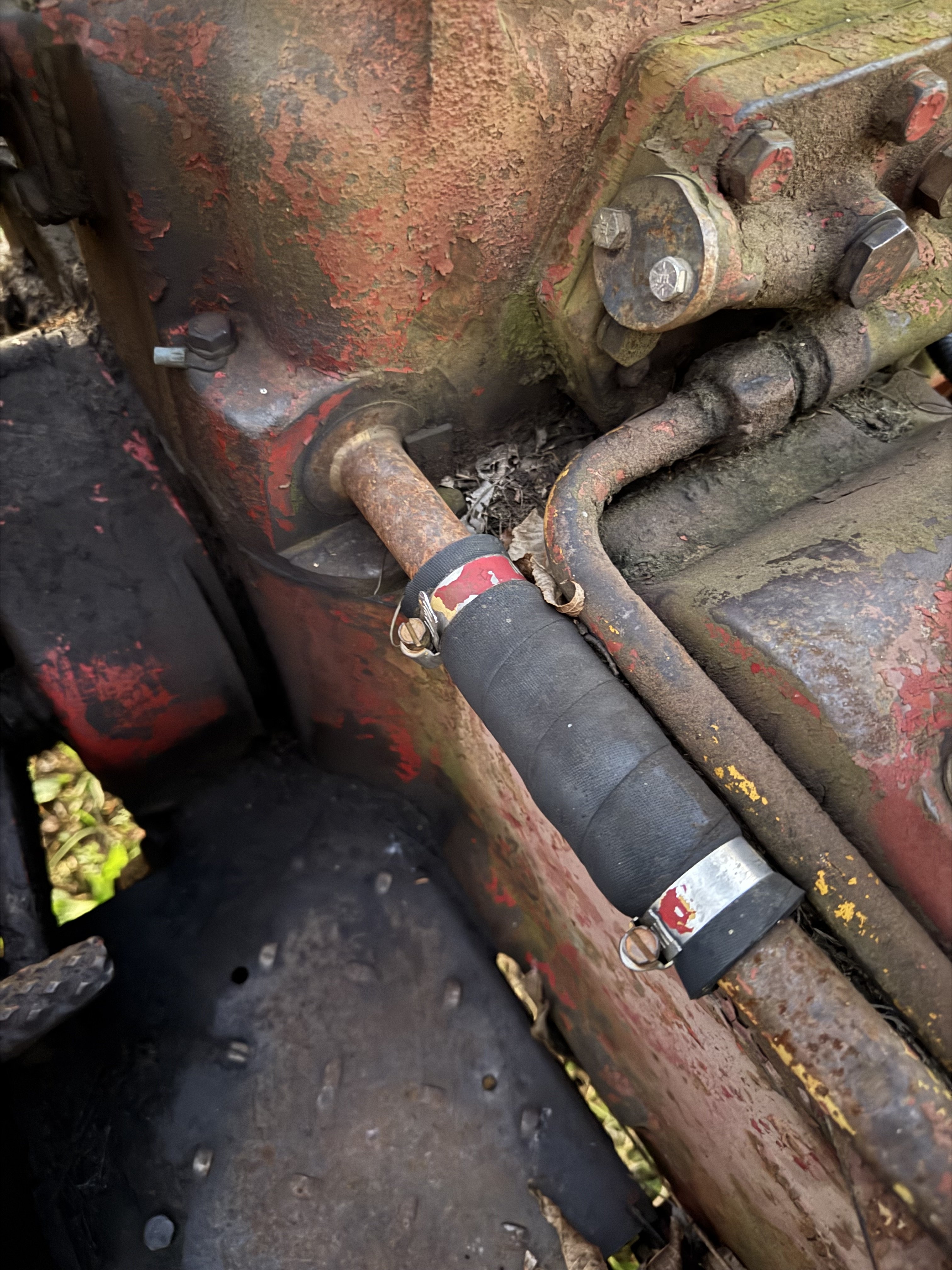

/ International 444, 1968. Progress Thread, Getting Going #111
This is it. Spray some lube on the front edge of the pipe and work the hose back and forth while twisting and once the lube gets between hose and the tube it will get moving.

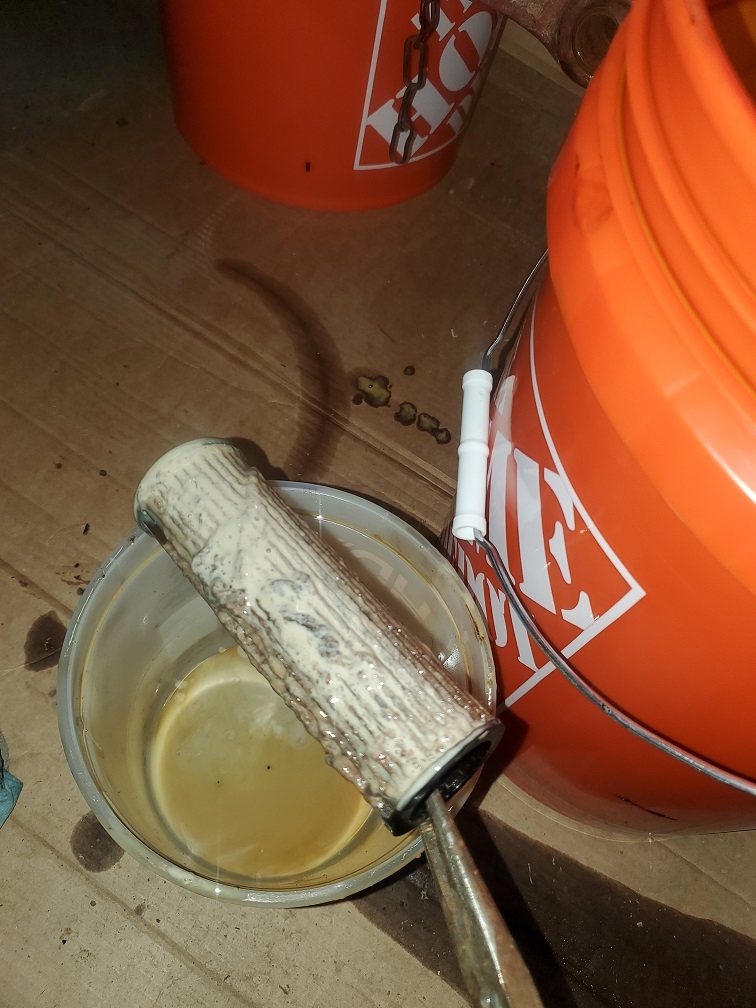

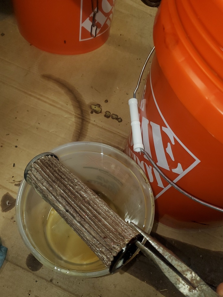

I was able to work the rear of the 2 rubber hoses loose with channel lock pliers. I got a bite on it on one side and worked it back and forth until it broke free, then went to the other side and did the same thing. No need for any extra lube - the bit of oil still in the line was plenty of lube.
Here is the filter I pulled out of there:

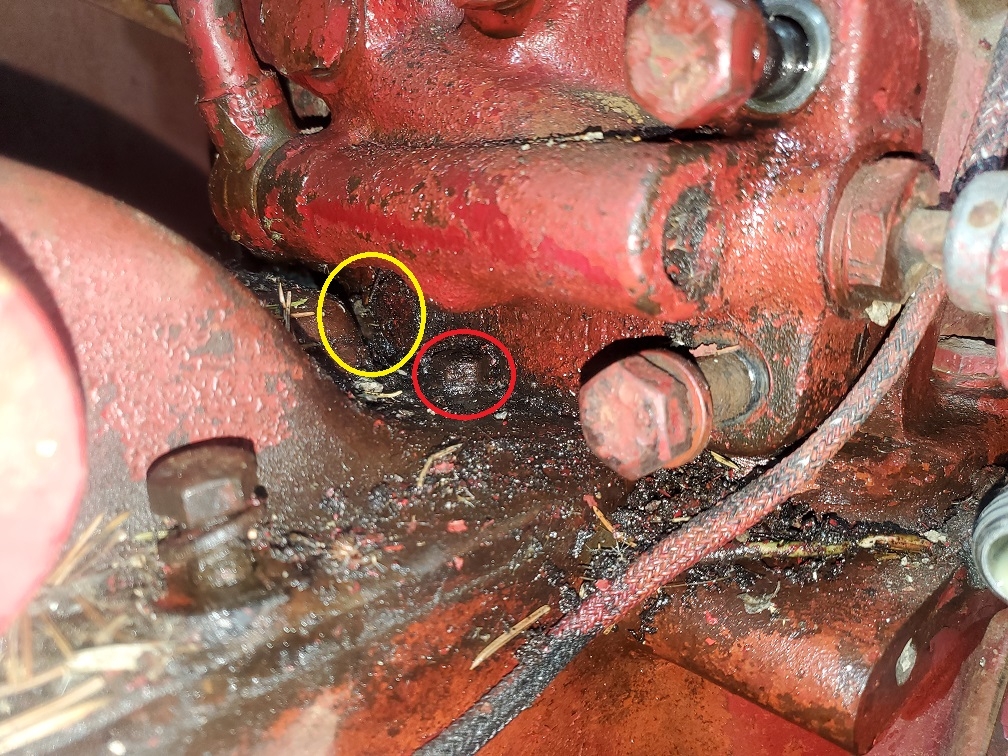

Now the next conundrum. How do I open up the top of the trans? See the picture below. The yellow circled bolt is the last of the ones holding down the trans cover. The valve block behind it is in the way. And to get the valve block off the yellow circled bolt has to come out, but the trans cover is in the way of accessing it. I tried to get various wrenches on the small trans cover bolt and got it to move a little with a crows foot, but I can't get any range of motion on it to spin it back out.

The hydraulic system only has the two screens in it that are posted above. The suction one is larger and the other is a bit bigger than the diameter of a pencil.
The original poster has posted pictures of them.
/ International 444, 1968. Progress Thread, Getting Going #117
Is that a convoluted metal mesh hydraulic filter..?? If it is, I wouldn't be a bit afraid of washing it really well and reusing it, as long as there are no holes in it, and rubber seal isn't torn.
Yeah my suction filter (1st two pictures in the post I quoted) looked like that the first time I took it out to clean it.
I think the hydraulic tank/valve assembly has to come off to take off the transmission cover off, but I am not certain of that. If you have to take off the tank (where seat mounts) will need a hoist to lift it.
Well some bad news, but not a total killer - you are correct. According to the service manual IH-201 page 57 paragraph 148A - it describes removing the [transmission] "top cover and hydraulic lift housing" in that the latter has to be removed for access to the former - just as you thought.
Since I have the front and rear remotes, plus loader, I have all the hydraulic options = all of that has to be dismantled as it all mounts to and plumbs to the lift housing, along with the rockshaft for the 3pt lift.
