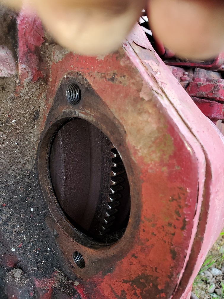

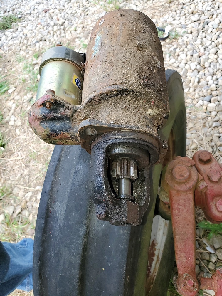

Here are a couple pictures showing the ring gear and starter. They aren't the greatest, but the ring gear doesn't appear to have any "missing teeth" in the area that is exposed. Just the gear on the starter seems like the tips of the teeth are worn down.
View attachment 883768View attachment 883769
I've seen gears a whole lot worse, but being you had to lube the bendix to get it to work somewhat better, wondering if it wasn't fully retracting causing wear on the flywheel teeth. Most have a pretty sharp edge. Some straight, some on a bevel.

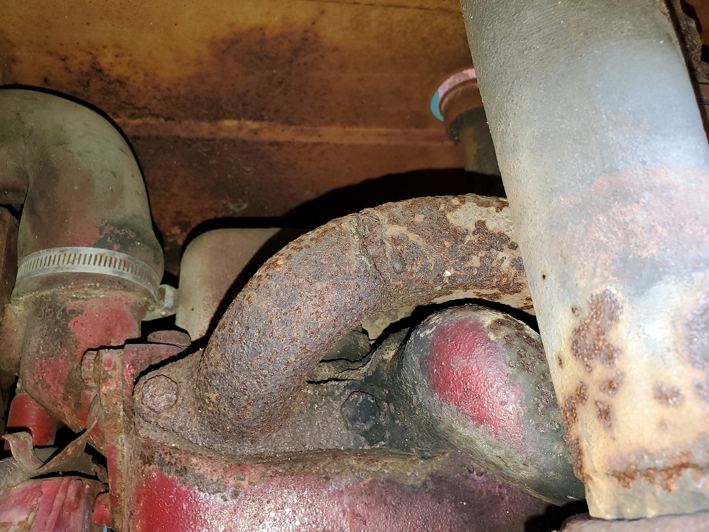

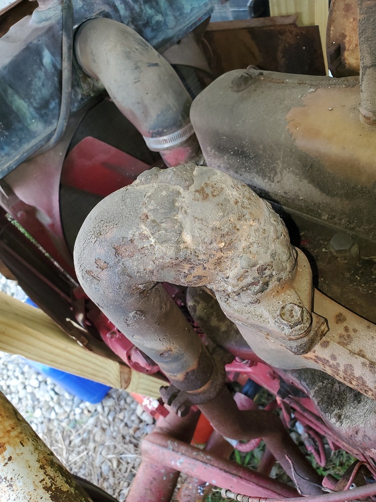

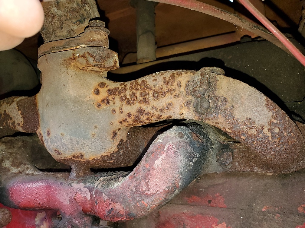

Welds on the exhaust pipe aren't pretty, almost looks brazed rather than a weld, but either way rusty pipe is not easy to get a good looking weld on. As my buddy used to say, "Pile it up high enough, there's no way it's going anywhere."
