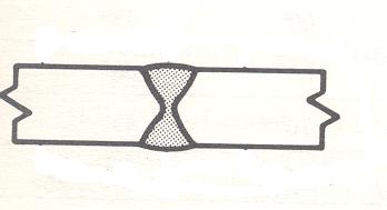

No pics, it got dark before we got back. But it's 2'x8' and already has pipe legs welded onto it. I really don't need one that long. Seeing as it's kinda narrow, I thought about cutting it in half and rewelding it to make a 4x4 table. Just don't know if my welding skills are up to doing a 1/2" thick butt weld.
Oh give me a break! Nothing to it, you can handle the welding. No one says you have to weld overhead. Bevel both sides, tack both sides real good, weld a little on one side, flip it over and weld some on that side. Repeat as many times as necessary.;)

Not to steal the thread, but question for you Shield Arc, when you flip the sheet over do you weld directly opposite of what you just welded,or do you weld in a completely different area. Also correct me if I'm wrong, but this is to control warpage right? Thanks
That's what I'd do! Also keep an eye on it with a good straight edge. If it curls one directions, put more weld on the other side to pull it back. No need to be in a big hurry with the welding, let it cool, or you will warp it. But then we can straighten it too. ;)

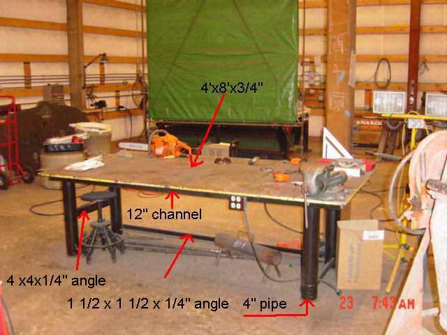

Haywire what's under that table far as bracing? Any C-channel, or angle iron between the pipe legs?
The frame work under my table was a table I built for a large diesel drive welding machine I had, sold the machine but kept the table, worked out great to lay a piece of 3/4 inch plate on for a welding table.
