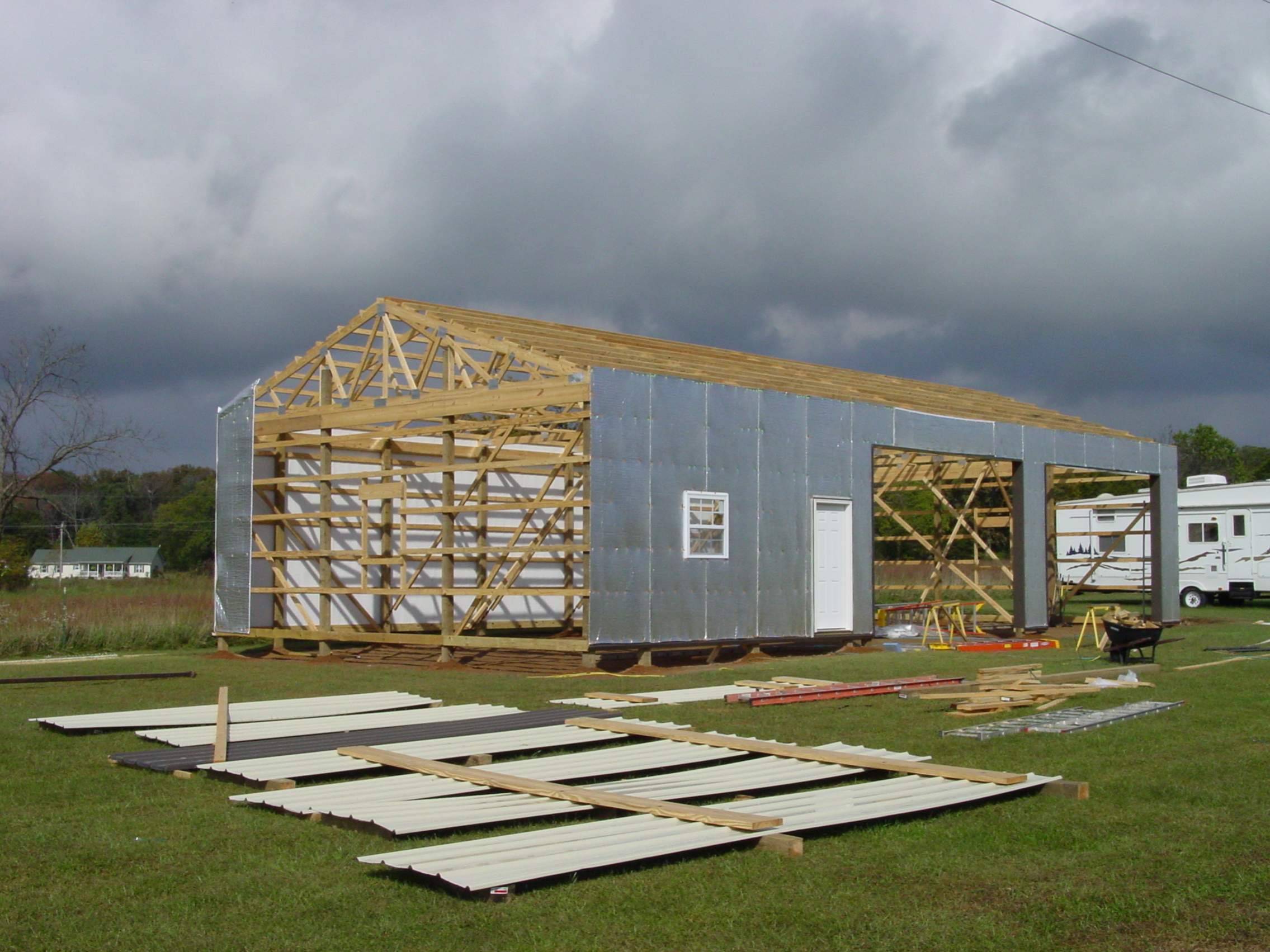

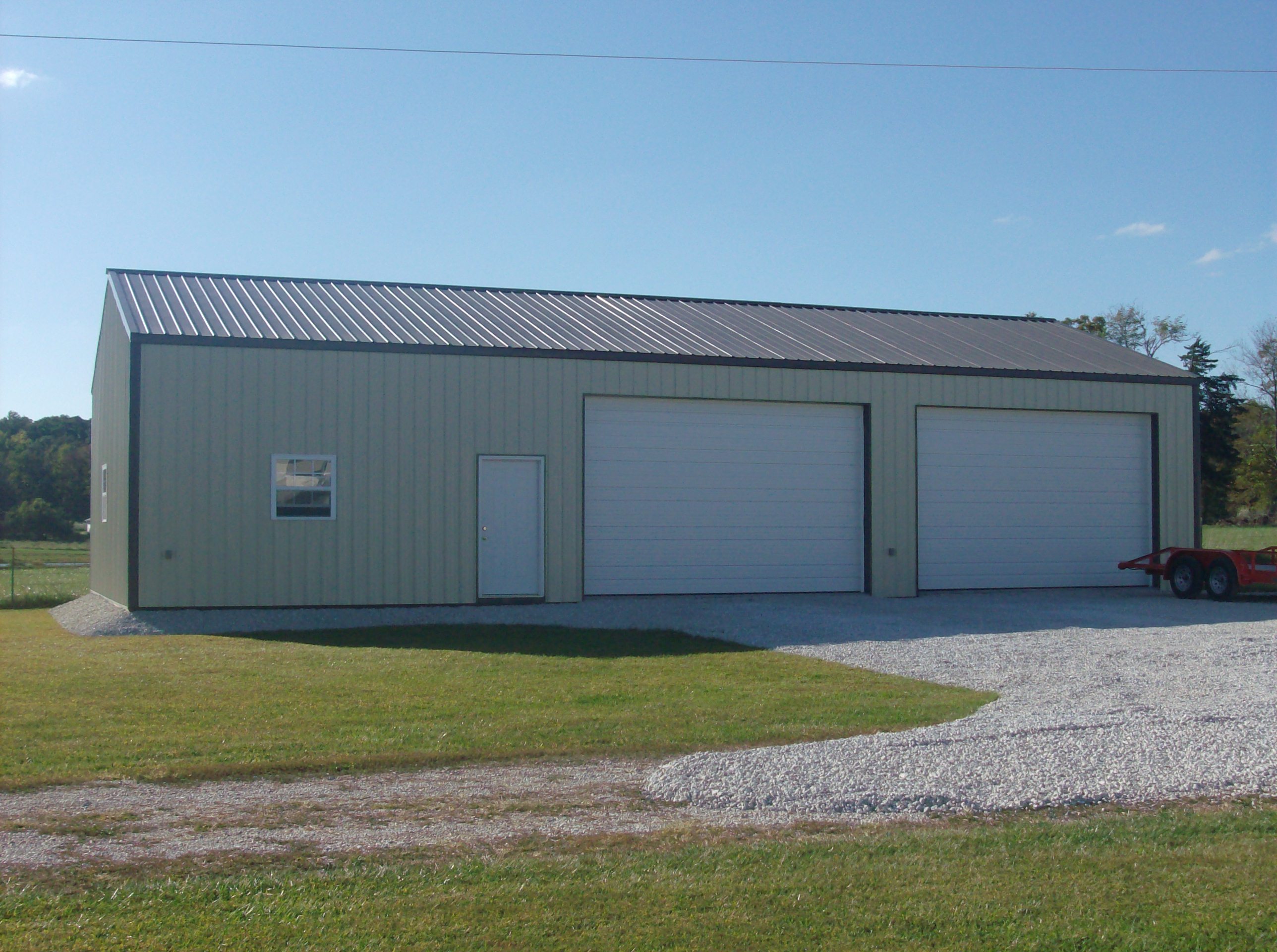

I insulated my 30X60 shop with 1/4 bubble wrap before the aluminum was installed. We did the roof and all the walls. In addition I also installed insulated overhead garage doors. Temperatures averaged 15-20 degrees warmer inside before heat. Using a kerosene torpedo heater, I can get it comfortable in about 20 minutes. I have no issues with moisture, which can be rough on tools and equipment. I agree, good insulation is everything in a shop. Mike.
