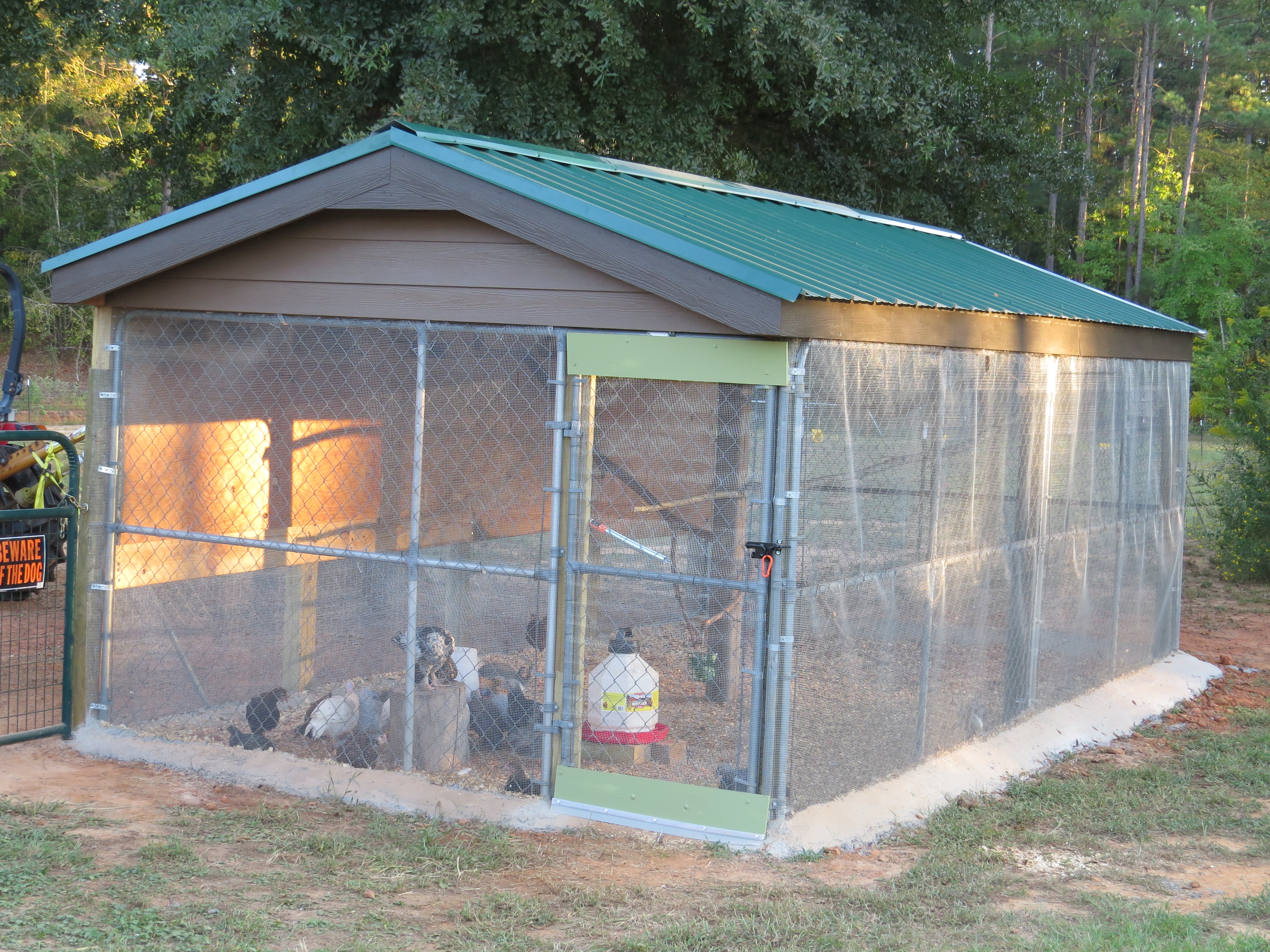

The smaller the air gap that you have, the less condensation you will have. Without removing the metal roof, and doing this as cheaply as possible, I would strongly suggest cutting and fitting the panels in between each purlin. There will still be a small amount of condensation that forms, but I doubt it will be enough to worry about. The best way to deal with that small amount of moisture would be a ridge vent. Home Depot sells a metal ridge vent for a fair price that could easily be installed over your existing ridge. Just drill holes near the peak of every roof panel so air can flow out of there. Cooler air will enter under the roof at the eaves, and rise up along the underside of the metal, drying out the metal, and exiting at the ridge peak.
Here is a picture of the Home Depot ridge vent that I put on my chicken coop.
/ Roof Insulation vs. Condensation
#13
If I understand your question, you are going to install the panels to the bottoms of the purlins, not between them? And since you are installing them to the bottoms of the purlins, you will create a 3 1/2 inch air gap between the panels and the metal roof. This gap will allow condensation to form on the bottom of the metal, and that condensation will have no way to dry out or drain away.
