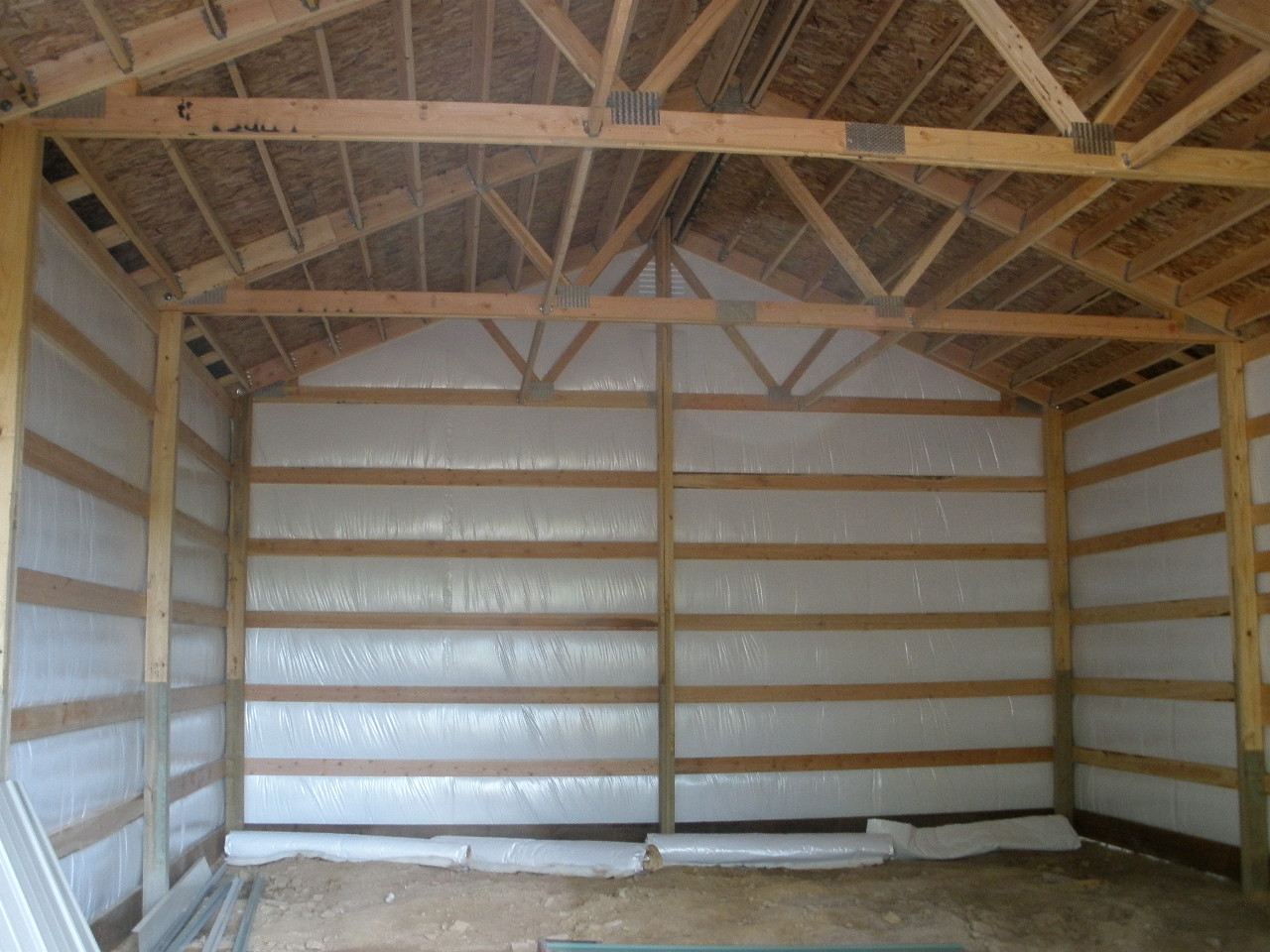

I recently insulated and finished my pole barn. You didn't mention what you are doing with the ceiling, but the ceiling insulation is more important that the walls. I put a vapor barrier under the trusses, followed by metal liner plate, then blew over 6 inches of celllulose in the ceiling.
For the walls I bought some used polyiso (high performance foam insulation) from a roofing company and fit that into the walls. Styrofoam is not great insulation. If I had it do over and didn't have the polyiso available, I would put cellulose in the walls. Put tyvek or some other building wrap against the girts, put a vapor barrier over the inside of the poles, add drywall/OSB/Metal panels/etc on the inside, leaving a gap at the top that can be closed after blowing the cellulose into the wall cavity.
Cellulose is the most cost effective insulation out there and it's super easy to blow in.

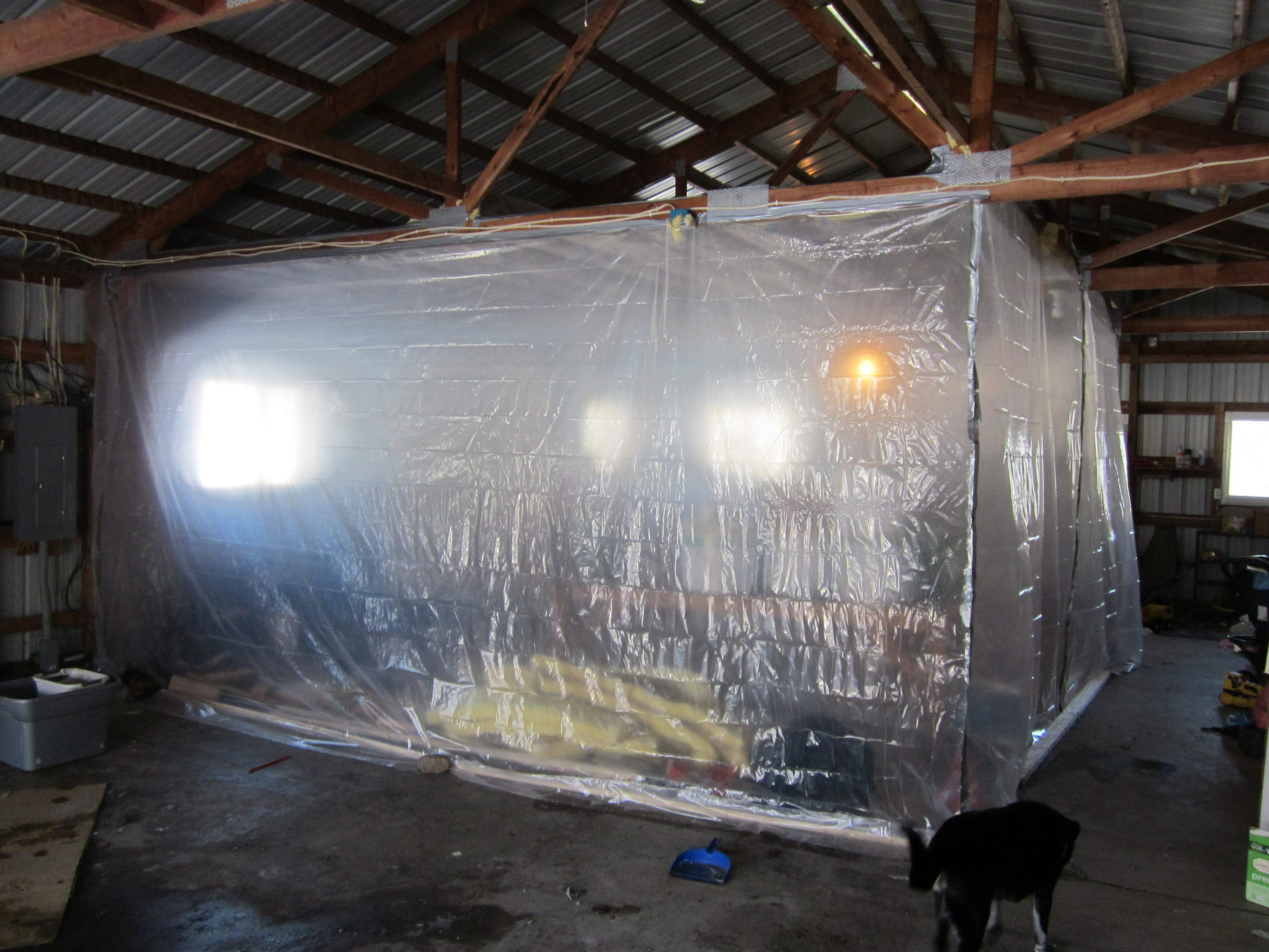

I am in the process of making a drop ceiling at 9ft (originally ceiling is 15 feet - so there will be a space between the original ceiling and my drop ceiling). I studed between the joists for my ceiling and am in the process of laying kraft-faced fiberglass insulation R11 - it is cheap and will at least hold in some of the heat. I am more concerned about the walls and if I need a vapor barrier. I will use the polystyrene, simply because it is cheap and pretty hassle free. Do I need a vapor barrier with polystyrene?
Half of the garage is going to be uninsulated (30x30) where I park my cars, trucks, toys, etc. The "heated" part (the other 30x30 I am insulating) will be used for the kids to play in and to do regular vehicle maintenance when it is too cold in the winter.
So, do I still need a vapor barrier in the walls of the insulated part if I use polystyrene between drywall and metal?

I would say no... you want the insulation and everything to breathe as much as possible.... You have a lot more moisture in that barn than a normal house... [ but, then again, I am just an old uninformed retired furt... ]
/ Insulating My Pole Barn - need help #24
I'm going to say use the vapor barrier. I've never seen an effective insulation system without a vapor barrier. The vapor barrier should go next to the heated space. I doubt you will get the styrofoam to ever seal well enough to form a barrier and that pretty well ruins the insulation value.
Being as far north as you are, condensation won't be much of a problem since the siding will be naturally ventilated anyway. I never saw condensation in my pole barn before I finished it. Be sure you have roof vents and a way to get air above the finished ceiling. In any event, I wouldn't put the foam directly against the metal because it won't be really against it. There will be all kinds of spaces to trap air/moisture.
I don't mean to start an argument (although that happens to me often) but I think you need to look carefully at the cost and results you will get. Cellulose almost has to be cheaper than styrofoam. I put about 6 inches of cellulose in my 40x48 pole barn attic for about $300.

I will start by saying this may not be the correct way but this is how I did mine. I have a 40x81 Cleary building. It has a 1 foot ventilated overhang all the way around and at the peak a continuous cap to let the warm air out.
I got about 3500 square foot of used rigid foam roof sheeting, 3 inches thick for $300. I cut the 4x8 sheets to fit between the ceilings nailers 2 foot on center. I used screws in the nailers to hold them up but I cut them so close to size that they nearly held themselves in place.
I got new offals of Pink Dow rigid foam in 1/2 thick. On the side walls I attached them the same way but in two pieces for 1 inch thick. I staggered the seams. I did my 5 overhead doors the same way. The side wall insulation was under $150. The screws were fairly expensive but overall I think I had about $600 total in the project.
I did this because on a few days it would rain inside. Condensation formed on the bottom of the cold roof and then would rain down. Now maybe it just rains down on the rigid foam and is making a mess in there, the hope was there was enough insulation to avoid the condensation. The building certainly is more uniform in temperature and certainly cooler in the summer. I have a dirt floor at this point and no heat or electric in it.
Certainly not saying it is right, only how I did it. If a problem it would not be hard to remove, take the screws out.

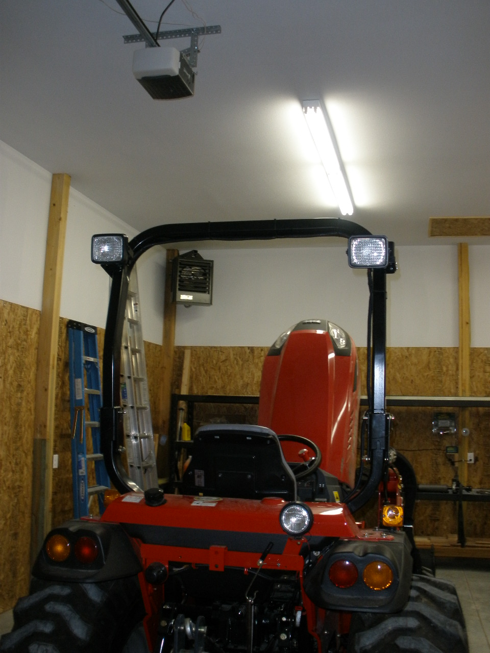

When I moved to my present house in SE Michigan 11 years ago the 24 x 32 x 12H pole barn was going to be my new woodworking shop, so it had to be insulated so I could use it year round. I happened to get a good deal on some "seconds" plywood to keep costs down. I nailed 3/8 thick to the ceiling and screwed 5/8 thick to the sides after putting in 6 inch fiberglass insulation on the sides. I blew in about 12 inches of cellulose in the ceiling. But I did make an access hatch with 4 inches of rigid foam. In the two front sliding doors I glued 2 inch rigid foam between the 2 x 4s. And then I mounted sections of the garage seal stripping on the inside by the sides of each door and along the top (this also helps keep even small critters out as I have never even had a mouse inside). Drywall could be used for the ceiling and sides but the plywood worked better for me since I have all kinds of bins, parts cabinets and wood racks mounted to them. The insulation was all purchased at the same time I added some fiberglass and cellulose to the main house and so was able to claim it as an energy credit. I have a small ceiling mounted Reznor natural gas heater that doesn't have to run to often to keep it at 62-64 degrees in the winter. The other plus is on a 90 degree summer day it stays in the low 70s as long as I keep all the doors closed. I did not add a vapor barrier and have not had a problem with humidity. And after all the plywood was up I sprayed the sides and ceiling with white paint. My ten double 4 foot florescent fixtures give plenty of light with the white paint.
