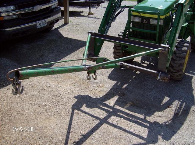

I prefer a boom for lifting:
I do have small hooks on my bucket, but seldom use them, much prefer to use the boom. I store my tractor/loader with the "quick-tach" bucket off, so I just put on whatever I need at the time, bucket, boom or forks. ~~ grnspot

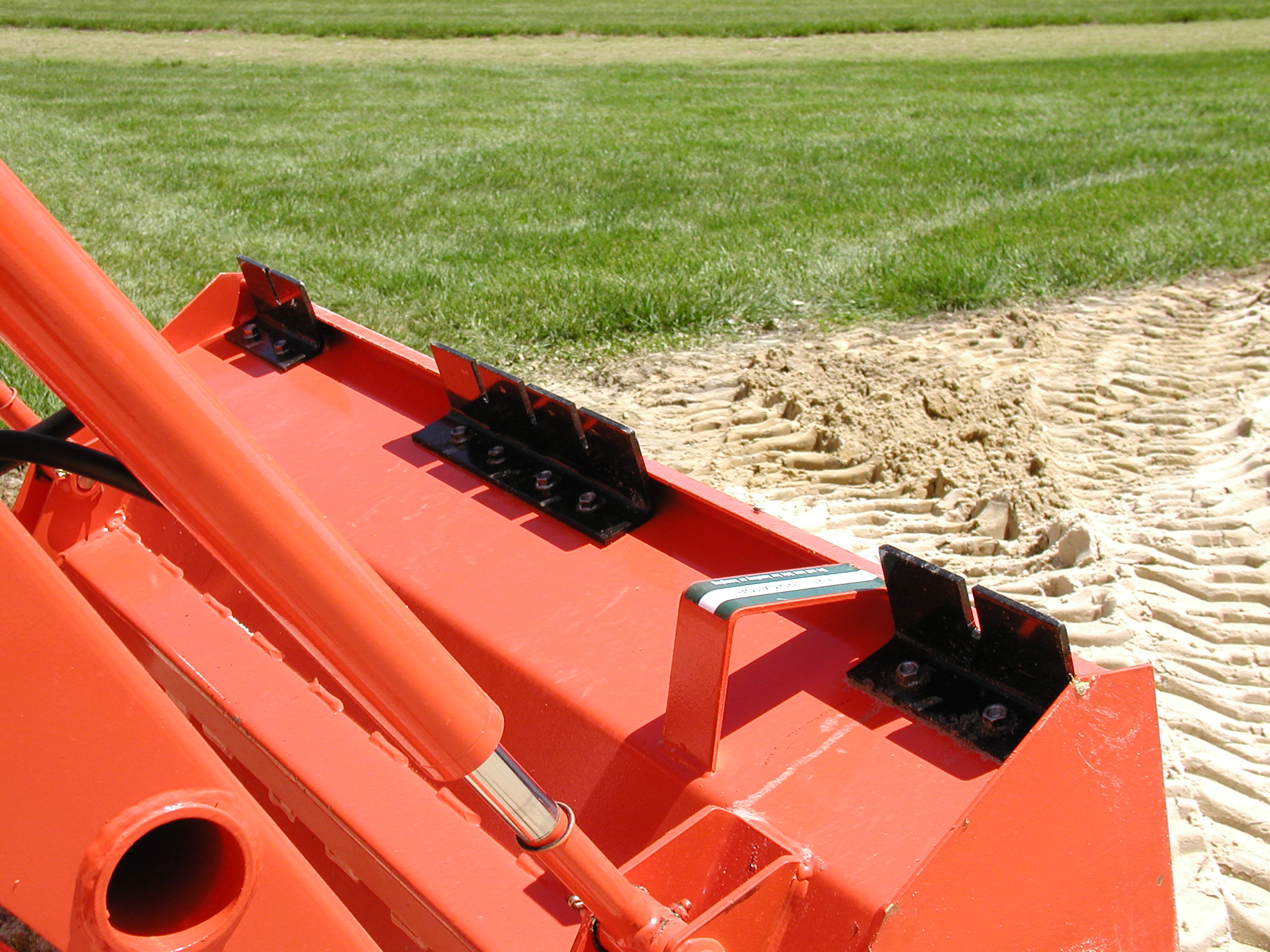

Here's what I did for the last two tractors. Pieces of heavy angle iron with notches cut to drop chain into. They're a lot handier than hooks and with all the notches you can do multiple loops of chain. It's also easy to throw leftover chain into the slots to prevent it from dragging. Simple matter of drilling holes for the ends of the slots and then making two saw cuts from the edge to each hole to get a nice slot with a rounded end. Bolt-on installation and tough as nails. Never bent anything and I've hooked onto a few things the tractor refused to pick up.
<img src="http://www.tractorbynet.com/forums/attachment.php?attachmentid=308786"/><img src="http://www.tractorbynet.com/forums/attachment.php?attachmentid=308787"/>
Nice and simple. I really like that!

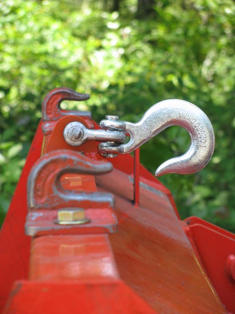

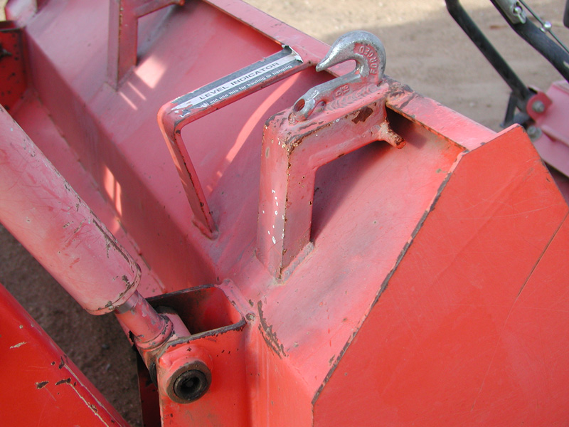

I think you should contact Ken at Ken's bolt on grab hooks. He is The Bucket Hook Guru here on T-B-N and I am sure he is familiar with your B7300 Kubota and its bucket. Very helpful person. Read the section on his web site regarding bucket reinforcement. I have used Ken's 5/16" bolt on grab hooks in forestry work WITHOUT REINFORCEMENT for 18 months with no problems. My B3300 is a couple increments up the Kubota scale relative to your B7300. If I have not had problems in heavy use, you certainly will not either.
But ask Ken......
Ken's Bolt on Grab Hooks
