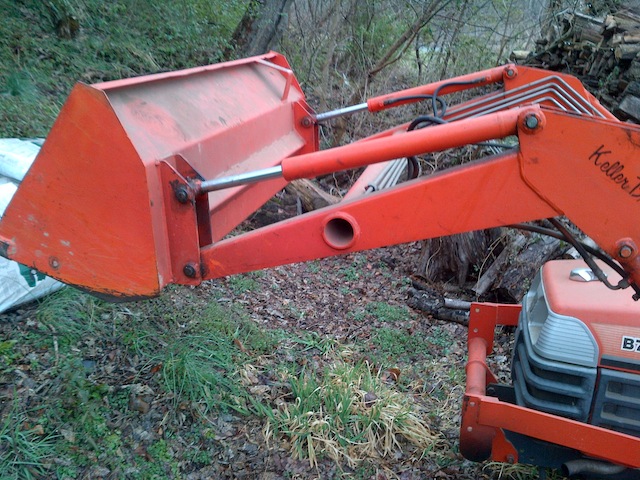

The guys who make bucket hooks tell me my loader bucket isn't big enough to handle them. Now I'm looking for something else that will let me lift things that are too bulky to go in the bucket.
Here's my latest brainstorm: The crossbar between my boom arms is a hollow tube. I'm thinking to run a length of heavy chain through that tube, and put hooks on either end. I can hang things from the hooks, and the hooks will stop the chain from falling out of the tube. Any reason that's not a good idea?

Personally, I would reinforce the bucket edge and put hooks on them.
If you put the chain thru the tube, it would work, I think, but being behind the bucket, it would not be as convenient for hooking up stuff.

I have done that on the last two tractors I've owned and have had great results with what you are suggesting. I also had bucket hooks on the last tractor and found them to be useful, but I use the tube and chain setup more frequently. I drilled a hole in the center of the tube and placed a grade 8 bolt through the tube and through the center-most link in the chain, that way the chain can't shift. Works great.

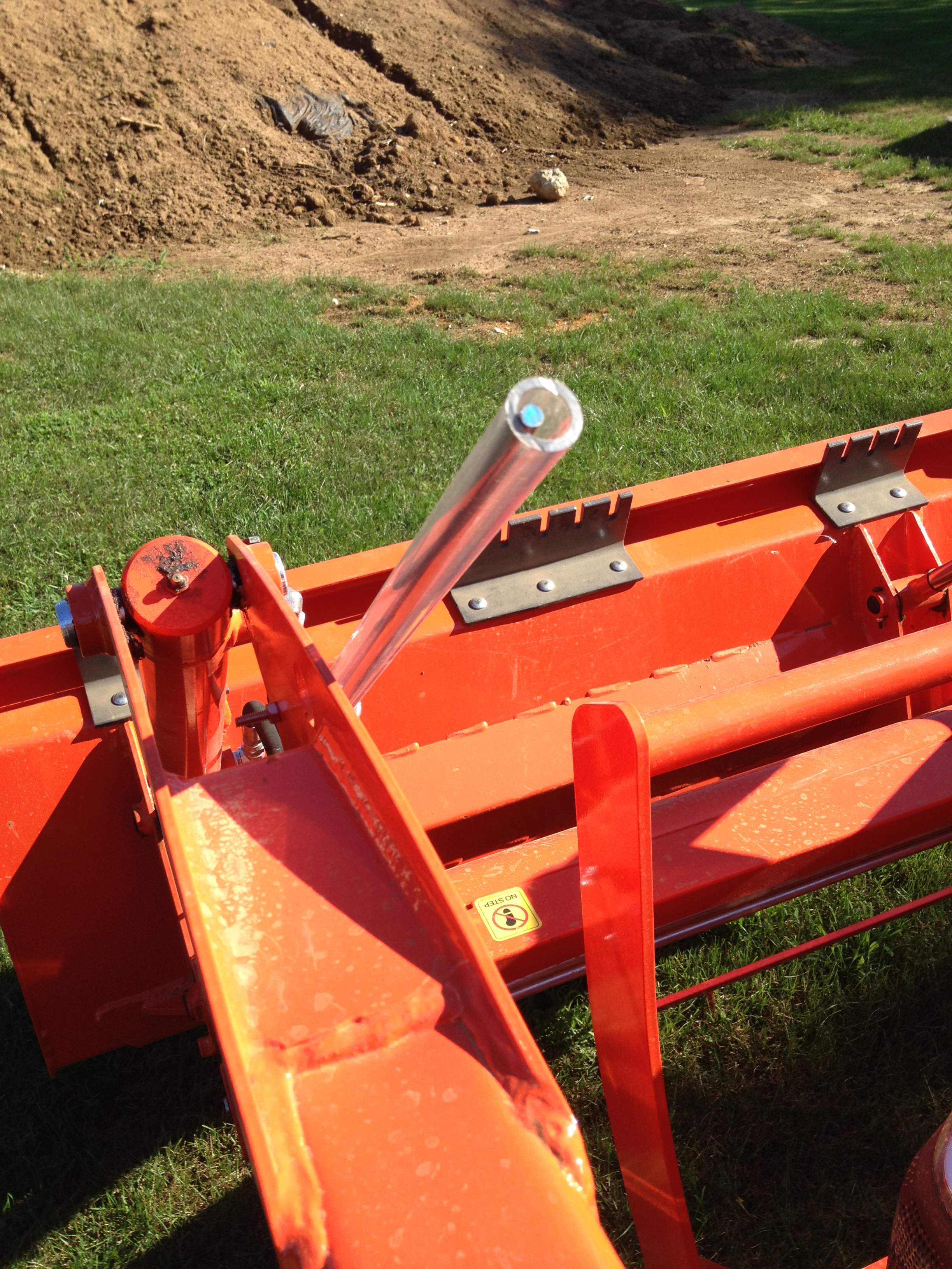

Here's what I did for the last two tractors. Pieces of heavy angle iron with notches cut to drop chain into. They're a lot handier than hooks and with all the notches you can do multiple loops of chain. It's also easy to throw leftover chain into the slots to prevent it from dragging. Simple matter of drilling holes for the ends of the slots and then making two saw cuts from the edge to each hole to get a nice slot with a rounded end. Bolt-on installation and tough as nails. Never bent anything and I've hooked onto a few things the tractor refused to pick up.
/ Instead of bucket hooks #18
<img src="http://www.tractorbynet.com/forums/attachment.php?attachmentid=308786"/><img src="http://www.tractorbynet.com/forums/attachment.php?attachmentid=308787"/>
Nice and simple. I really like that!

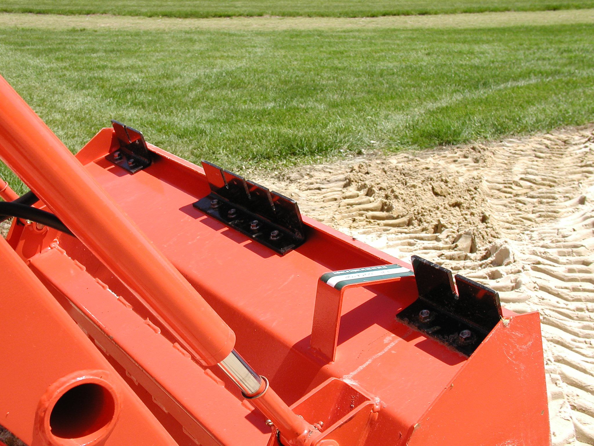

I think you should contact Ken at Ken's bolt on grab hooks. He is The Bucket Hook Guru here on T-B-N and I am sure he is familiar with your B7300 Kubota and its bucket. Very helpful person. Read the section on his web site regarding bucket reinforcement. I have used Ken's 5/16" bolt on grab hooks in forestry work WITHOUT REINFORCEMENT for 18 months with no problems. My B3300 is a couple increments up the Kubota scale relative to your B7300. If I have not had problems in heavy use, you certainly will not either.
But ask Ken......
Ken's Bolt on Grab Hooks

As for your chain idea, I think it would work OK, but the load would close to the grill guard, and I think you will loose a lot of lifting height.
