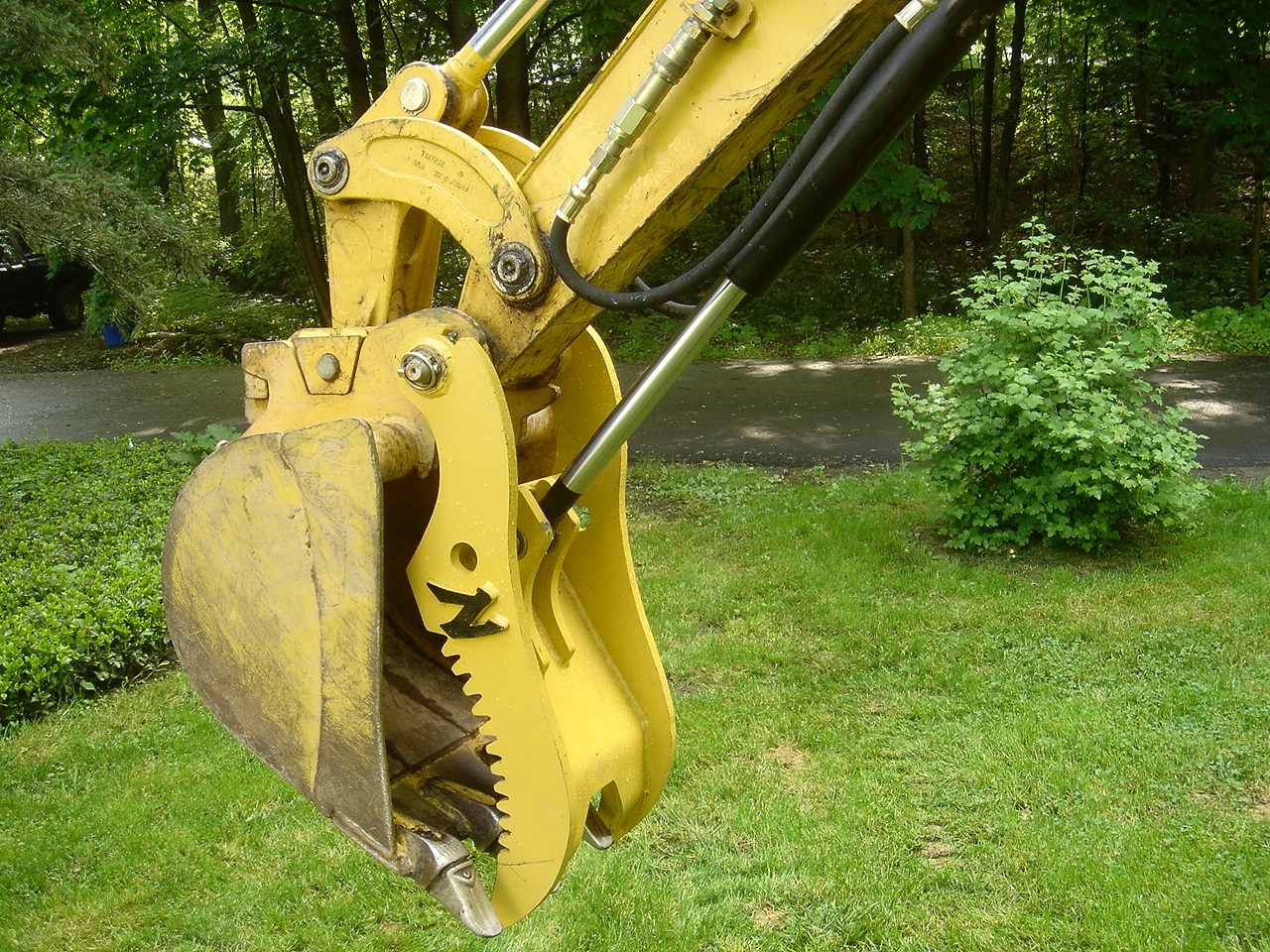

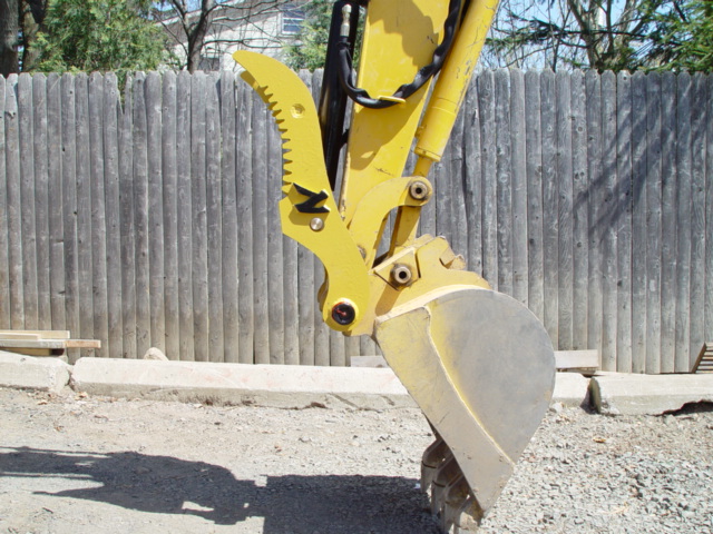

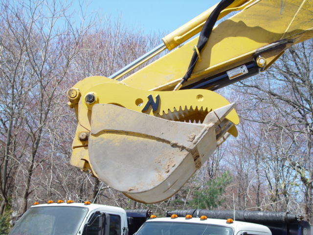

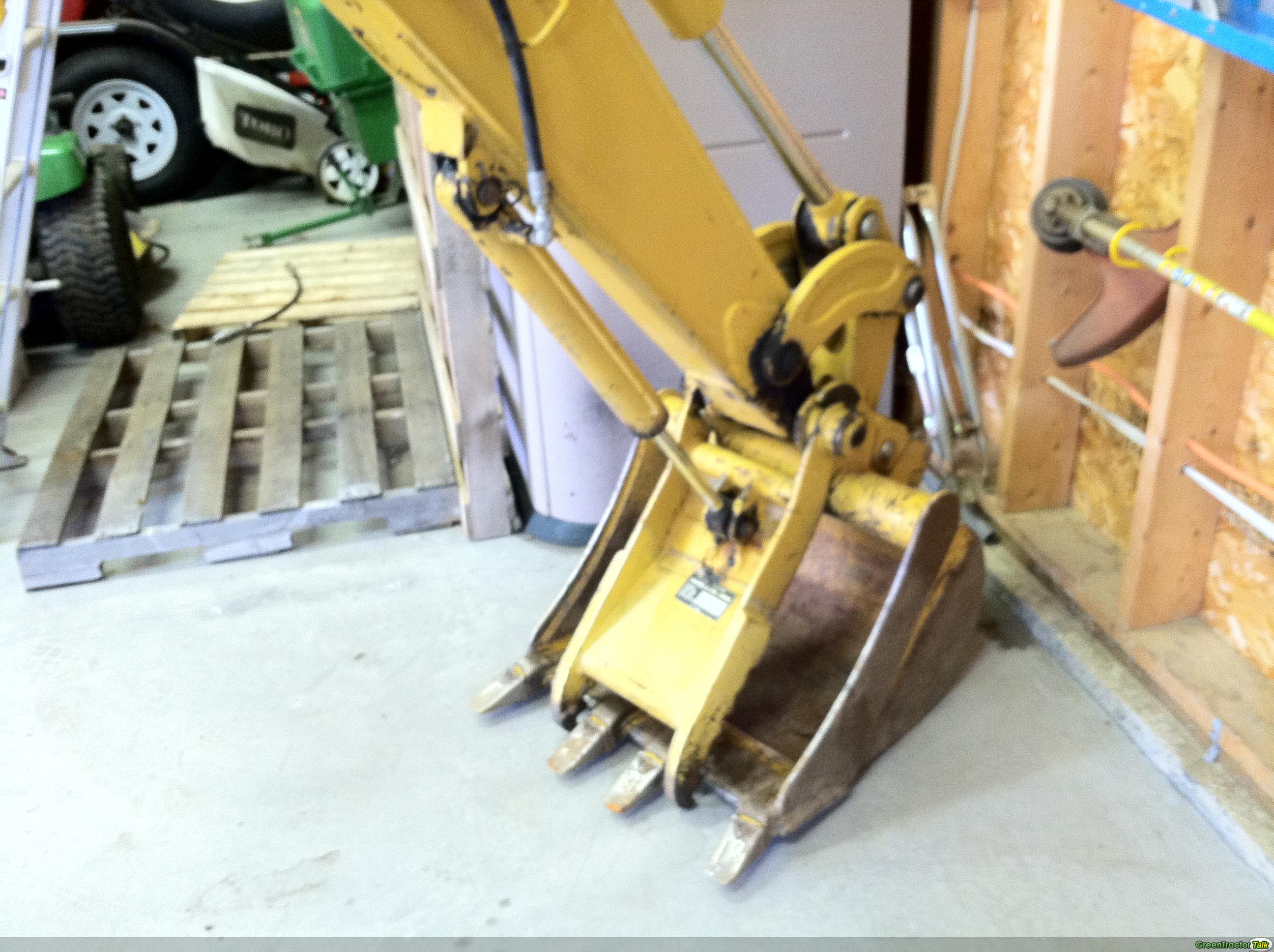

/ Increasing 110 tlb loader lift capacity #5

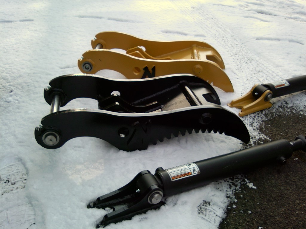

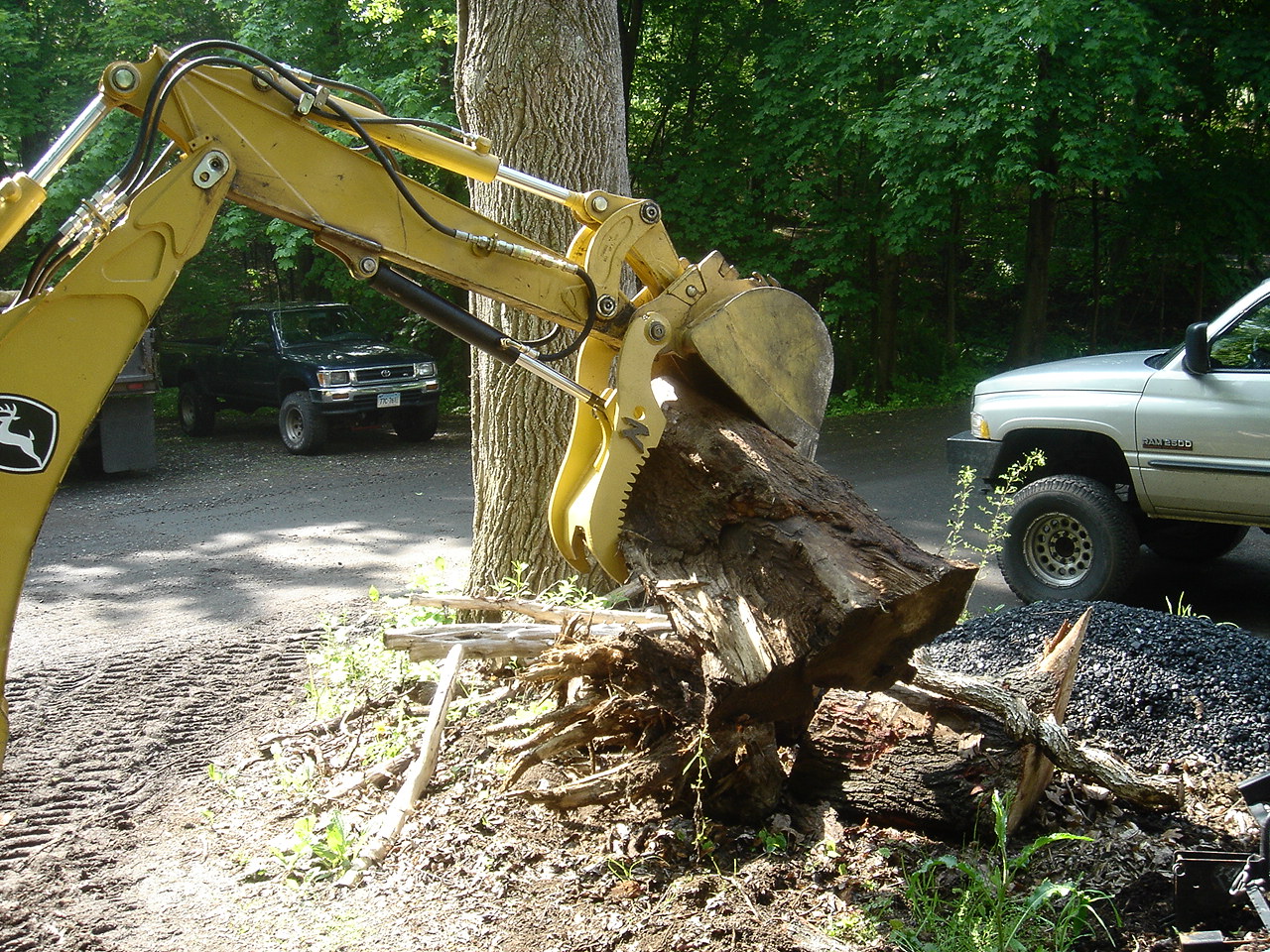

I want a hoe thumb...they're cool! Can you send a pic AKfish?
/ Increasing 110 tlb loader lift capacity #6
Here are some pictures of my thumb and hoe, 321647i_20.jpeg20120807_163630.jpgTLB 110 Clode up pics 002.jpgTLB 110 Clode up pics 003.jpg
/ Increasing 110 tlb loader lift capacity #7
Nice!!! There's been times where a thumb would have been really handy! Specifically concrete removal, seperating roots and dirt in a pile, cleaning my fence row (from either side), loading cross ties on a trailer and a million other chores/jobs!! An extendable hoe would be sweet too!! For that extra reach! I saw a backhoe the other day with a pivoting dipper arm. Not sure if I called that right but basically the backhoe pivots between the boom and dipper...crazy! Cool concept for digging right against a house footing or fence etc...
/ Increasing 110 tlb loader lift capacity #8
PBettis the thumb is one of those items that if you never had it you may not miss it but once you have had , used or seen one in action it becomes a must have.
There is a ytube channel of a guy from up here in Canada called Billstmaxx he has a TLB 110 and post allot of videos( many with the 110). He posted a series of videos of him making a thumb for his TLB110. You may want to check it out.

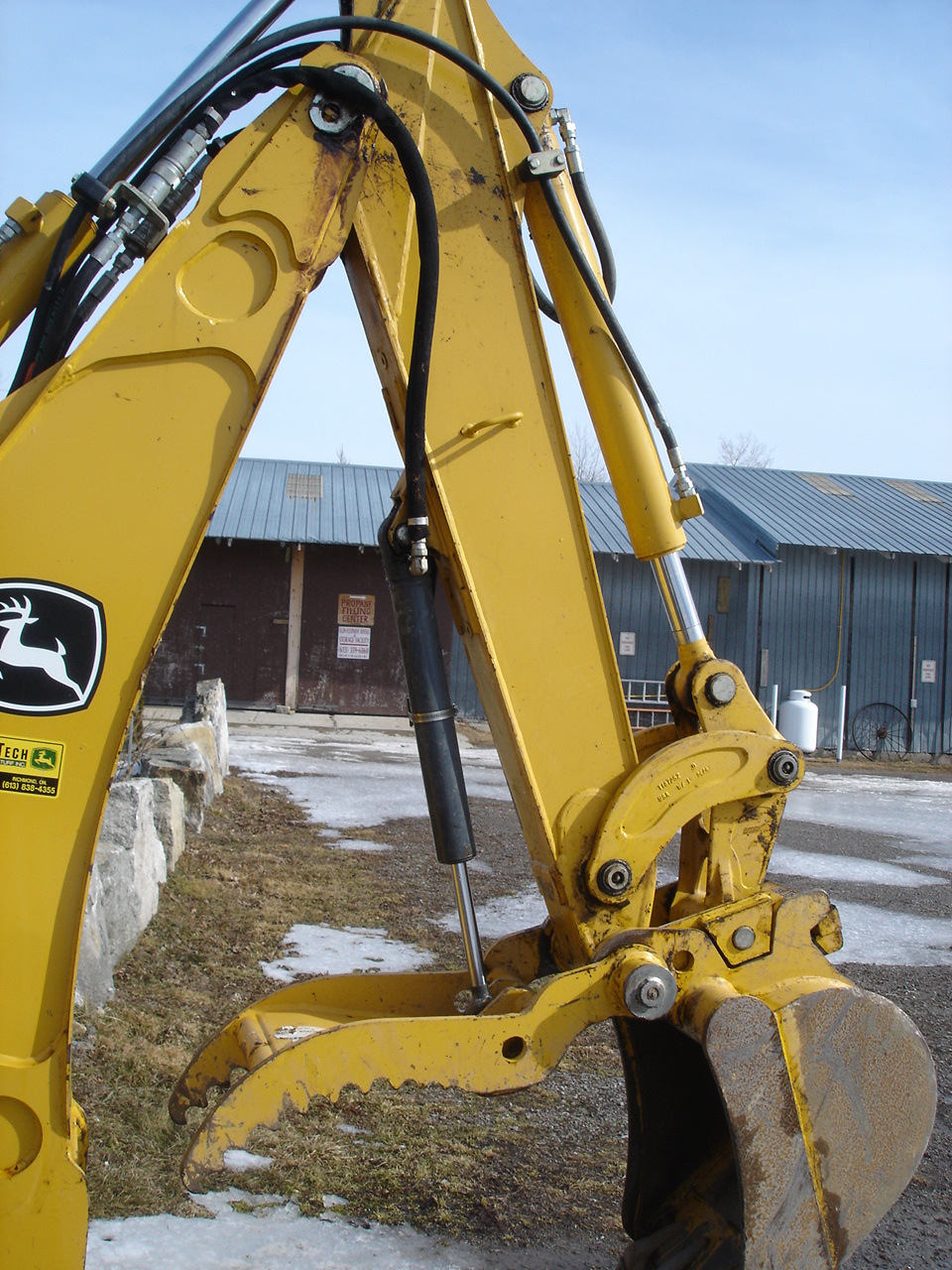

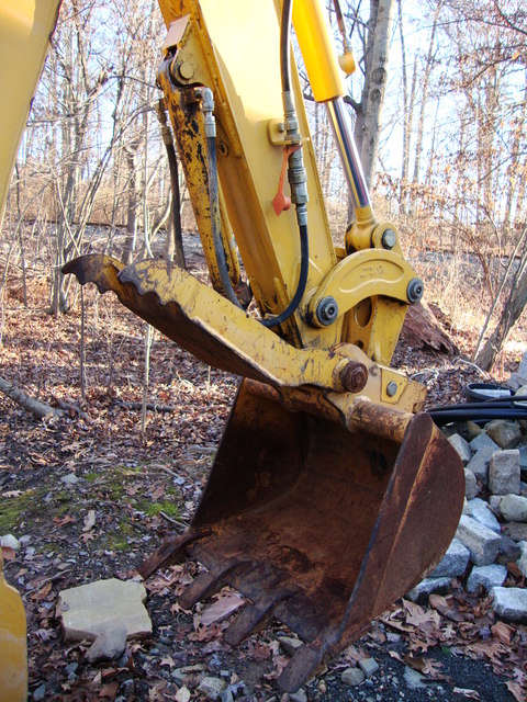

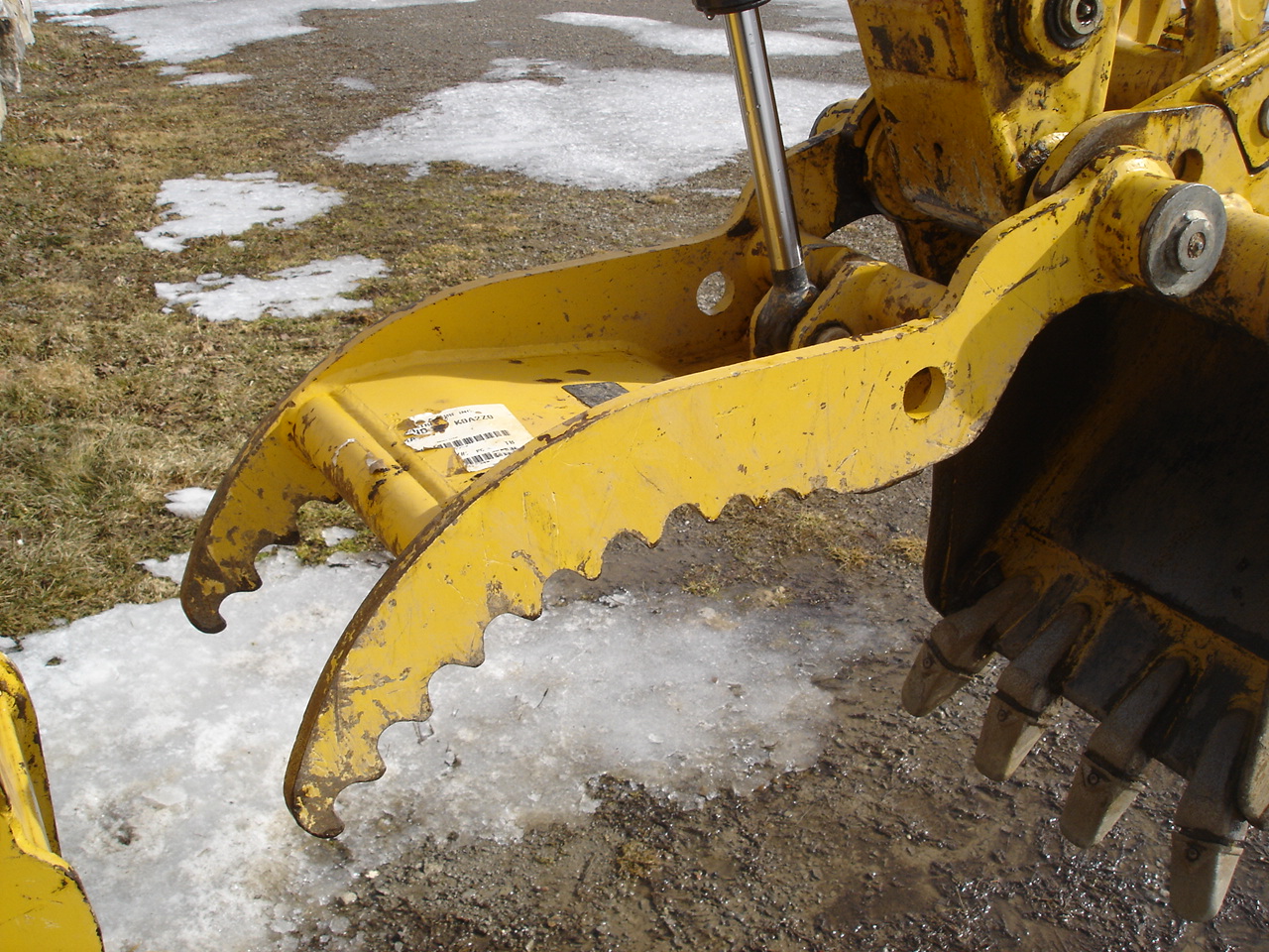

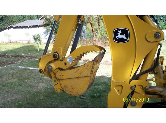

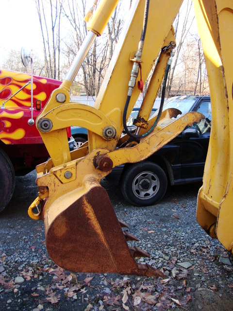

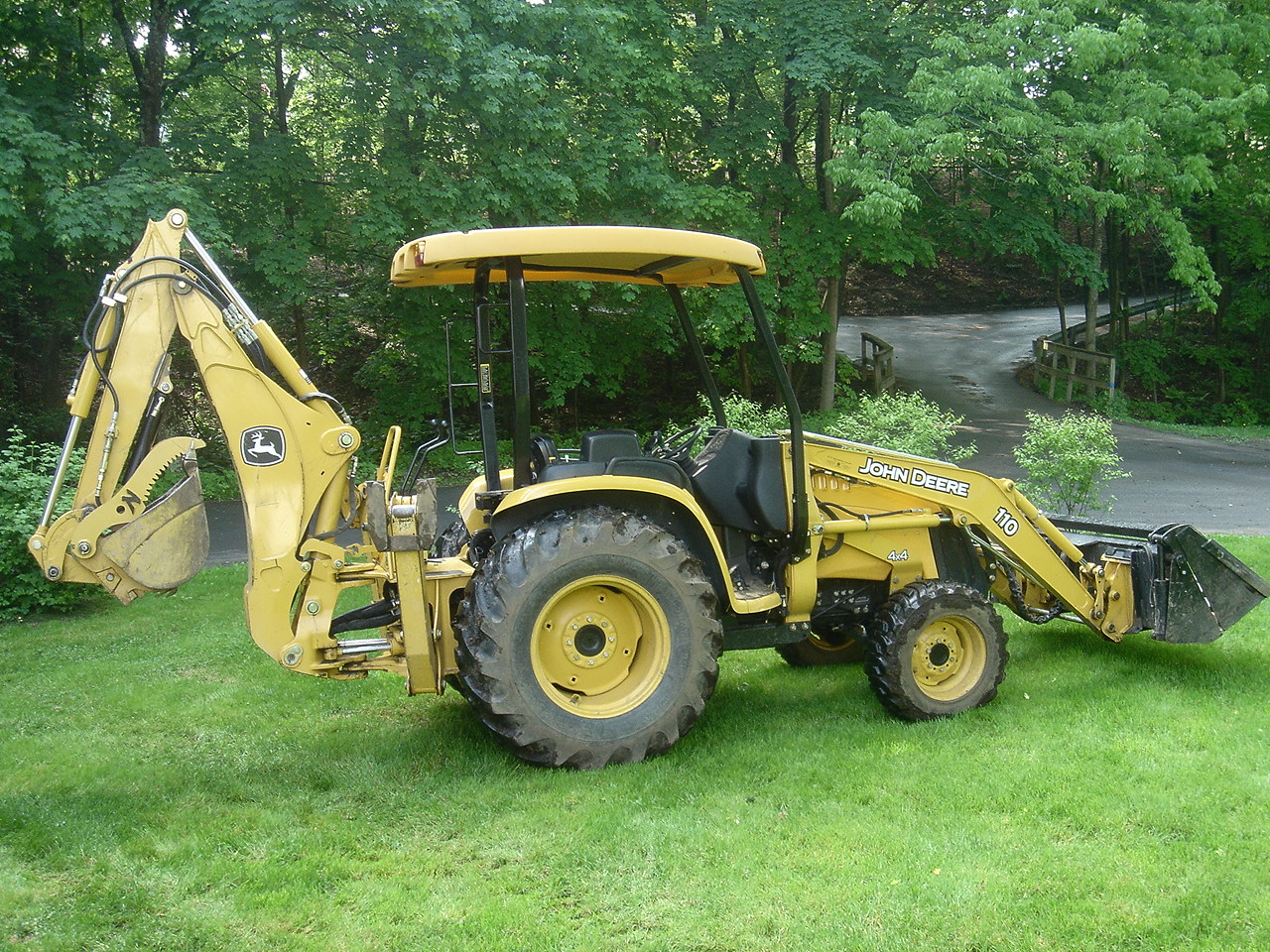

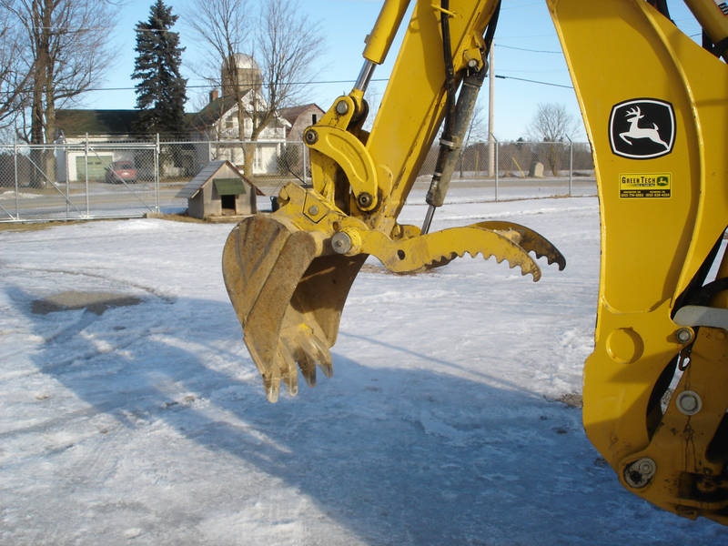

Here is a few photos that i had on file when i was looking for my 110 (stolen photos from web sites)
1.JPG14 Thumb - Clamp.jpg110.jpg110_thumb_001.jpg110_thumb_004.jpg110_thumb_007.jpg111.jpg106551104_6thumb_550x410.jpg0125070957a.jpgDSC04974.jpgJD_27ZTS_Thumb_010.jpgJD_35_ZTS_Thumb_001.jpgJD_35_ZTS_Thumb_003.jpgJD_35_ZTS_Thumb_104.jpgphoto (3).JPG

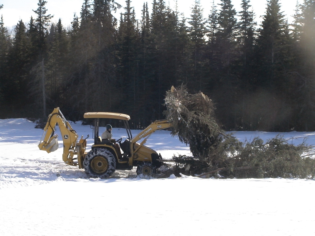

/ Increasing 110 tlb loader lift capacity #11
Clearing trees has always been the time when I'm most likely to have moments when the tractor can get "light in the @ss"! Generally, it's when I grab onto a pile and they're pretty long... quite a bit of lateral force on the loader and can make the tractor tippy. Try to center the load if the trees are big - and back off - when they're just too many big ones. Smaller bites...
Frozen stumps and root wads are "burn projects". Can take a couple of weeks to get them burned down to ash. Here's a pic of me tryin' to get the fire goin' again and adding another stump to the burn.
