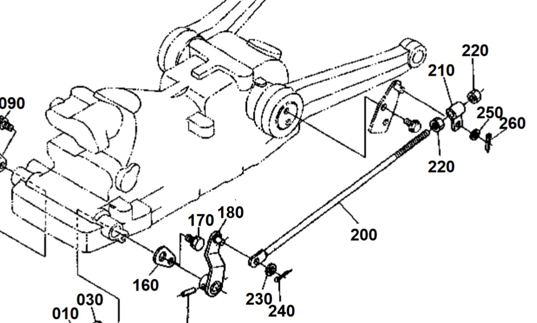

I have a Kubota L3400DT. If I pull the lever on my 3 pt all the way up you can hear the engine strain a little and also you can tell the hydraulic pump is having to work. I can push forward on the lever just 1/4-1/2” and the engine goes back to normal and then my front end loader starts functioning correctly.
Perfect!
I dont have that tractor, but, typical to L's is an external linkage, sensing position of the rocker shaft arms. This sensing element can be adjusted so that the 3ph does not dead head at its maximum height, but "automatically" stops just short of that position. Thats what we want to prevent the dead head power sapping condition you describe. The adjustment is quite sensitive and if you adjust it when the 3ph is unladen, crowding it toward MAX height capability, youre liable to get a surprise when you put a heavy implement on. The high lift force required introduces enuf flex that the sensor linkage doesnt quite relay the stop message. -- Its good to be alert to this condition.
You beat me to this suggestion as my L3130 does the same thing.
/ 3PT counter weight causing low hydraulic loader pressure? #14
Adjust #220, nut...
