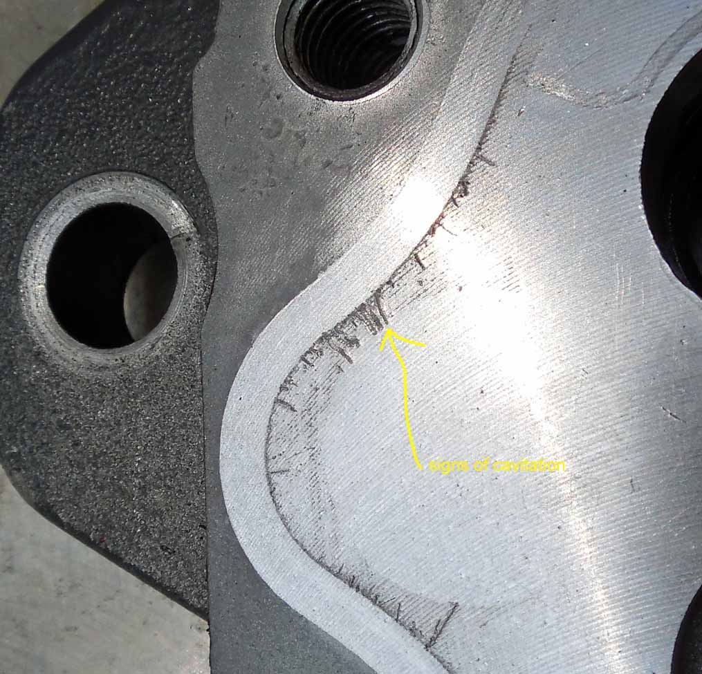

Both your original pump and the eBay pump are Cassappa brand?
Since you have taken your original apart, look at the seals and pressure chambers really closely to evaluate condition. Even if you have signs of cavitation, your pump may be rebuildable. When the outer O-rings get damaged, then no amount of tightening of the bolts will help.
I think I had a thread about rebuilding this pump.
